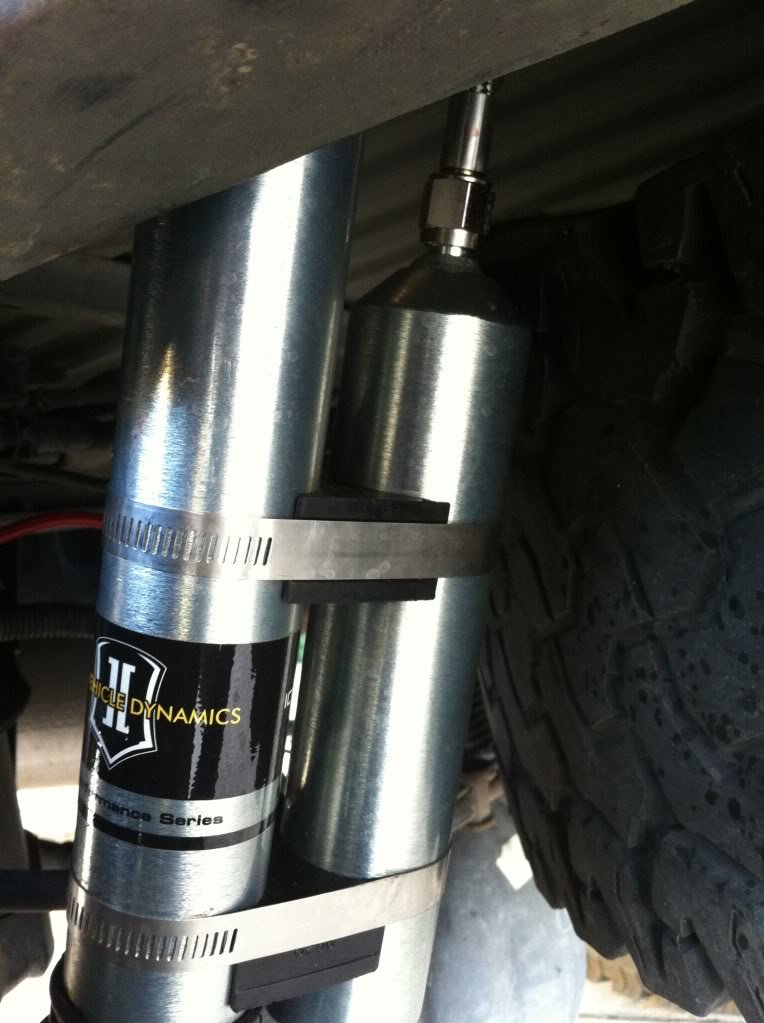

    Mine is a single shock with a resi for keeping it cool and stable. you can get a set like mine for around $400-$500 and thats all you need.

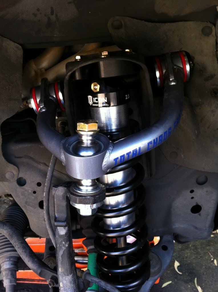

    Mind me asking how much those UCA's ran ya? How do you like them?

    $700 for the pair brand new from total chaos, but you can find them used for like $400-$500 sometimes. they are amazing and were required because I went extended travel coil overs.
    A bitch to install though.:frusty:

    Hmmm, I thought they would be a pretty good thing to have myself, just to compensate for the up travel I lost by getting coilover spacers.
