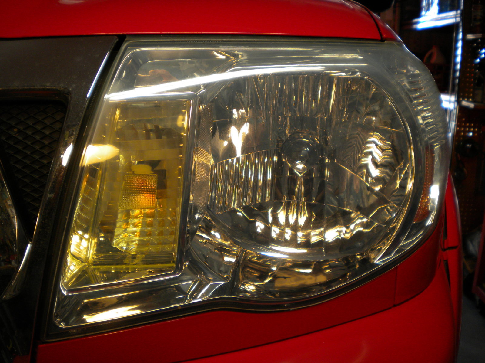

    Not sure... my 07 is a 4.OL V6. Forgot to mention they have XPEL UV protection headlight film... helps keep the lens from yellowing.
    This is the headlight's i removed after 16 years... had XPEL film installed when new (the film was thicker back then... real pita to install.) The lens were never polished or restored.

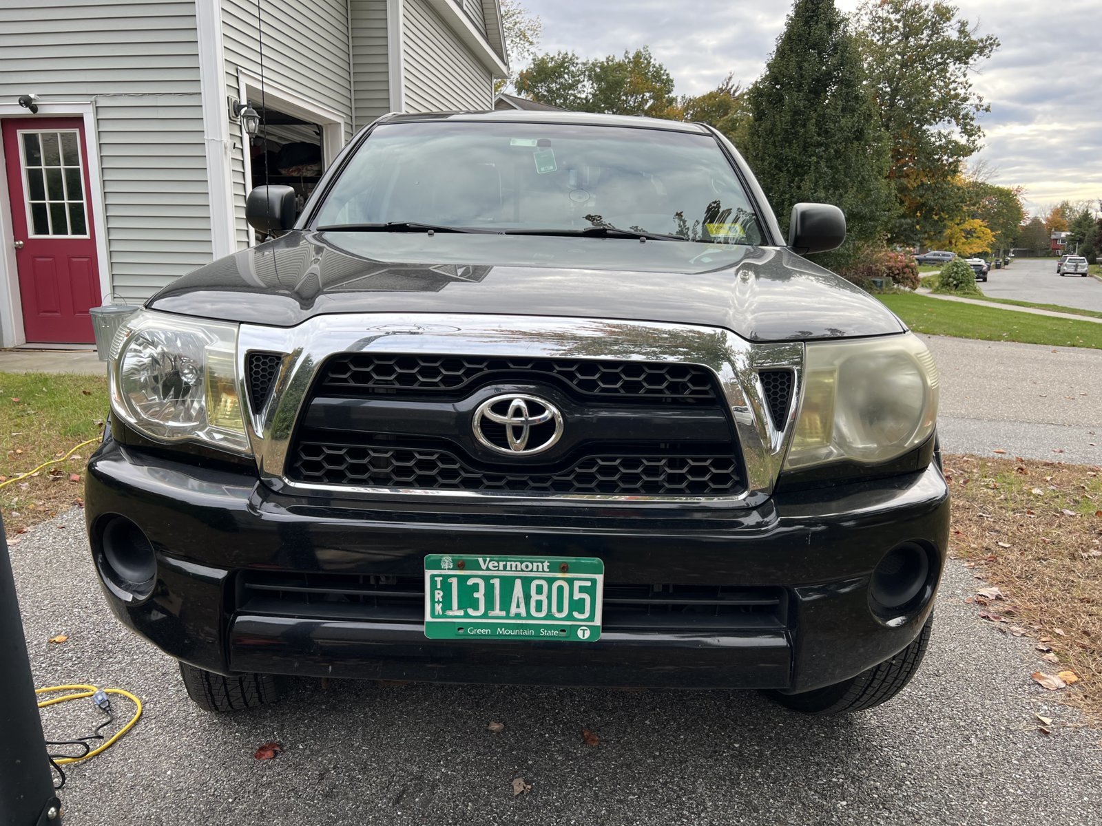

    So I took out both halogen bulbs today and they are crystal clear, no darkening of the glass whatsoever. Which is one of the key advantages of the halogens from what I read, that the tungsten will not evaporate on the glass enclosure. But even though the tungsten re-deposits onto the filament, it may not do this in a uniform manner, so that you end up having thin areas (likely to break) and thick areas (not much light output). I found this chart. Still, 80% brightness may not fully explain my dim headlight.
    So I am still thinking a total replacement may be worth it. I did the polishing thing ones and it didn't last long (admittedly, I did not clearcoat). Also, these microcracks that I am seeing in the plastic seem to be all through the material, not just on the surface. Cost will be around $400 for a pair of OEM lenses from what I see, about $170 each plus shipping and tax. My truck only has 60k miles and a almost new frame, so the investment might be worth it.

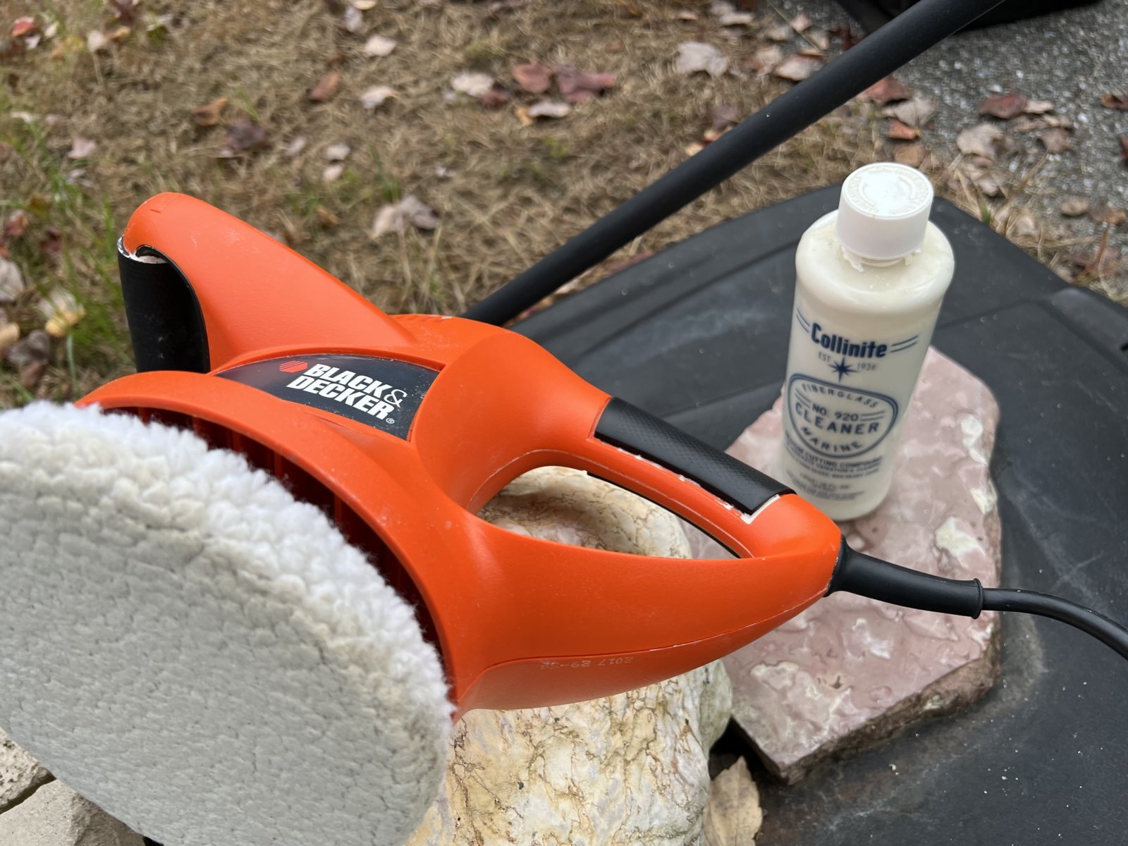

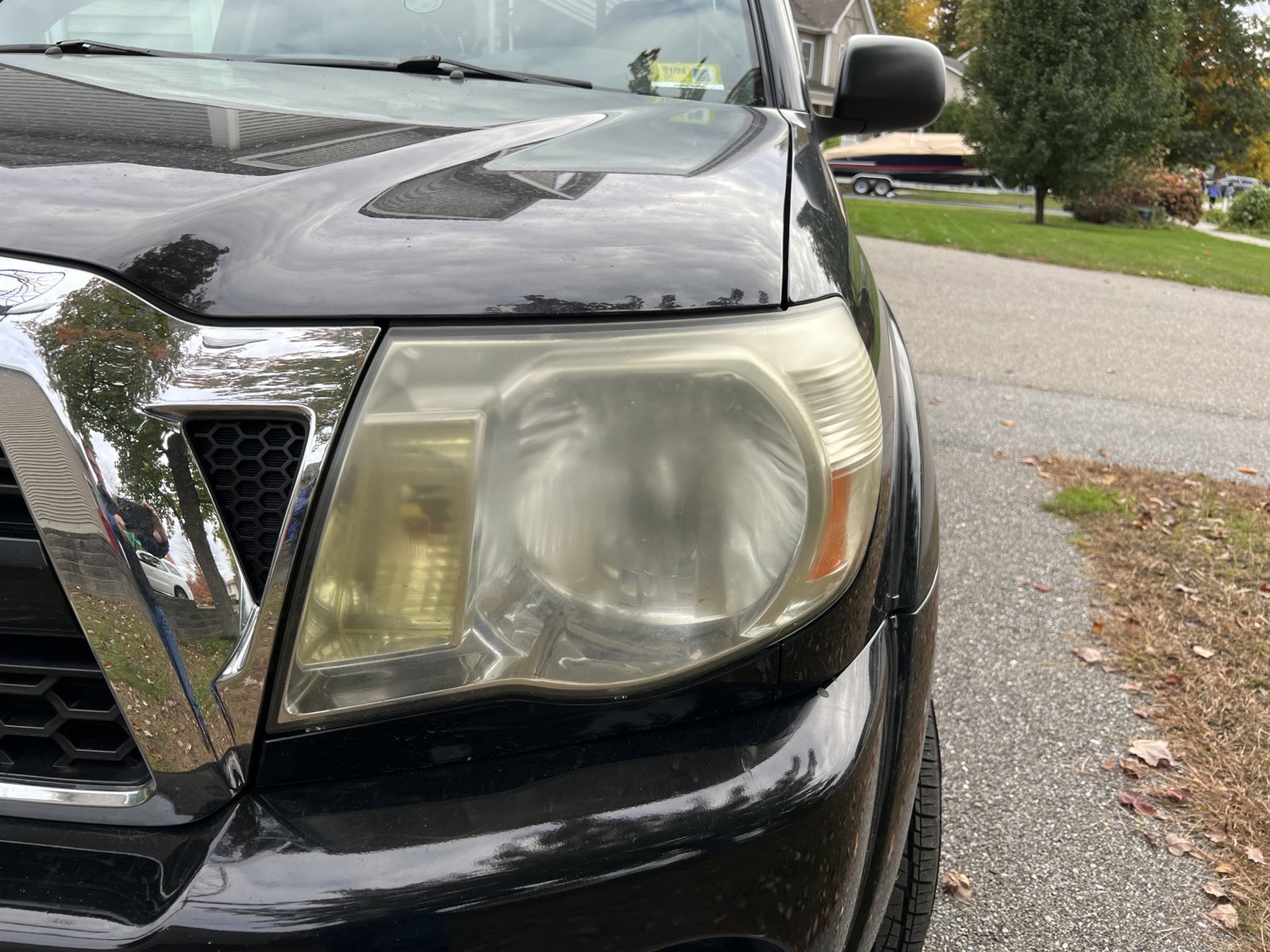

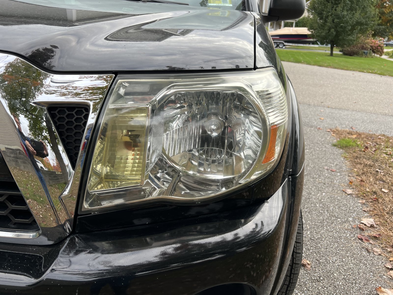

    Update: I looked at the lights in the daylight and while there some small cracks from old age most of the light loss seemed to be from the discoloration of the outside surface. So I took the polishing tool with some random boat cleaner I had kicking around, and went to town on the lights. I know this won’t last but it only took 15 minutes total including tool cleanup so I think I’ll safe $430 for now and go with this. Should I put wax or a clear coat on this to protect it?
    The passenger side polished, the driver’s side not yet:
    Before:
    After:

    Looks much better. You need to apply a clear coat that protects against UV, or use a UV stabilizing coating that can be applied as a maintenance item like a wax. The reason they don't last is sanding the outer layer removes the UV protective coat which rapidly accelerates UV breakdown. Putting another protective UV coating back on will prevent that. If the paint does not protect against UV, the applied coatings last typically 6 months to a year before wearing off, so you just need to remember to reapply, no different than waxing the truck.
