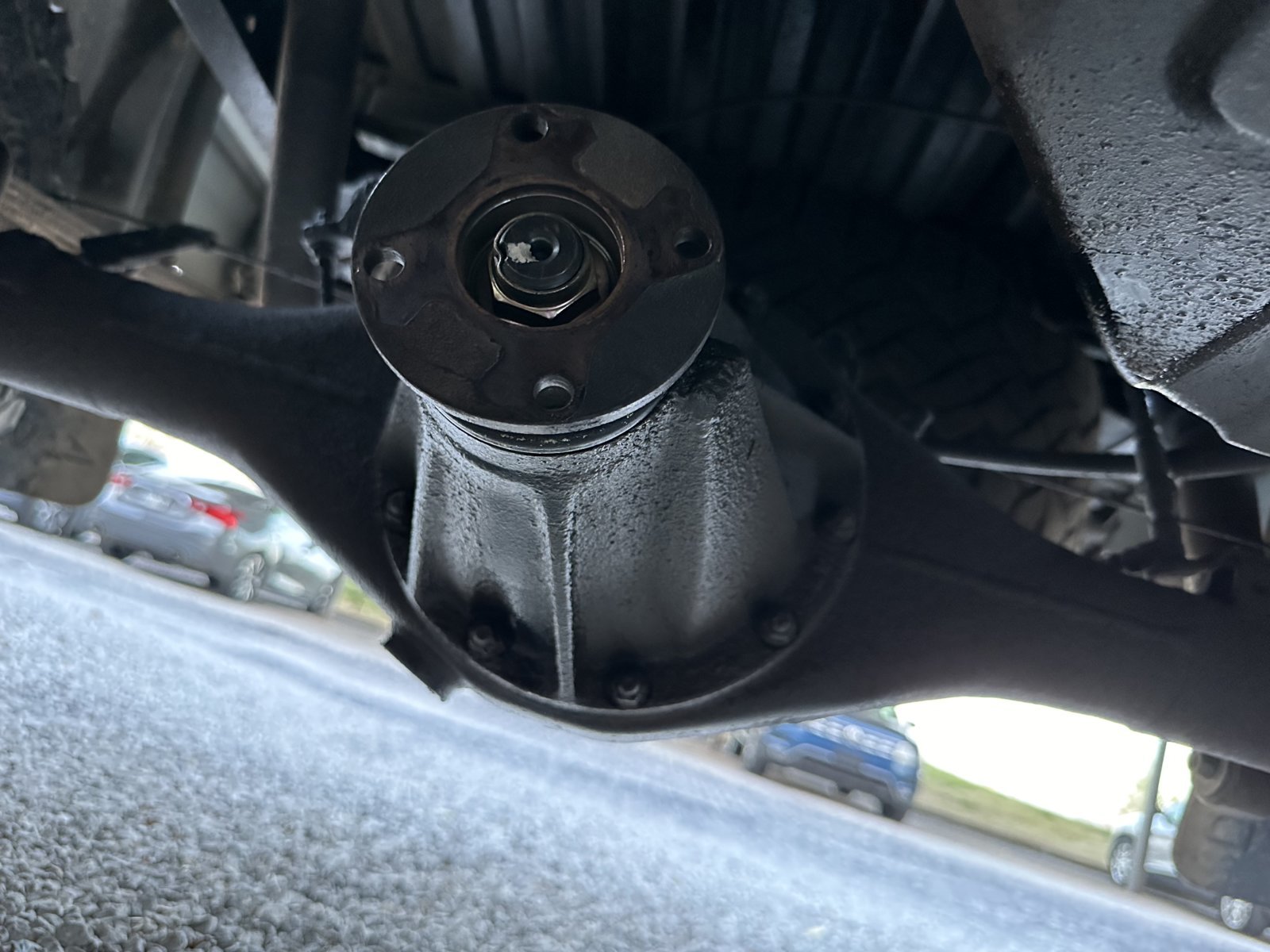

    I went to the driveshaft shop this morning and they quoted me around $800 to build me a new driveshaft - this would be made with U.S. made parts, presumably higher quality than whatever Cardone or Dorman uses. Adam’s out of Las Vegas might be able to get me something similar for slightly cheaper and with a lifetime warranty, but it would be nice to support a local business.
    I stopped by a local off road fab shop on my way home, and the guy actually said my rear pinion seal looked to be the worst leak on my truck. I actually didn’t realize how much gear oil it was slinging around everywhere.
    Apparently the third member has to be dropped to properly do this job, and at that point you might as well install new bearings, since they’re original AFAIK. He quoted $1400 for the job; does this sound reasonable?
    At that point I might as well install an Eaton locker while it’s apart.. Setting bearing pre-load is definitely NOT a DIY job, so if I’m having a shop do anything, it’d be this.
    Then again, I haven’t heard of the 8.4s deflecting much, so maybe it’d be going overboard a little?

    How did you get the truck there?
    Personally, I would go with what I outlined for the DS repair but whatever works for you. Your coin.
    For the rear, seriously? $1400? Just order a seal, free rental puller at local auto parts store or grab a cheap one on Amazon and just do it. It won't take long and no you don't need to "drop it". Attached is not for your year but if you're serious and want to give it a go I'll get you the actual doc for your year. WHY not save a ton of money? Again, your coin bro - your call. No need to ask for opinions.

    I drive it in 4h, so FWD. It was a little clunky and wonky, but it made it down the road ok.
    To your second point - the guy told me just drilling out the bolt and pressing in a new seal wasn’t the “right” way to do that job - in his opinion, the third member had to be dropped and new bearings installed.

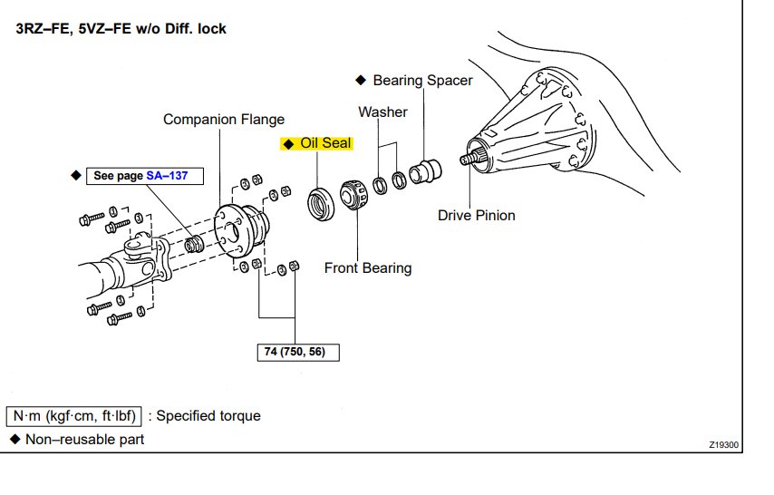

    Go look over the attached repair instructions from the factory to see how that front seal is replaced (yes, that is where it would be leaking). Don't see anything about the pumpkin being removed. You don't drill out a bolt. The flange nut is broken loose and replaced with a new one. I guess you could reuse it to save a few cents more but... ouch.
    Of course he wants to "replace your bearings". More labor, more time, more money for him.

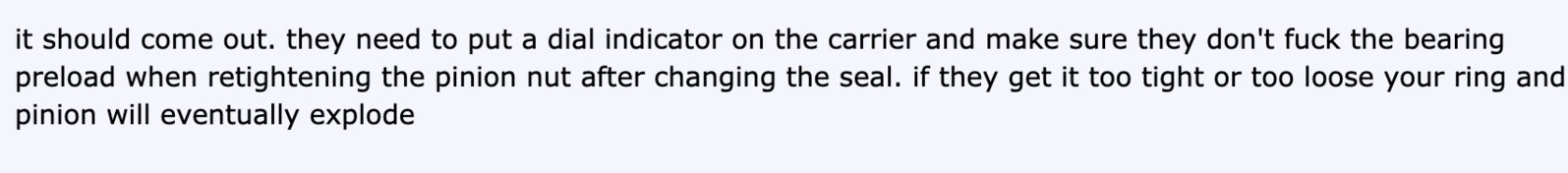

    The shop actually said you need to drop the third member to replace the pinion seal? And, that you have to set bearing pre-load?
    Lmfao! :rofl:
    You need to call the cops and charge him with attempted rape.

    That's a 14 dollar seal, and 5 dollar nut, and about an hour worth of work.
    No dropping the third
    No setting pre-load
    Lmfao, again... :rofl:... he said "the right way" :rofl:

    Did you not read what I quoted above? Here's a screenshot. This is basically what the guy was telling me this morning, but I wanted to make sure he wasn't just trying to upsell me. Anyway, based on the recent responses I think I'll just stop updating the thread.
