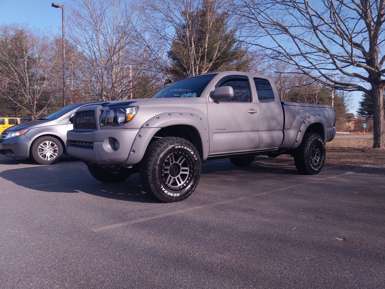

    Looks like Monstaliner?
    Did you spray or roller the body?
    Brush the jambs?
    Will you pull the topper and bed to do the back of cab / front of bed?
    Inside of bed with a contrasting color?
    Looking good.

    Yeah was monstaliner tinted with moderate quartz. Brushed the jambs, pulled the canopy and painted the whole thing right.

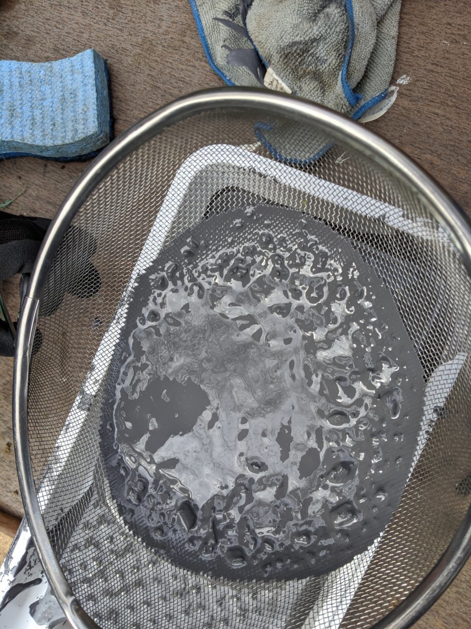

    Finally, although the first coat went on like a dream, my second coat of monstaliner had a bunch of chunks of shit in it and was so bad that I couldn't dissolve it with MEK or anything else I tried. Had to sieve it and even after that there was a bunch of gritty looking shit that got through and pretty frustrated with it. I've contacted monstaliner about this and have hears absolutely nothing back from them, which im hoping is just due to the current circumstances. anyway, just fyi their quality control seems iffy to me at this point.

    Did you mix a new batch for your second coat, or did you try using what you have left over from the first? It's possible, if you were using the same mixed batch, it could have started to flash off giving you the clumps. Have you tried sanding down the areas that have the chunks in it? You can touch it up once you get it smooth. Also, make sure to switch out the rollers often. Using light pressure helps in making the rollers last, but they will eventually start breaking down and leave chunks.

    Yeah so the way monstaliner works is you add a catalyst to the tintable paint and it causes the solution to harden over 6-10 hours. So if you space two coats out you have to mix two separate gallons which I did. Thus, this seems to be a quality control issue since the first coat went on like a dream.

    The second coat immediately after aggressive mixing

    That's weird...Mine didn't do that. Did you use a clean bucket to mix the second batch?

    Lol dude I did everything the exact same both times. Meticulously. I'm not here to troubleshoot this problem because it was obviously a bad second batch of paint. The only difference in my approach was the raw materials I used. Just want others to be aware that they may encounter this problem.

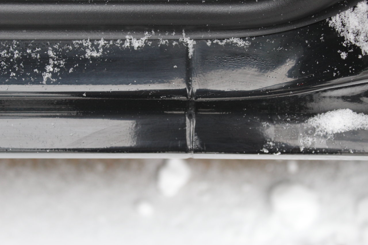

    I realize this is dated but was hoping you could tell me how this stuff brushes on. I’m assuming the rollers is what gives it the texture, could you post a pic of the door jambs? I just noticed rust coming through my paint in spots and this is my solution rather than a 3k + paintjob. Thanks

    Sure thing man can post some pics of the door jambs tomorrow. The kit of monstaliner comes with a roller applicator and disposable covers. I ordered two extra since I had a buddy helping me and i read that the covers breakdown with use. In my experience, the covers definitely broke down, so paying the extra 5-6 bucks for a few extras was well worth the money. In terms of brushing it on, I bought a handful of foam brushes from HD for cheap as well as a paintbrush that came in the monstaliner kit. You end up having to dab it on rather than brush it on, but it looks pretty good overall and not significantly different than the parts I used the roller on. There are some spots that are a bit sloppy inside the door jambs, but it's very hard to see and I after a while I ran out of gas lol.
