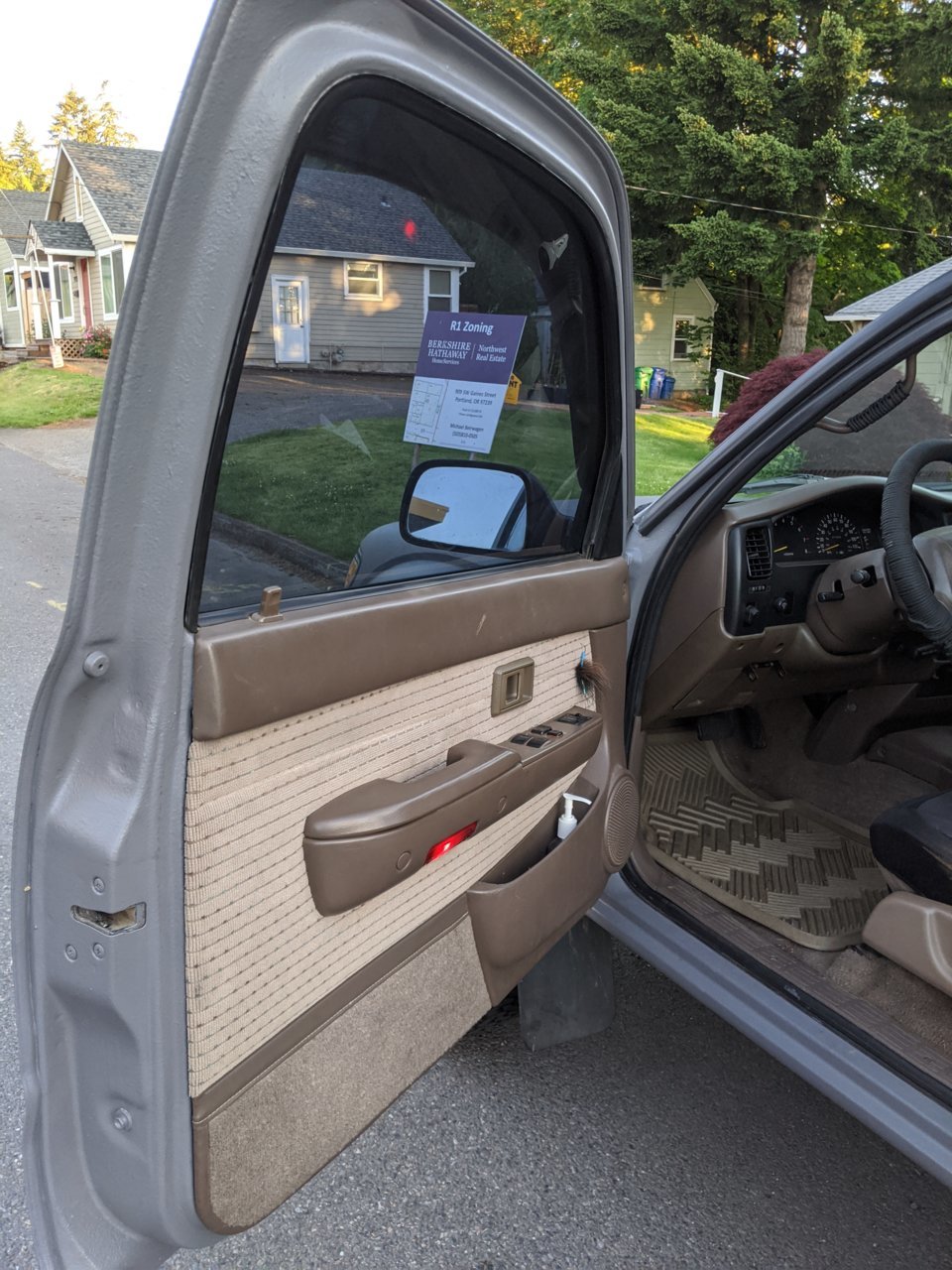

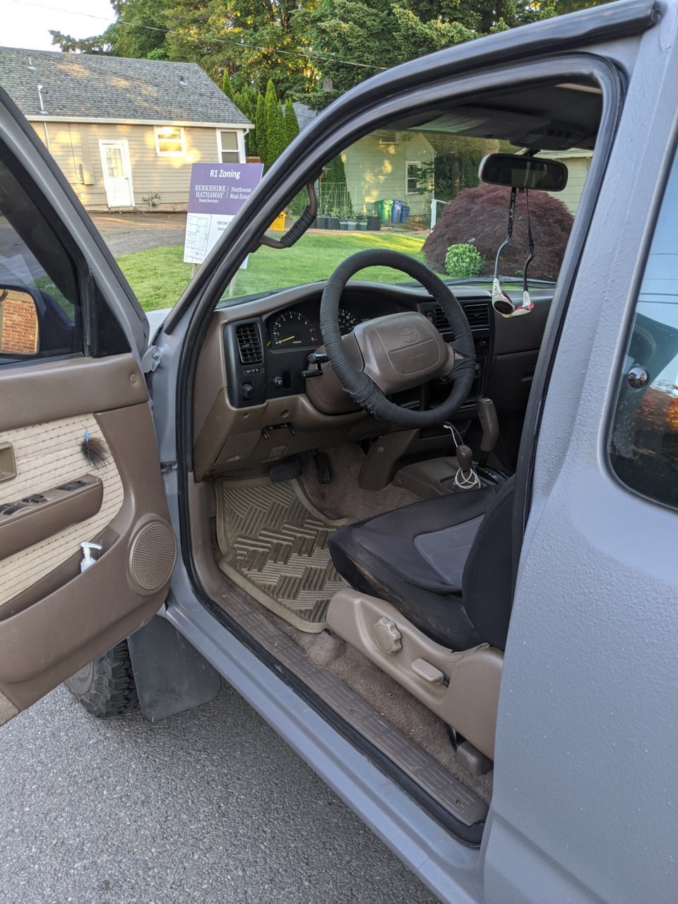

    nice! you have the tan oak SR5 interior, i have never seen that color, just the blue gray interior
    did you do this same covering to the mirrors?

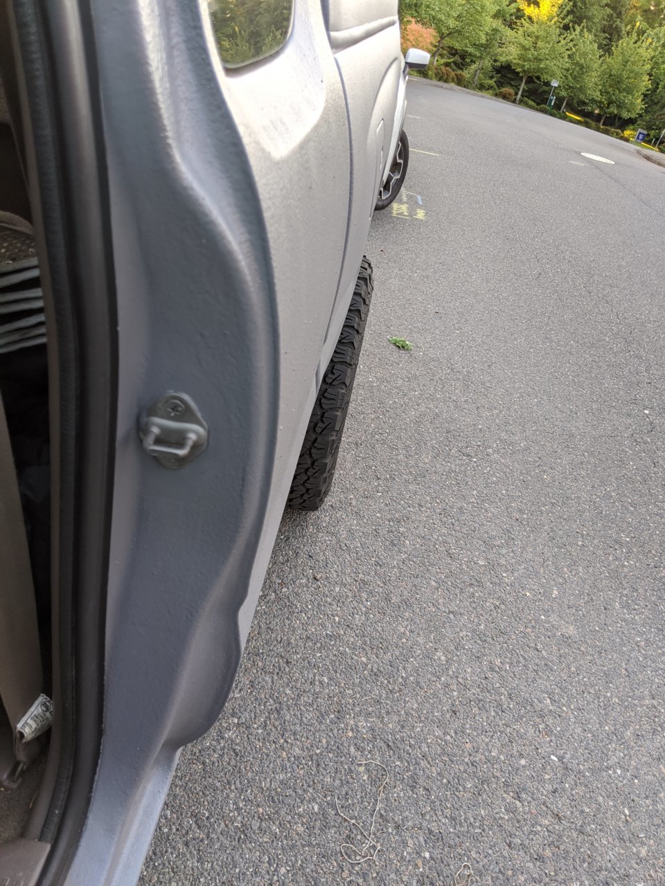

    You get 6-10 hours per gallon depending on the ambient temp and humidity. You can mix it in smaller volumes just using the same volumetric ratio of catalyst and tintable liner, but frankly I would do a gallon at a time to make sure it's as consistent as possible. Ie that the panels all come out the same tint. If you're going to do the door jambs, I would recruit a friend to help paint since it takes a long time and for a good quality job the jambs need attention.

    Thanks- I love the paneling and interior- along with the sun roof it seems to be one of the more unique aspects of the truck. I plastidipped the mirrors since I hate chrome- not sure I'd like the look of bedlined mirrors with the way they articulate on the truck.
