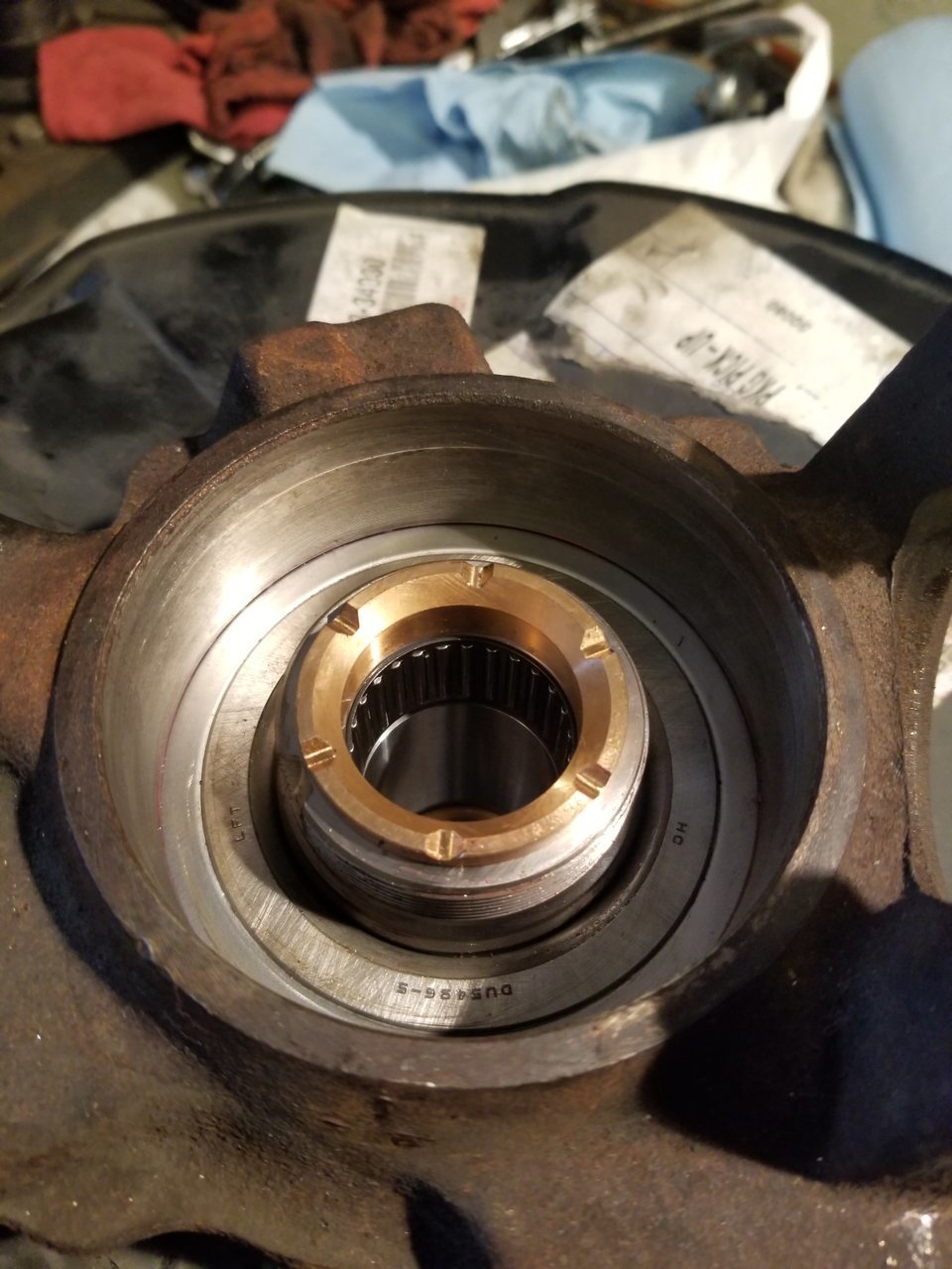

    PLZ DO NOT GET Aftermarket. I got some for mine and they destroyed my hubs. The clearances weren't perfect it seems. Ended up rebuilding my OEM ones and had to get new hubs, bearings, etc....

    I don't have an axle nut on mine. Manual locking hubs have a shim and Snap ring. This was both sides and bearings were fine. The brass bushings in the hub got destroyed so need to replace hub as they are non replaceable. New bearings because to replace hubs you destroy your bearings. I know what you are talking about though

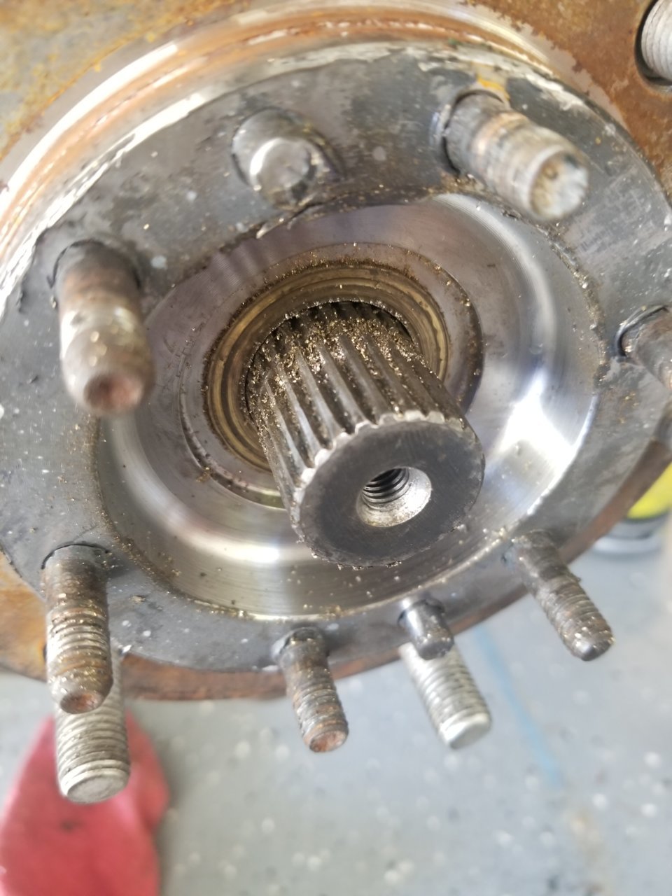

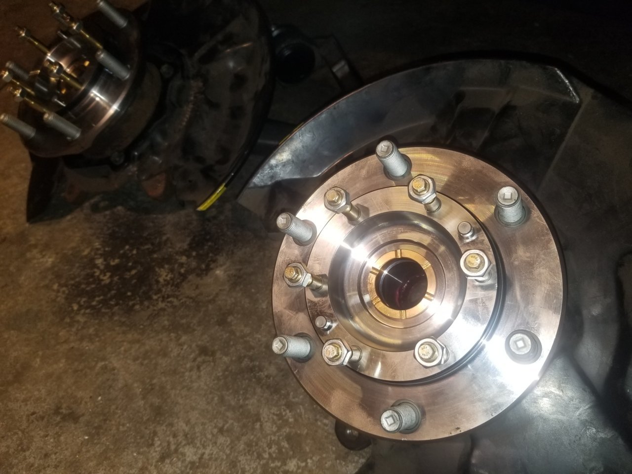

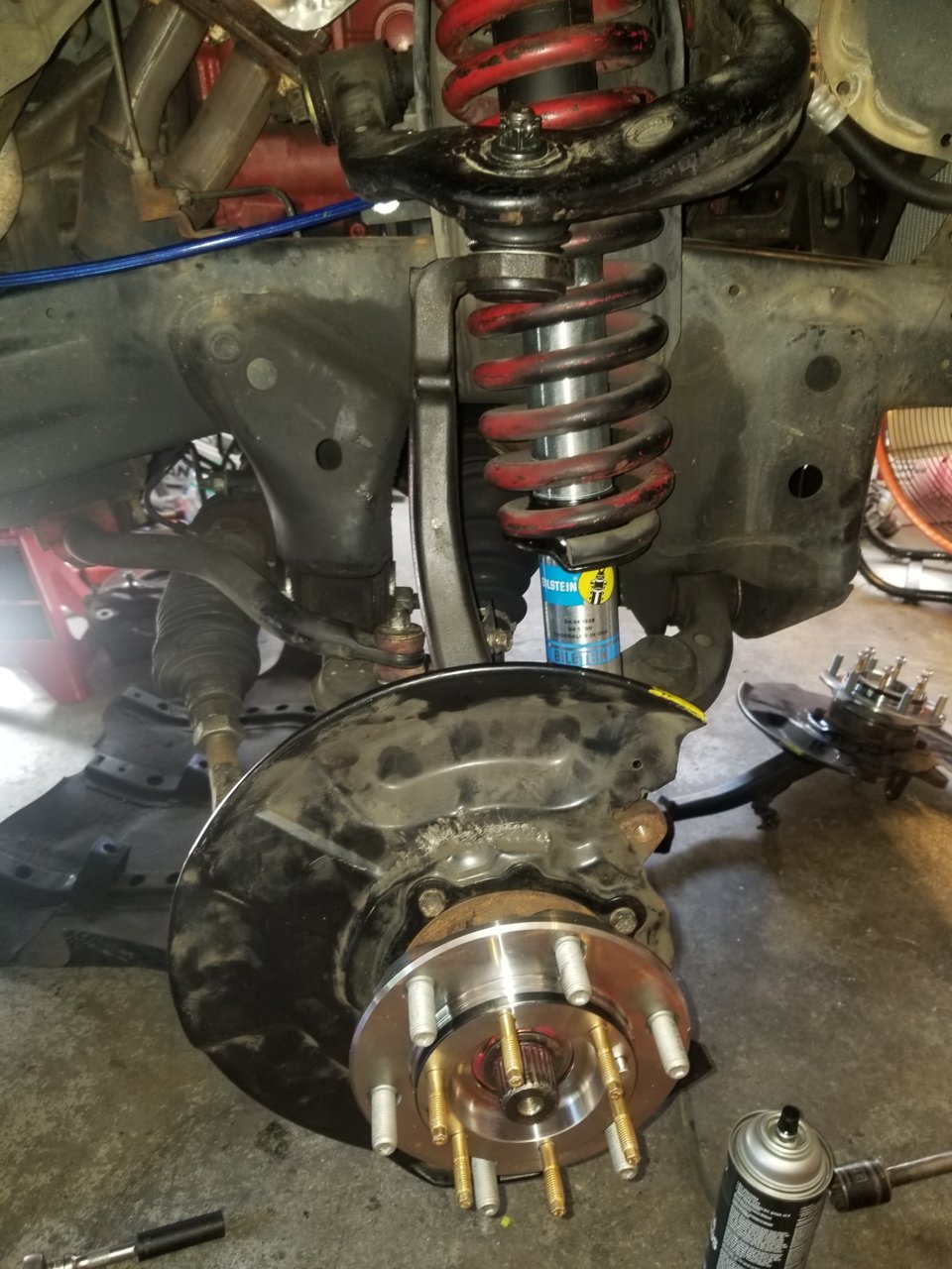

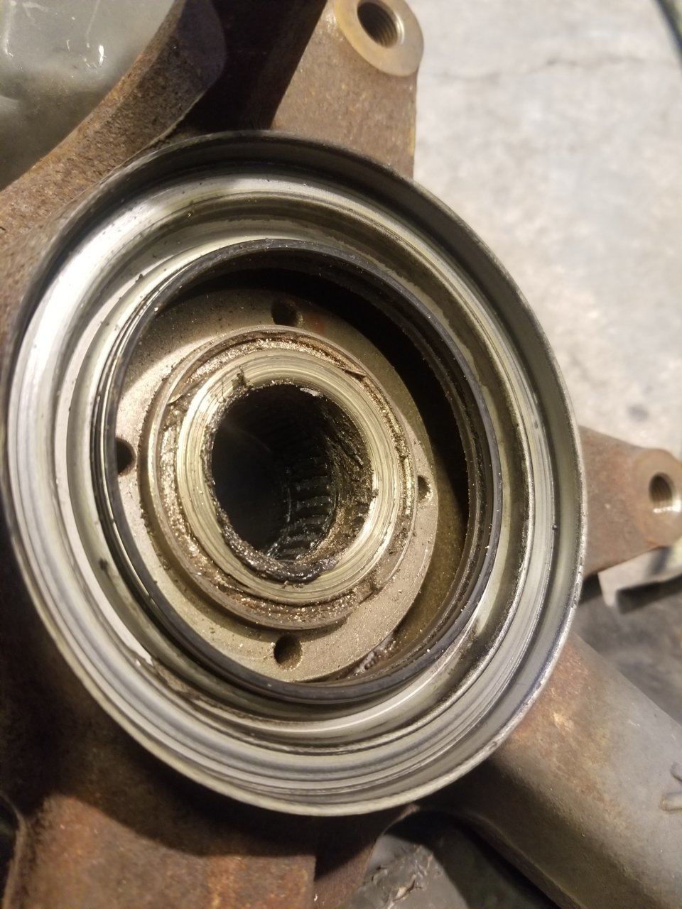

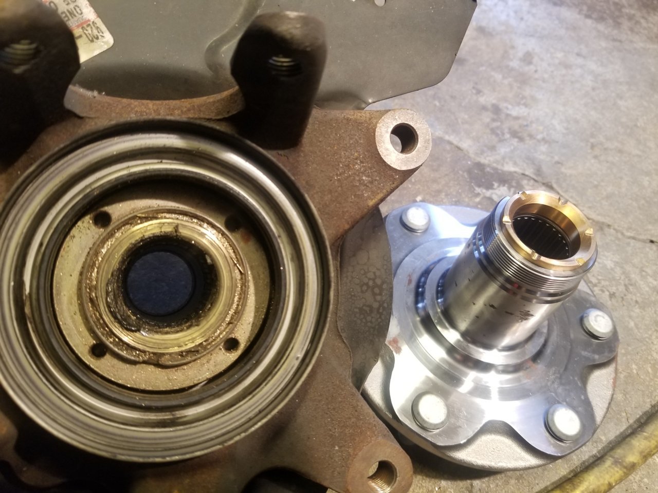

    Shaft OD with the splines of the aftermarket CV was a bit off so created too much pressure on the bearings inside the hub itself. This caused every time you go forward the axle to try and pull out of the hub as if you were unscrewing it out which created a lot of pressure on the brass bushing on the front of the hub destroying it. Going in reverse did the opposite effect and screwed the CV back in to the hub (yes I know there are no threads it just pushes the cv in to the hub with the rotational motion due to too tight of clearances) and destroyed the inside bushing of the hub.
    The only way I figured out this happened was because I noticed my 6 month old aftermarket CV boot on driver side was torn....So decided to see why it wasn't spinning freely. Took the locking hub apart and just brass came out and the CV was not spinning freely. Same thing on both sides.
    Took my old CVs and rebuilt them.
    Installed new hubs and bearings.
    Smooth as butter. Only difference was that I used OEM CVs. That's why I dont recommend aftermarket CV's....Not to mention they are actually skinnier and weaker.
    You can't really Fk up the manual locking hubs install. Like....seriously....put it back the way you took it off. It's pretty much brainless. Definitely was the parts.
    It was Carquest Advance Auto CVs if anyone is wondering.
    Kwikvette[QUOTED] likes this.

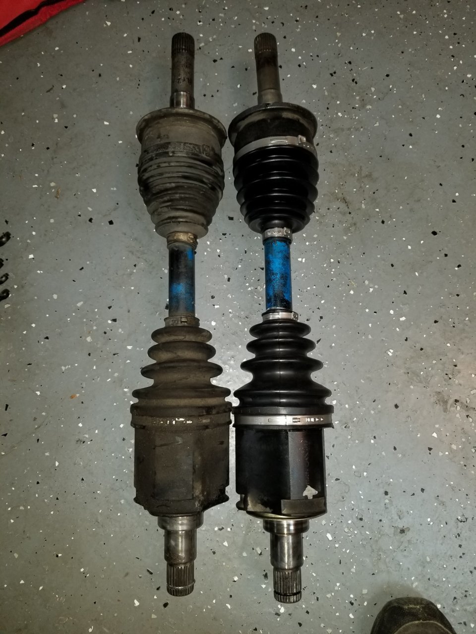

    Here are some pics for reference

    The splines on that axle did not look good :eek:
    Russianman92[QUOTED] likes this.
  18. Jan 25, 2021 at 10:29 AM
    #38
    Russianman92
    Russianman92 Well-Known Member
    Sep 15, 2014
    #138340
    825
    Dunwoody GA
    1995 White Tacoma 3RZ 4x4 5 speed
    bilstein shocks/struts Add-a-leaf Mostly stock. Running 31x10.5 r15
    That's the aftermarket garbage I had in there. Believe it or not, the splines were fine. That's just caked up brass in there.

    (These are OEM in picture just showing location for reference)
    The part circled on the aftermarket CV where it rides on a roller bearing inside the hub was too big by maybe a 1000th or something which caused it to act almost like threads. Creating pressure either on the outside or inside bushing depending on direction of rotation. Destroying the bushings.
