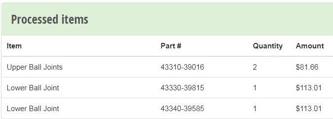

    Related inquiry, do I really need to get new bolts for the LBJs? They aren't torqued that high, and mine have no rust. Was going to just clean them good with brake cleaner and apply some blue loctite once they are dry.

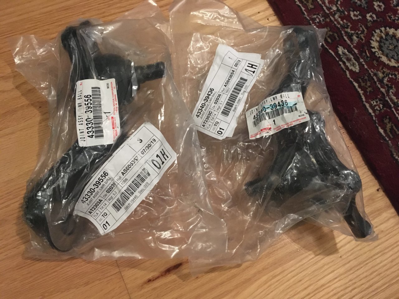

    I just bought a set last week and the OEM bag came with the nuts, bolts, pin and castle nut.
    This is something new coming with all the parts.
    They never used too, you had to buy all the parts separately.
    It says to replace the bolts!
    I’ve seen plenty that were busted for some reason So why take a chance unless you gamble.

    bought mine from Camelback Toyota, included nut and pin but no bolts

    Yeah dude, Camelback Toyota. As in, Toyota dealer. When have you known a dealership to sell aftermarket parts?

    Mine are new Toyota parts sealed in bags but yeah, no bolts.
    Local Toyota dealer has bolts for $24 for all 8 bolts.
    The bolts are not listed as single use in the service manual FYI.

    Correct. My order from camelback did not include bolts. There are no bolts in my order. I did not receive any bolts in my delivery. No bolts arrived with my lower ball joints.
  19. Sep 29, 2019 at 7:09 AM
    #39
