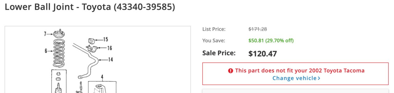

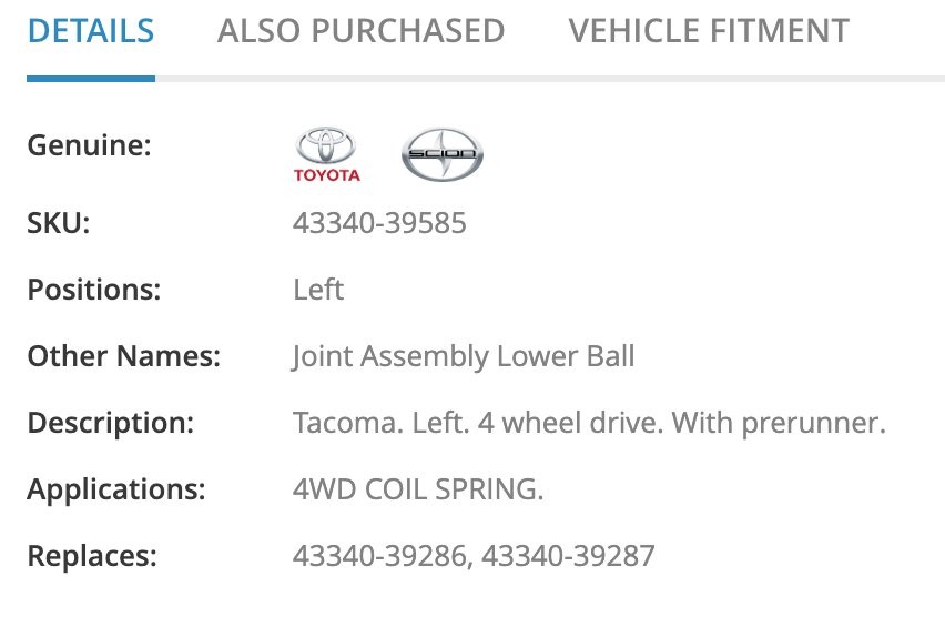

    That part number doesn't come up as compatible on Camelback Toyota's parts site when I enter my VIN, so I didn't order those. Mine were $96 and $120 each, plus shipping, no tax. The 2WD versions would only be $61 and $76 each, but obviously those wouldn't work for my application.
    I have an '02 TRD 4x4 3.4L ExtCab SR5 Automatic
    It's odd because it does say your part 39585 is indeed for 4WD, but what it actually says is "4WD w/Prerunner" which makes no sense to me because I was always told Prerunner means 2WD.
    Long story short, it seems likely that this parts site is screwy and that part could actually work for me. Who knows. I was/am just trying to stick with what the Toyota dealer's site says I should use when I enter my actual VIN.

    It does get confusing. There are 2WD Tacoma - 5 Lug that use less expensive ball joints. Then there are 2WD Tacoma PreRunners - 6 Lug that use 4WD components.
    The PreRunners share many of the 4WD components -- except they don't have 4WD.
    When I'm at a parts store where they don't distinguish PreRunner I often say 4WD to keep from getting parts for a 2WD 5 lug that will not work.

    I knew that Preunner/4WD both use the 6-lug, etc. I just didn't know there were Prerunners that have 4WD. Which there actually probably aren't--it's just that their website has weird wording "4 wheel drive. With Prerunner."

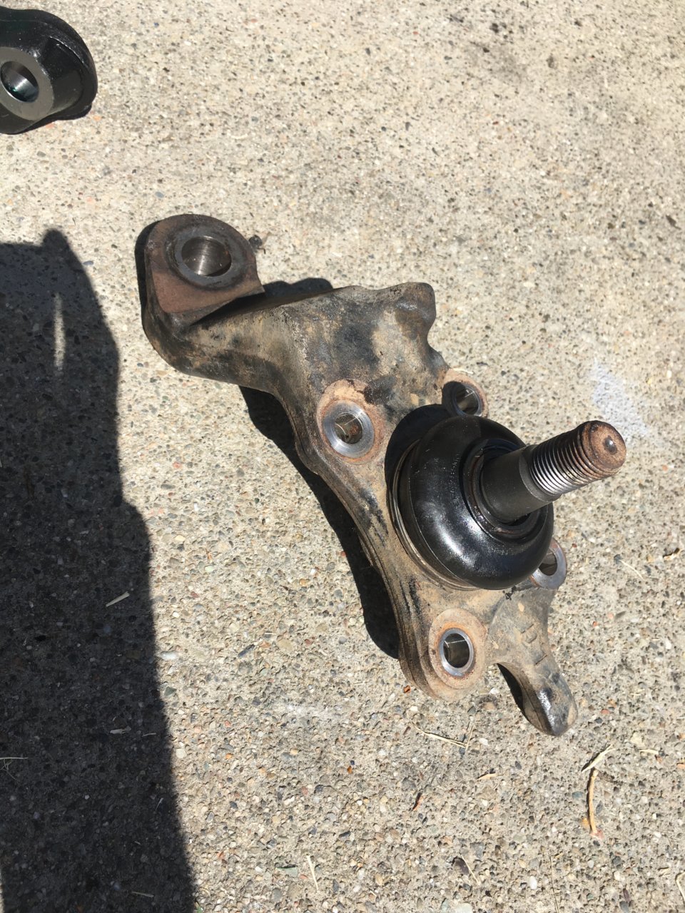

    Judging by your first pic. what happened was the rubber seal rotted from age same as mine did.
    When I changed mine I cut open the ball and it was pristine at 150K miles and 15 yrs. but needed new rubber, couldn't really tell that from outside observation though.
    I've sometimes wondered if ALL the failures resulted from torn outer seals contaminating the ball with dirt. For factory parts anyway. From looking at the parts store ones they're diff. steel.

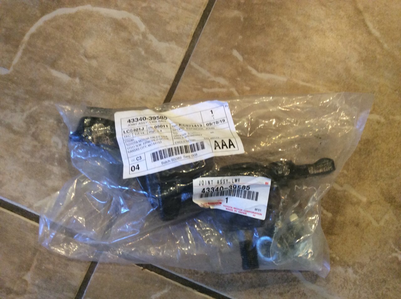

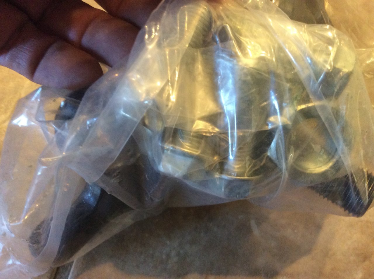

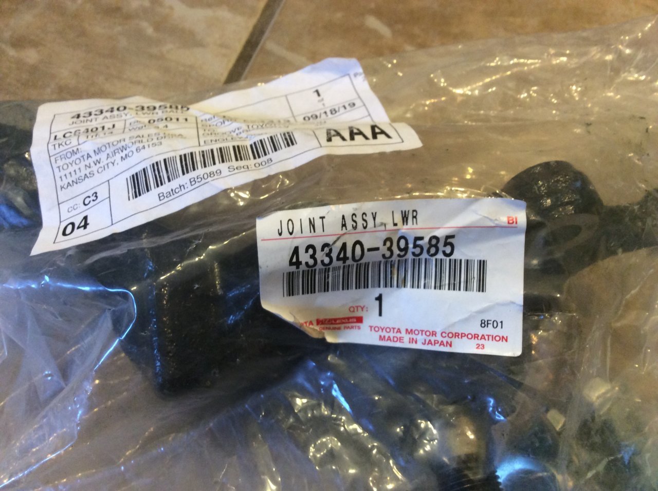

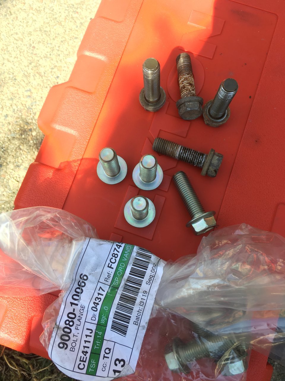

    I have all the service records for my truck. 2nd owner. LBJ were already changed long ago per the campaign.
    I did mine today. Piece of cake.
    C79E3255-0D65-4AFA-AEF9-A1DDFC7DBBBE.jpg 24E92B67-7887-4749-9831-6FE1E44F82B1.jpg
    Old ones were fine. No noticeable slop/play. Bolts were looking pretty nasty though, glad I bought new ones from the dealership.
