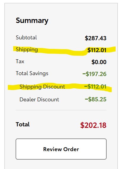

    I got free shipping on an order of over $100. I just checked by entering a dummy order. Free shipping for orders over $100 still applies.

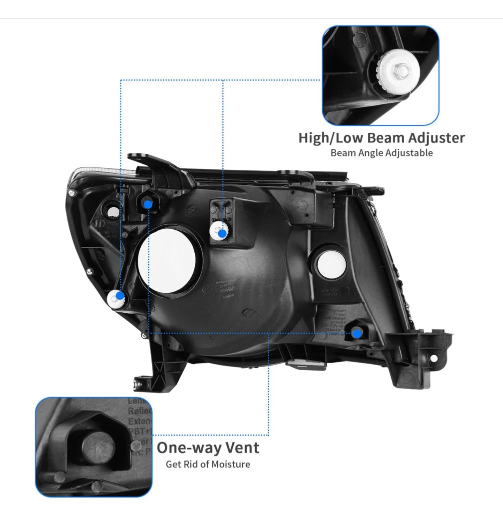

    I bought a 2008 Tacoma last month and the dealer had replaced the headlights with an unknown brand. They are adequate for now since I raised the driver's side beam up a couple of turns. I adjusted the horizontal adjuster 1 turn and it didn't do anything so I put it back. I think the horizontal adjuster is just about useless, from what I've read. How were your lights adjusted right out of the box?

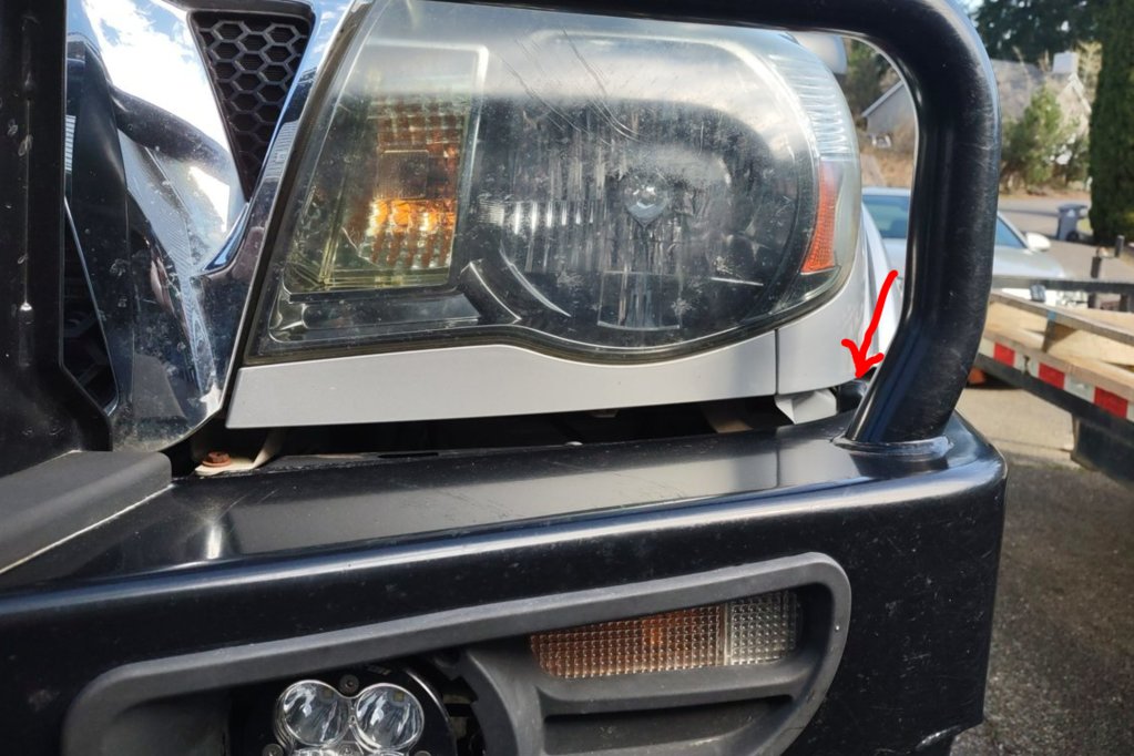

    Everything I read, said on a stock tacoma the headlight housing mount where the arrow is (on both sides of truck) is a horrible thing to get to up behind the bumper. With the ARB on my 2nd gen (2011), you can see it, and just slide a wrench up underneath the bumper. Super easy.

    Apparently the function of the upper adjuster (high beam aim) has been changed from OEM (horizontal aim). Maybe that's why it didn't seem to affect the horizontal aiming when I was turning it!

    I've got that gap too so I'm hoping (and praying, LOL) that I don't have to drop the bumper forward (I saw one video where the person disconnected the top bolts and let it pivot forward) or remove it since I'll probably be working by myself and that SOB is heavy, especially with the Warn in it. :censored: I really need to make friends with some local Tacoma people since the folks I grew up working on vehicles with are all getting older and beat up- including me.

    If you have a floor jack it might a good idea to put that underneath it with a 2 x 4 or something in the center to lift in back into position to hold where you need it so you can tighten it back up?

    Re: that lower outside mounting point for the headlight housing, I was able to reach that screw by loosening part of the fender liner in the wheel well and reaching up from the fender with a 10mm socket on a 1/4" ratchet. That was the most difficult part of the installation.
