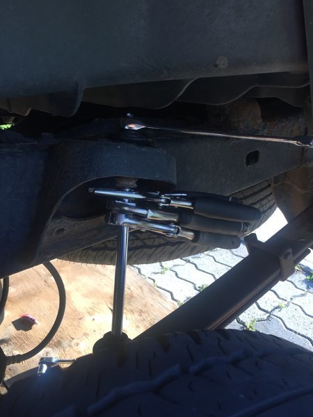

    further to my post 7 , the shocks feel more or less the same as the 2012 shocks i put on last time.
    neither of my top nuts would spin off while holding the top with a vice grip (i did not have a 5mm wrench). both were completly seized.
    i used a propane torch and got them so hot the rubber bushing ignited. whoops.
    the only way for me to do it was as shown in the attached picture. and even then i had to work the nut off similar to if i was cutting threads with a die! little forward, little back, little fwd, little back. all the while putting penetrating oil on.
    one of my cheap arse vice grips wouldnt hold it. i had to use 3!
