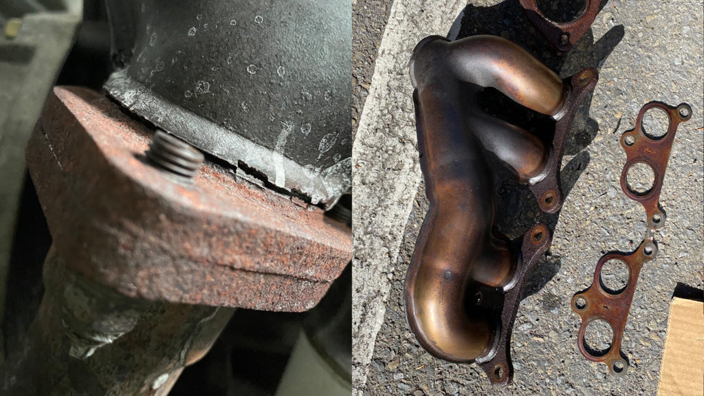

    Po505 I can’t get the damn header bolts of to fix the exhaust issues and now there are two more damn codes it runs extremely loud and I’m just about to my breaking point

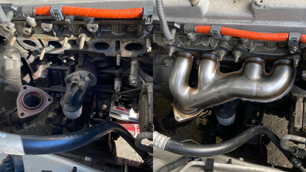

    Its easy once you get the nuts off. My issue was a cracked manifold where the pipe and flange meet. Replace with all new OEM gasket and hardware. You will need an exta long extension (or two put together) to get to the manifold/cat bolts.
