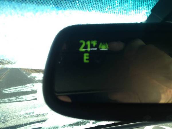

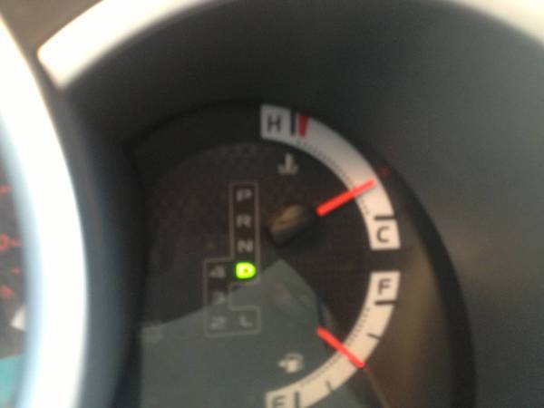

    ABQ New Mexico
    2012 Offroad
    TRD cat back exhaust, console vault(for my little friend),Pop and Lock, Bak Flip G2, Weather Tech window covers, LED inside and out, DTRL Anytime, Grillcraft Grill, BAMF Light Bar with Hella 500s and Blitzpro 15D, Eibach with 5100's all around set at .85 and top plate spacers, LR UCA's, toytec 2" add a leaf, Duratrack 285 75 16, ABS kill switch, Aux reverse lights, Blue Sea Aux fuse block, ImMrYo Bracket, LED Bedlights, Ultra Gauge,
    Thought I would add results to Chris's test, New Mexico style.
    Out side temp. (I know this is not cold to Oz)
    Driving normal for New Mexico....:D
    4 minutes 05 seconds later, no heater on. Not sure of the temp, but this is about the normal operating temperature.

    I removed your pic of excessive speeding. Thats not allowed. As for the gauge, the gauge hits the "Normal" range at 130*, and doesnt move from its spot until it goes over 212*. Its not that accurate. All my results were done using an Ultra gauge.
