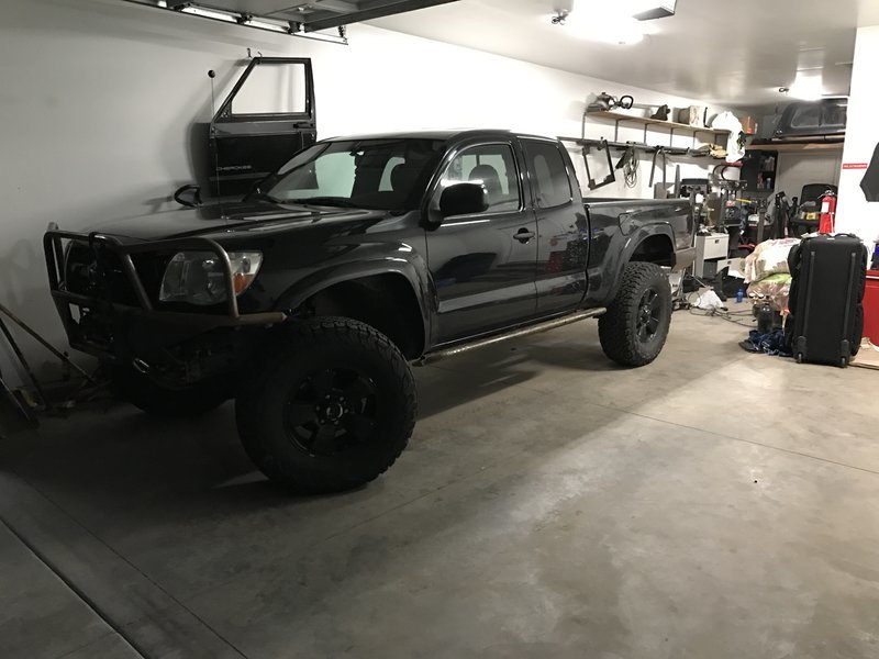

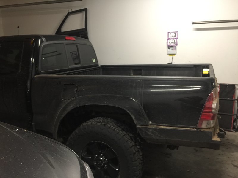

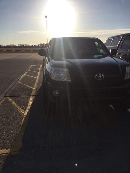

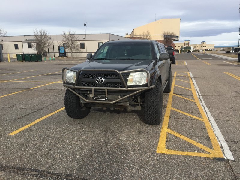

    Finished my cab mount chop. Also painted my grill black.

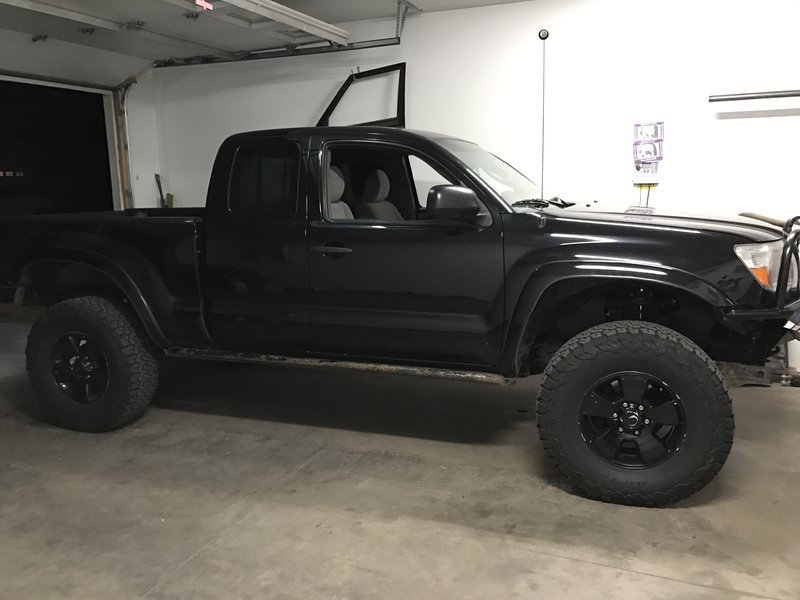

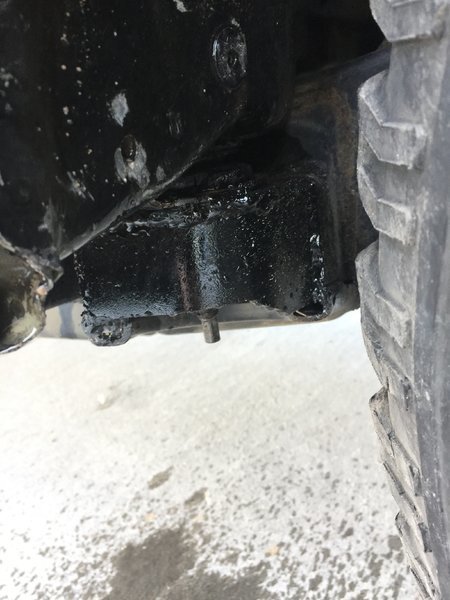

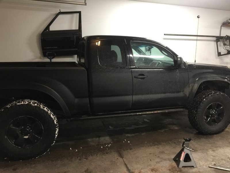

    Spent some time with a bfh this morning before work.

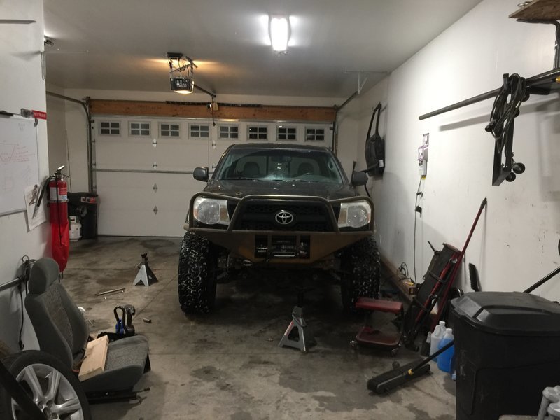

    Hopefully this will be enough room for the 35s, otherwise not sure how much more I can push it in before I cut and tub.
    Also took adavantage of weekend sales and bought a winch. Xrc9.5 with synthetic line for $360.... I bought the same winch a few months ago for my last jeep for $460. Good deal.

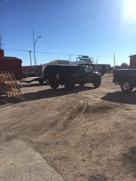

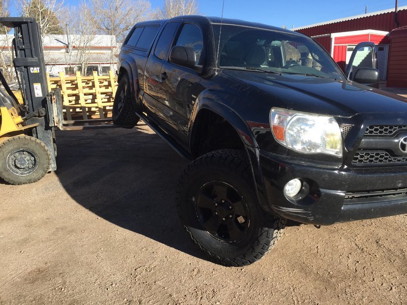

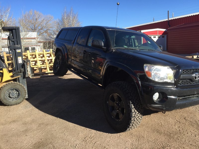

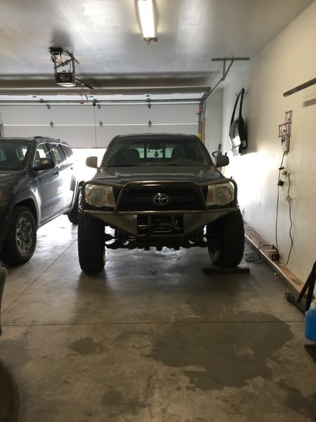

    Winch should be delivered today so I will start on a front bumper this week maybe.

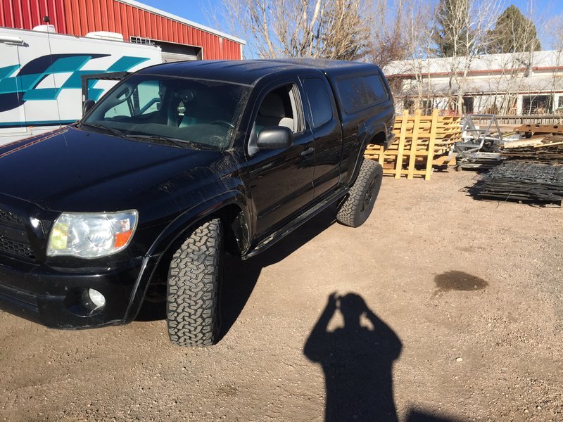

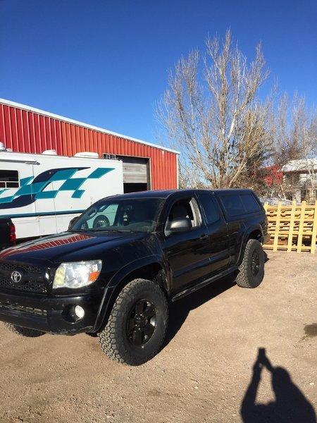

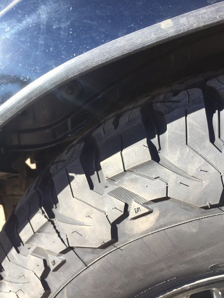

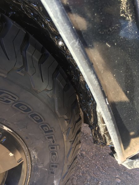

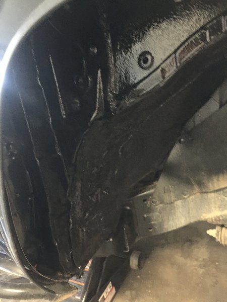

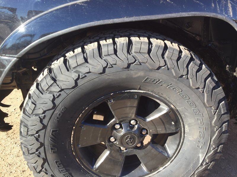

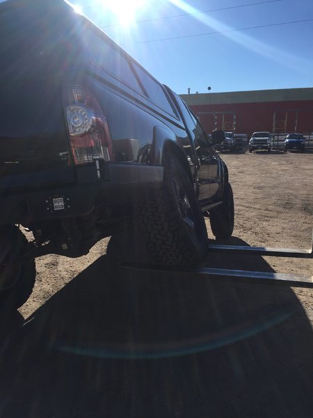

    Got my 315/70/17s installed yesterday. Looks like a little bit of rub in the front of the wheel well at full bump/ turn in and I rub the front of the upper control arm at full turn in so I will address those this week. Probably going to cut a 1/4" spacer or if 6061 at work and stack it with my spidertracks spacers I currently have to be an effective 1.5". Hammer and maybe a mini tub in the front wheel well to fix the rub.
    Thinking about selling my rear bumper and building one that matches the front (front will probably be tube).
    The pictures up close of the front tire are at full bump and full bump full crank.

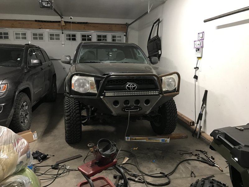

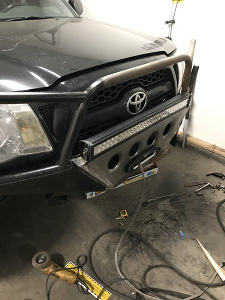

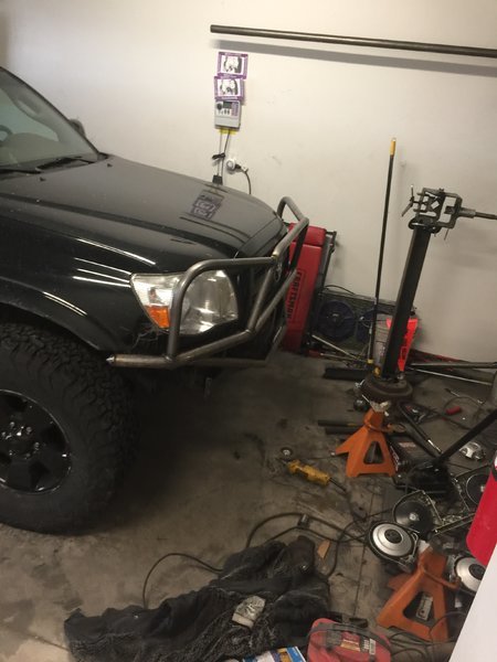

    Started on a bumper last week. Still need to plate the middle, wire the winch up, add shackle mounts and some reinforcements before snow wheeling on Tuesday.
    I will paint it when it warms up.
    Thinking about building a tube rear bumper but not sure yet.

    She is paid off! Still tinkering with the front bumper, not sure I like it too much after I finished plating the sides.

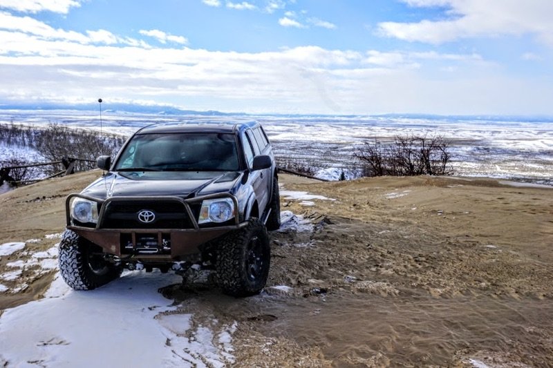

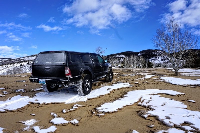

    Still haven't painted or finished my front bumper, but I went snow bashing last week up at the sand dunes.
    I also took my topper off and received an order from wheelers:
    5100s, 1/2" poly spacers and extended studs, and wheelers superbumps with 3/8" spacers.
    Hopefullywith it set at the middle lift setting it will provide me with a level or slight nose high ride. Then potentially building a shackle flip and considering suspension done and beginning to work on skid plates that may become TNT Customs production parts.

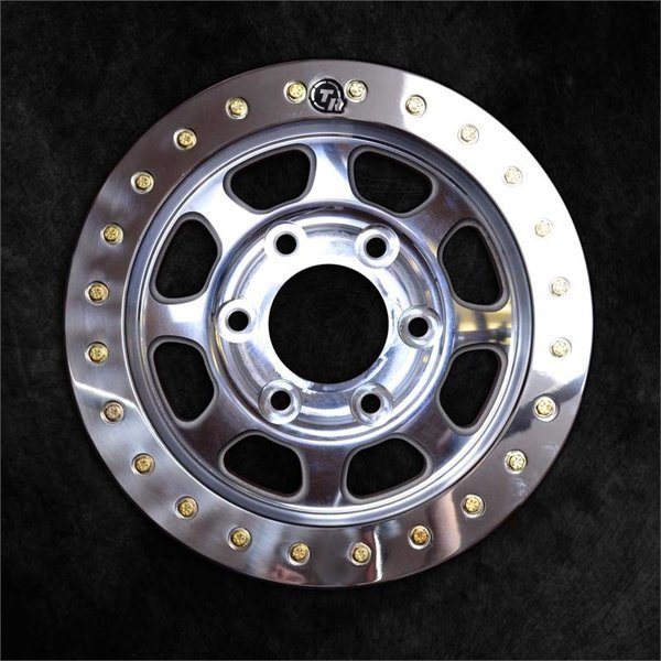

    I am going to order trail ready beadlocks this month but am unsure between the slim ring and the middle sized ring. Any opinions? Color will be silver on silver for now.

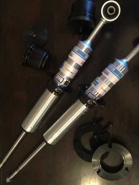

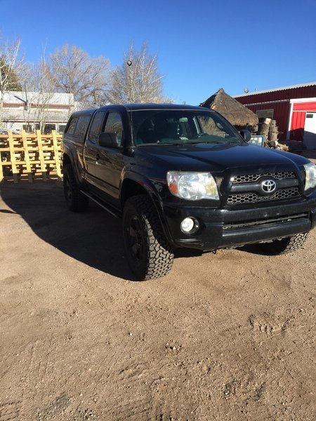

    Installed the 5100s with the spacer and the superbumps.
    Front is 1/4" high and the passenger side is 1/2" high with a full tank of fuel. Not a big deal, I am either going to do a shackle flip to raise the rear a 1/2"-3/4" or install a Tnt u bolt eliminator and a truss to get the height corrected. Either way most likely going to buy some 2.5" remote resivour Radflo shocks for the rear and make them work.
    Hopefully I will get it aligned tomorrow or Tuesday and maybe get some better outside photos but it will still be dirty and snowy.

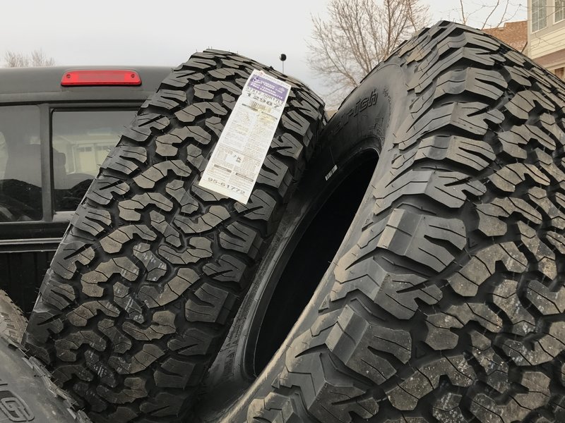

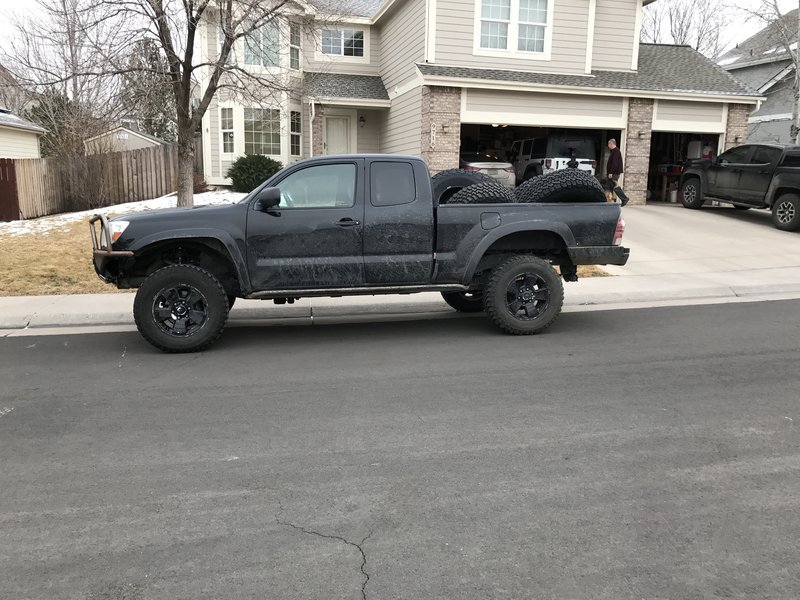

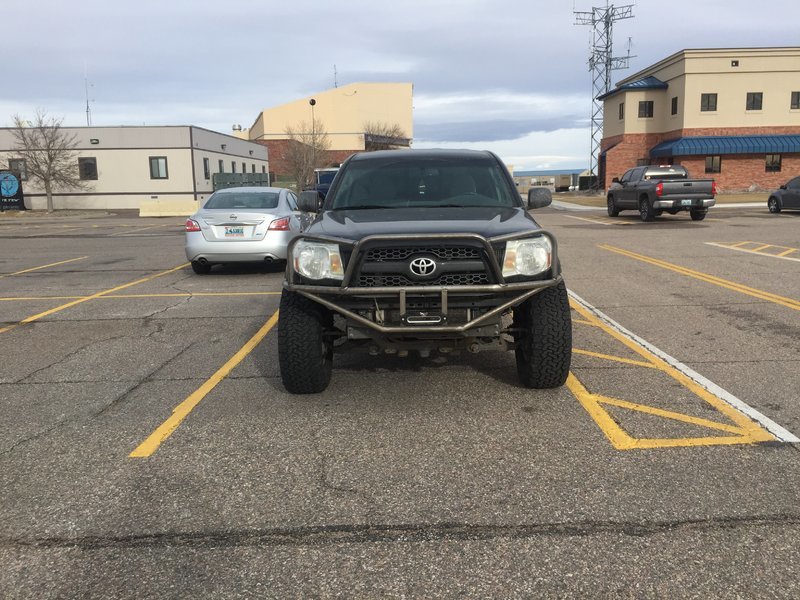

    I sold the 315s to my sister and bought some 37s...
    My trail ready beadlocks should be here in a few weeks.

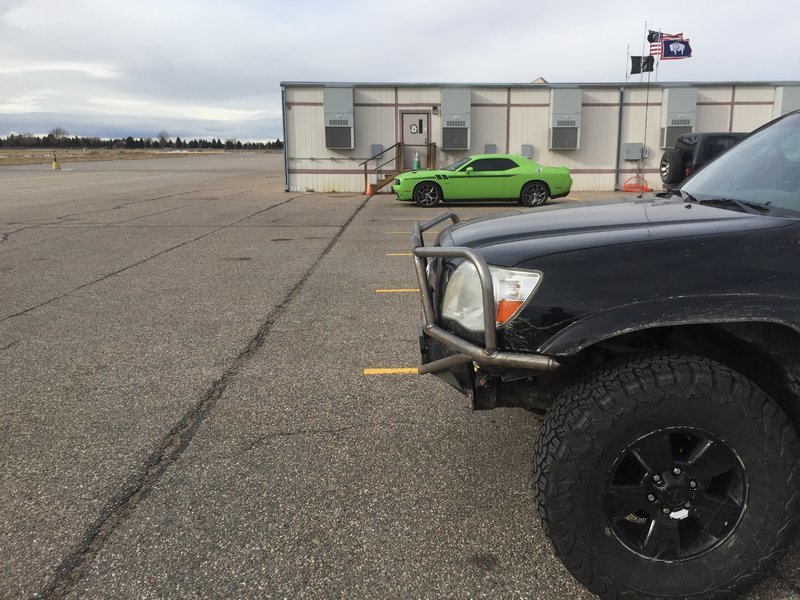

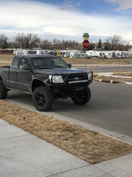

    Still waiting on my trail readys to get here but tonight I finally finished my front bumper.

    2011 Black Access Cab
    It needs 37s. Just waiting on the beadlocks to show up!
    Bumper looks good finished I think.
