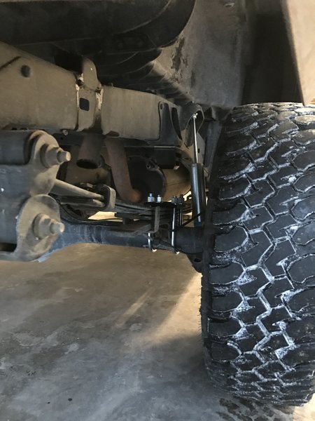

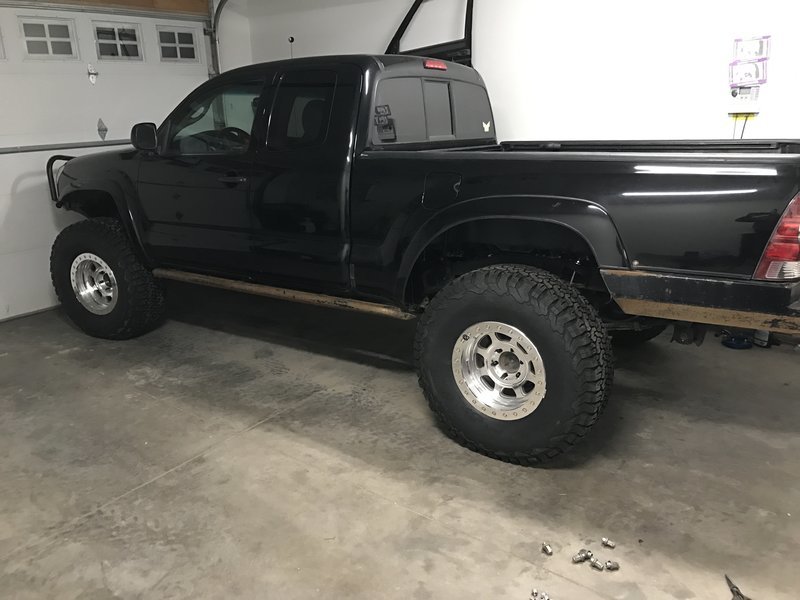

    Did a u bolt flip, bump stops and 5100s.
    Currently has 6" up travel and 3.5" down but once the 37s are on I will dial it in.

  2. Feb 10, 2017 at 6:33 PM

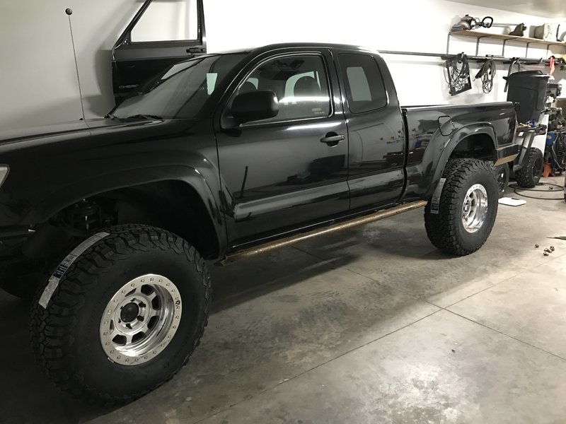

  3. Feb 10, 2017 at 6:42 PM

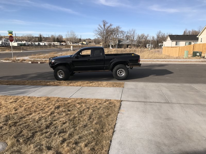

    Never enough
    Show us a side shot
  4. Feb 10, 2017 at 6:45 PM
    #44
    kashtyaatsi
    kashtyaatsi DieselDub
    Sep 20, 2015
    #164774
    4,616
    Asher
    Bitterroot, MT
    LPC's
    Broken
    Side shot! Side shot!

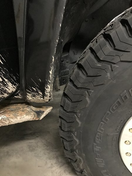

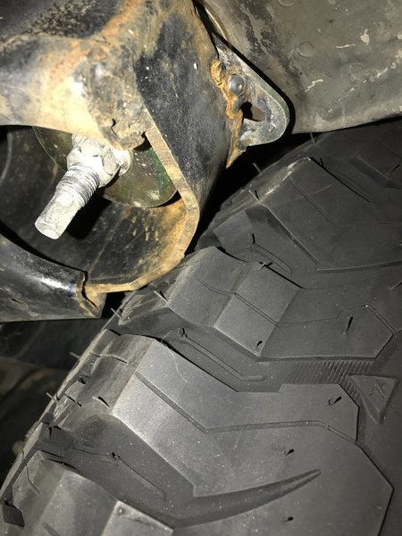

    2011 Black Access Cab
    They clip the body mount. Probably gunna scoot it back a few inches with a new mount.

    Did I miss something or are you still on stock upper control arms?
    Nice rig! lol

    Still stock upper control arms. Trying not to put money into a system I am gunna end up replacing (ifs)...

    That's awesome! Do you know how much lift you ended up netting in front w/ spacer? I am test fitting 35"s in about 2wks to take inventory on how much work will need to be done...

    It was pretty sagged factory stuff and all I did was add the 5100s on the second notch with the factory springs and the top plate spacer. I think it went up 2". 35s need a lot of hammer work and I'd recommend a body mount relocation.

    Good to know, that's about where I'm at. I tossed factory springs on the 2nd notch and I picked up about 2". I have a set of OME 886 coils but not sure if I want to add aftermarket UCA's to the cost of it all...
    Cool to see you stuffing those 37"s!

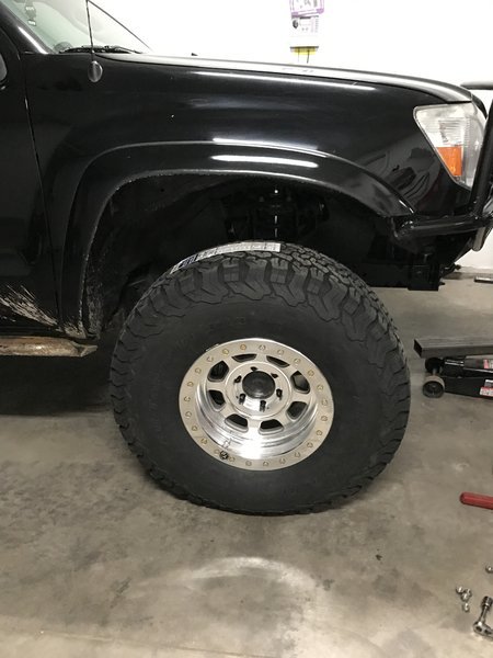

    Trail readys are so sweet. They took very little to balance a 37" tire.
    1.5oz
    3oz
    3oz
    4.5oz
    Might be picking up a Dana 44 with Detroit,4.88s, and rcv shafts this weekend. If I do, I most likely will SAS this taco. It certainly will need help steering and the lack of detroit front locker is the motivation for the swap.
