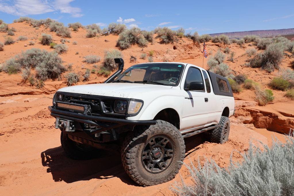

    Truck did pretty well, though with my new bigger tires it was a bit difficult to keep it in the power band, and keep the momentum.
    @unstpible and his turbo did not seem to have this problem

    Scrapped the bumper a little bit on the way down, but I am pretty proud of my bumper design keeping the jerry can an tire clear off the wall.

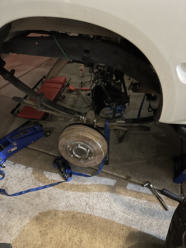

    I've had a wheel bearing that has been humming for some time. I have always kind of known it was an issue, but I had ignored it and convinced myself the sound was due to other things because I don't have the tools to do the job myself. Before the trip I had replaced my tires and just about every other front suspension component, except the wheel bearings. With everything else replaced, there was nothing else I could really blame the noise and funky steering on, and since I had delayed the work until the last week before we left, I had no time left to deal with the wheel bearing. During the first couple days, the wheel bearing noise was getting louder and louder, and I could feel the truck wandering left/right due to the movement in the bearing.
    After leaving the camp site outside Zion on the morning of Day 4, I noticed my alignment was becoming unaligned. I had gotten the truck aligned the day before we left, and they apparently didn't know how to torque the tie rod lock nut. It had backed off about 1/2" from the ITRE, and naturally screwed up the alignment.
    We found a shop in Bryce Canyon City to get the alignment fixed, and decided to just replace the bad wheel bearing while we were at it. Figured it was a safer bet to pay for an overpriced mechanic than be stuck in the middle of no where with a seized bearing.
    We lost about half the day due to this, dropped the truck off at 8am and didn't leave until around 2pm.

    This time, the drive was much quieter without the constant hum of a bad wheel bearing.

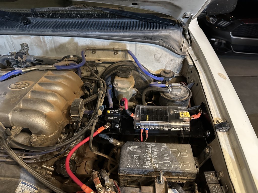

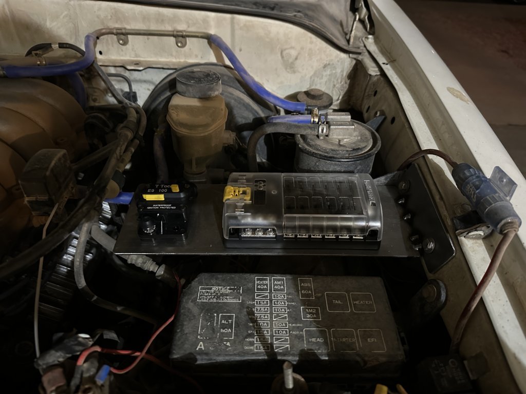

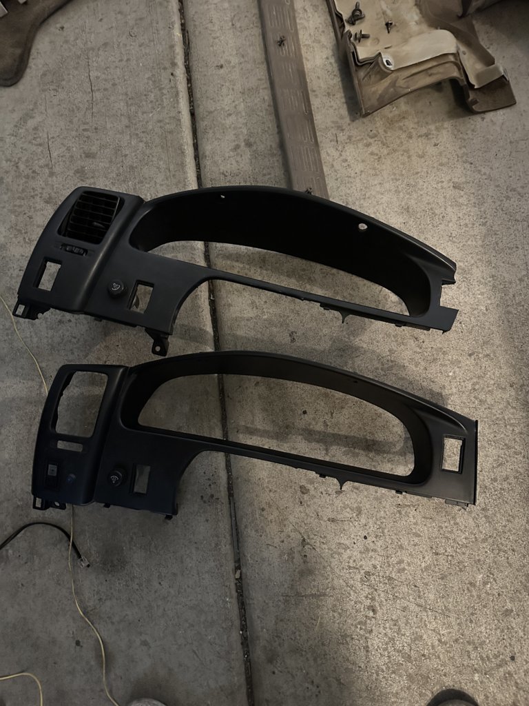

    Had some fun rebuilding my accessory electrical system this week

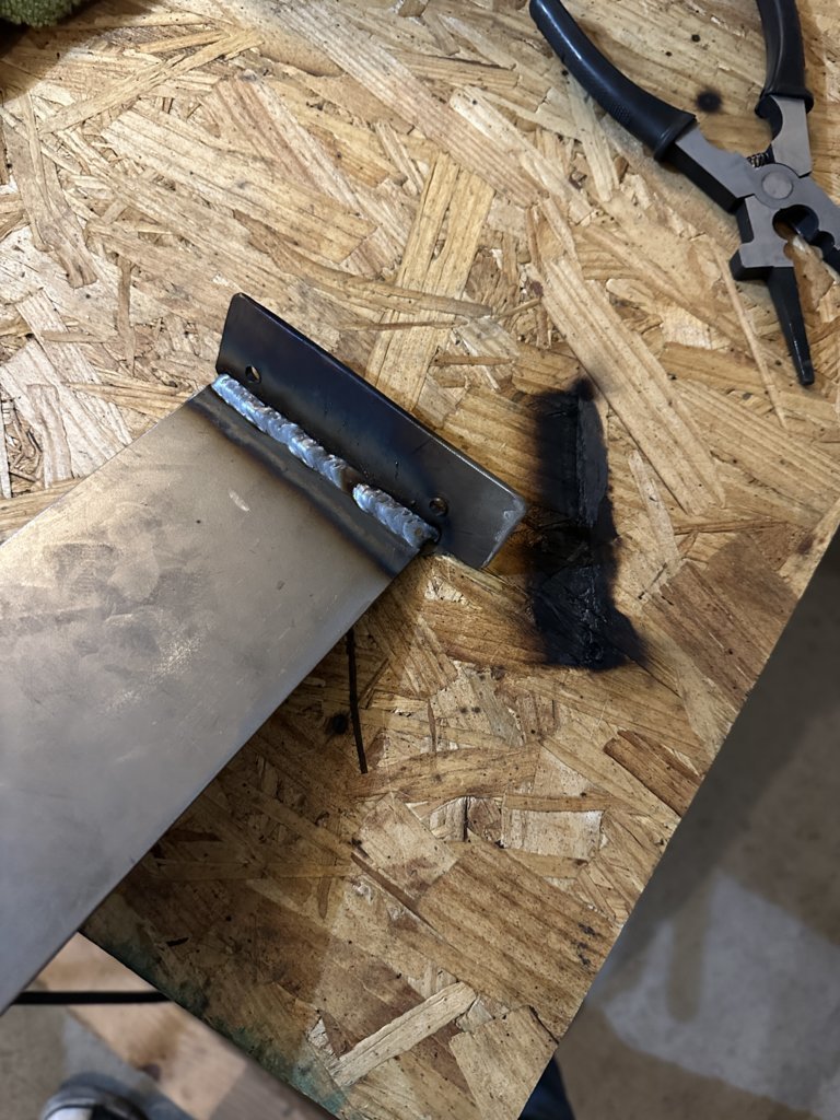

    Started by building a mount plate for a fuse block and breaker.
    Got it all wired up.

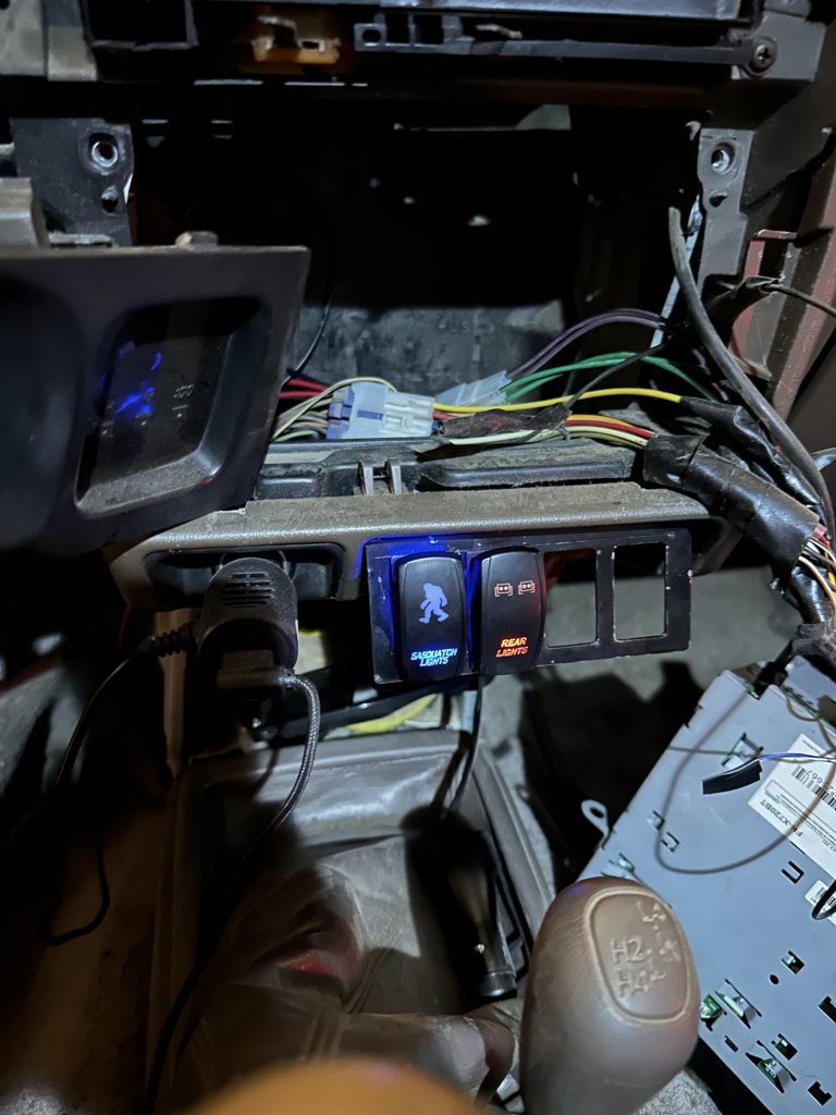

    Took a break after this, and came back to address the rest of my very shitty wiring. It was being held together by wire nuts and wire half the appropriate thickness..
    While rewiring, I also replaced the gauge bezel I had cracked. And moved the switches from the oem switch blanks to a new switch panel. Planning to get some new blanks and leave them stock, having the switches in this old brittle plastic has only caused me issues.
    Yes eventually I will replace one of the switches so the colors match..
    Last two switches are planned for rear locker, and either fog lights or ditch lights. Haven't decided which yet.
    unstpible and Supr4Lo like this.

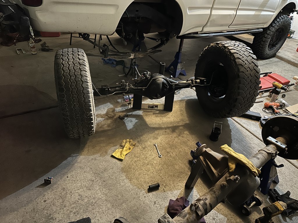

    Spent the last weekend fixing the single biggest limitation my truck faces offroad; open diffs.
    Drove down to Tucson and picked up a stock E-Locker axle out of another 1st gen from a friend.
    Forgot to bring any ratchet straps, so I had to hit harbor freight before hopping on the highway home. Unfortunately I didn't make it there before the axle rolled in the bed, and naturally it dumped a gallon of oil out the breather. I don't think I'm ever going to get that gear oil smell out of the bedliner.
    Used a hoist to get it into the bed, and had to call in backup from a couple friends to get it back out. So it sat in the bed for a couple days before I could get to work.
    Once it was out, I did some quick clean up with a wire wheel and hit it with some fresh paint.
    The logistics of the swap were slightly difficult due to having only 1 jack, and 4 medium sized jack stands. The short-ish jack stands meant I couldn't roll the axles in or out from under the leafs with the wheels on. And the single jack meant they had to be lifted and lowered from the leafs balanced perfectly on the diff.
    I picked up a couple furniture dollys from Harbor freight to help, and I couldn't have done this without them.
    After disconnecting the driveshaft, brake lines, e-brake cable, shocks and ubolts the old axle was ready to be lowered onto the dollys and moved out of the way. It only had to drop about a foot onto the dollys, but it had to cover that foot balanced on my single jack. I threw a ratchet strap around the pinion to keep the axle from spinning forward, and another strap around the body of the axle to try and keep it balanced on the jack. It was a slow process loosening each strap, dropping the jack slightly, and loosening the straps again. Almost made it all the way down, until I failed to loosen the pinion strap enough. This caused the axle to slip backwards and fall onto the body of my jack. Really was the best case failure mode though. It was easy to move since it was sitting on the jack, and the dollys were ready to take the load. Took some finagling to get the jack out and the axle to sit on the dollies, but all in all wasn't too bad.
    From here I took a break for dinner, and originally planned to call it for the night. But after sitting on the couch for a while I got bored and went back out to get some more done.
    Started by getting the old axle onto some stands and out of the way, and started moving over some parts to the e-locker. Moved the brake hardlines and started playing around with the e-brake cable to test fitment. It seemed at this point my e-brake cable would work. I had hoped to use it since I had just replaced it a few months ago. The hardlines fit about 90%, a couple mounting points were just a millimeter off, and the T connection has no solid mount. Not too worried about it though.
    Next I had to move it from the spare tires onto the dollies to move it under the truck. Once under the truck, I had to do the ratchet strap and jack dance again to get the axle up to the leafs. Definitely easier when you're tightening the straps as you go instead of trying to loosen them inch by inch. Only dropped the axle once during this process and the jack/dollies caught it. Otherwise it went right up, threw another strap around everything to line up the leafs and threw the ubolts on to hold it in.
    With the axle secure, I took those old drums off and replaced them with my new ones. I just did my rear brakes like 6 months ago, I swore to myself I never would deal with drum brakes again. Still haven't decided if I'm going to go back in and swap in my almost new shoes and hardware, at this point I'm leaning towards no. I hate drum brakes, and the shoes on this have enough life for years to come. Just not brand new like mine were.
    Spent a while screwing around with the e-brake cables, and came to the conclusion that using my old (new) one wasn't worth the effort, and to just use the one that came with the axle. Toyota decided at some point after 1997 to change the cable from over-axle over-leafs to behind-axle under-leafs, seems like an entirely inferior location to me. It almost worked using my old cable, but due to the cable being forced to go under the leafs, it would interfere with the stock rear drivers shock. You could probably fab a guide to move it out of the way, but you'd also likely have to extend the cable an inch or so to make it work. So I just went with the right cable, despite mine being brand new.
    Next up was the locker wiring harness. Picked it up from Low Range Offroad as a plug n play kit, and it was incredibly easy. Hardest part was just getting the harness through the plug under the drivers seat into the cab.
    With that all done, I spent the next day screwing around with the rear brakes. Trying to get my e-brake tight again, and bleeding the system. I hate bleeding. I decided to torture myself some more by also throwing in a new clutch master and slave cylinder, so I had to bleed that too. There is nothing worse than dealing with drum brakes, and bleeding hydraulic systems I swear.
    But in the end, got everything working, checked the function of the locker before dropping it off the stands, and took it for a quick spin around the block to make sure I didn't screw anything too important up. If I did, I haven't figured it out yet. Time will tell.
    This has been on my to-do list for a looong time, and hopefully will vastly improve the capability of this truck. It already impresses me, but sometimes would just get caught up on a simple rut due to the open diffs. No longer.
