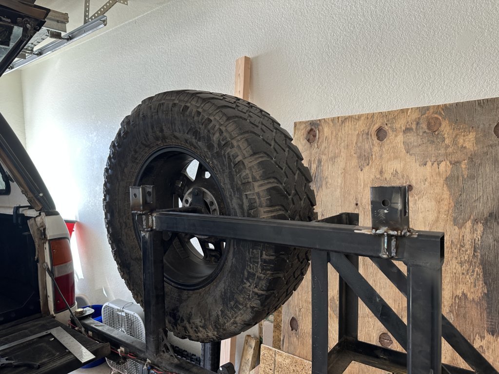

    Finally got out to test out the locker over the weekend.
    Before leaving I spent the afternoon putting together a quick hi-lift mount setup. I think it turned out pretty well, just cut some slots in a 2" tube and glued her onto the bumper. 1/2" bolts and some wingnuts keep it nice and secure.

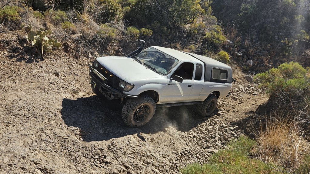

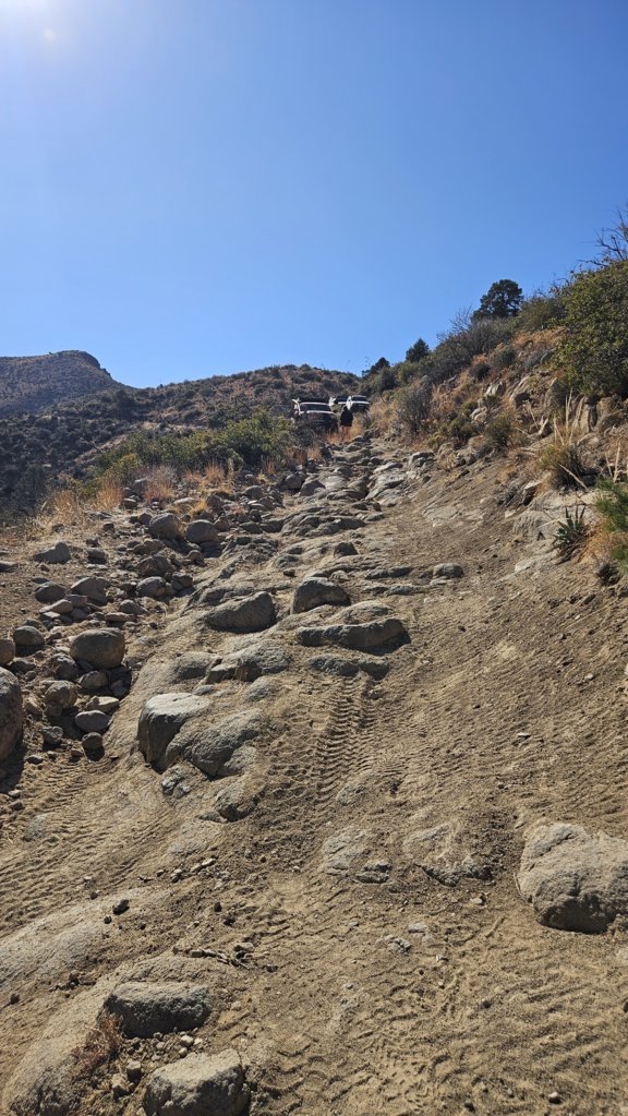

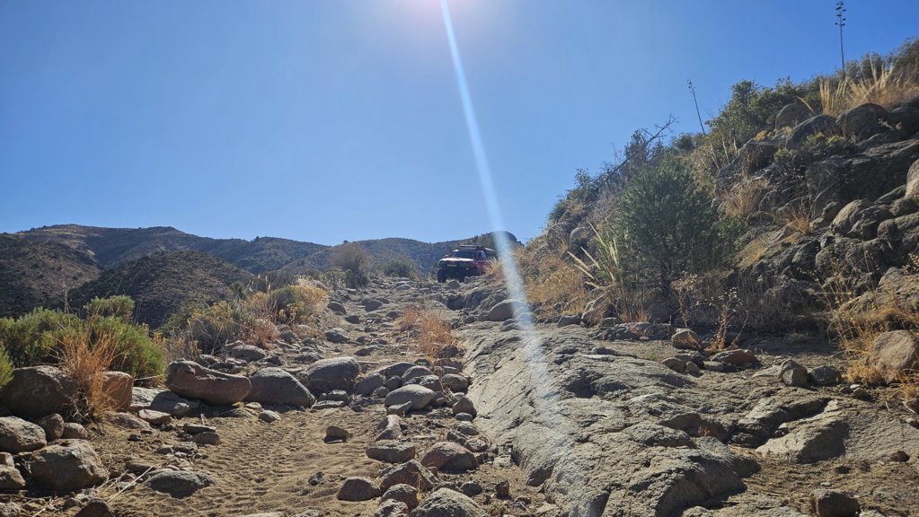

    We did a run of Rug Road, almost exactly a year after we last ran it. Had a great group of guys, and a very fun trail. Seems to have gotten slightly worse over the last year.

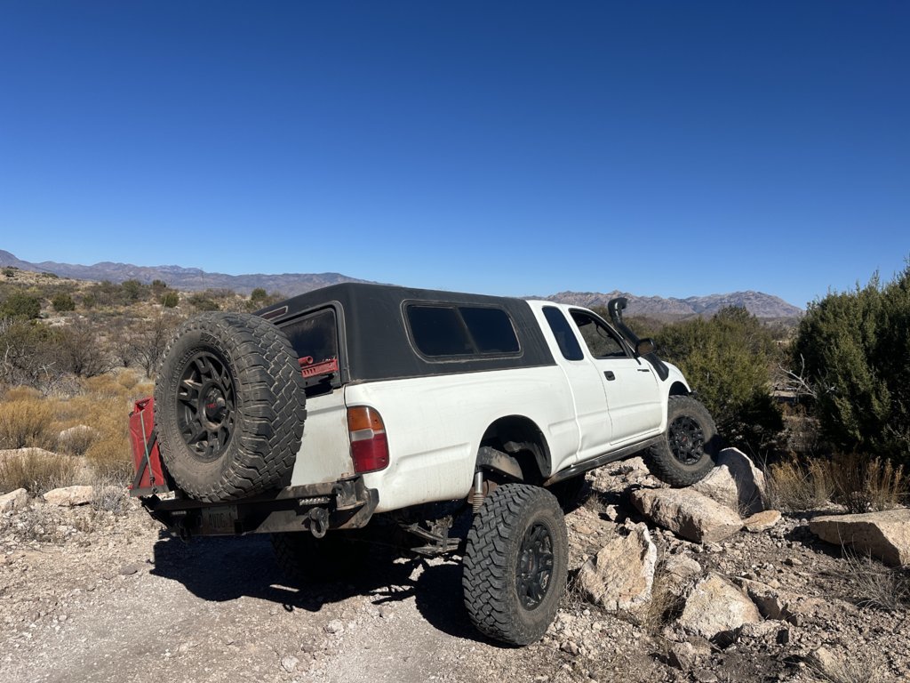

    Had to flex her out of course. These springs sure are stiff, still had quite a bit of up-travel unused when the tire started to lift.
    After doing this trail again, I'm not exactly sure how I made it without the locker. Turned it on all the time, and was able to just crawl right up any obstacle with it engaged. Total game changer, not having to use momentum to get over everything is amazing.

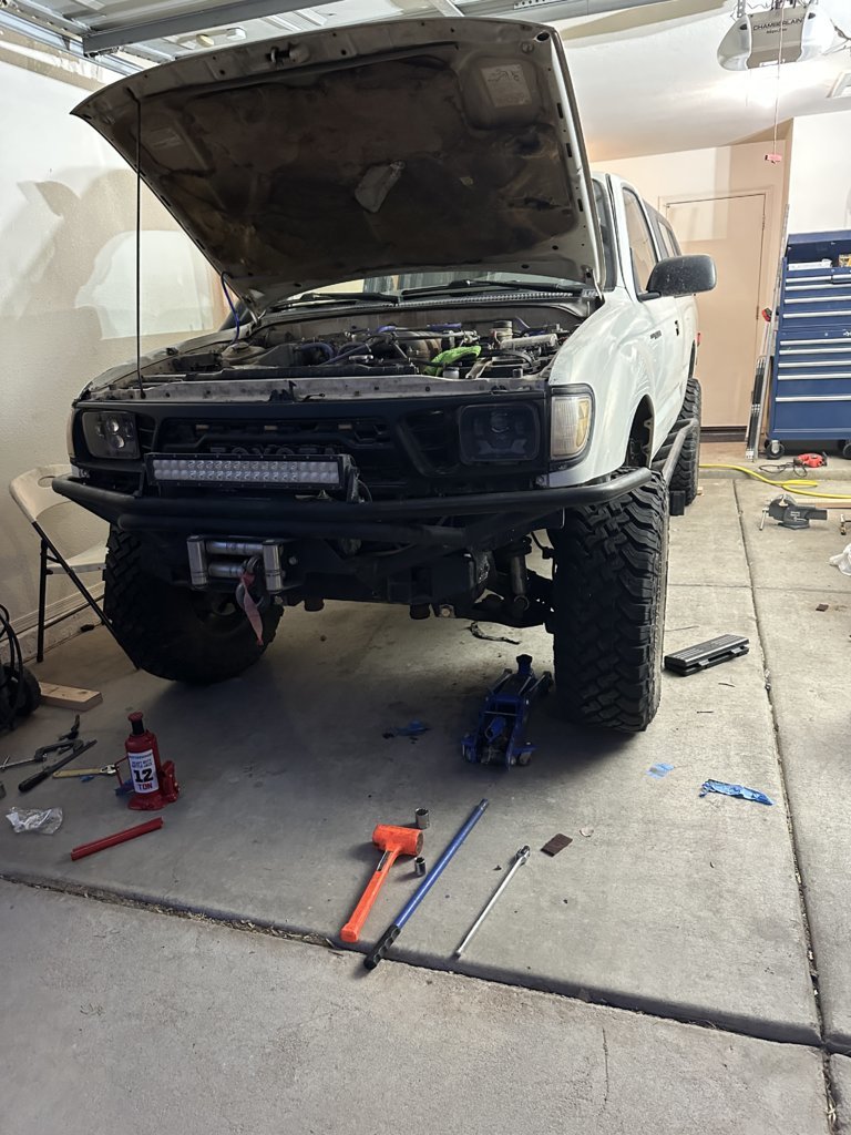

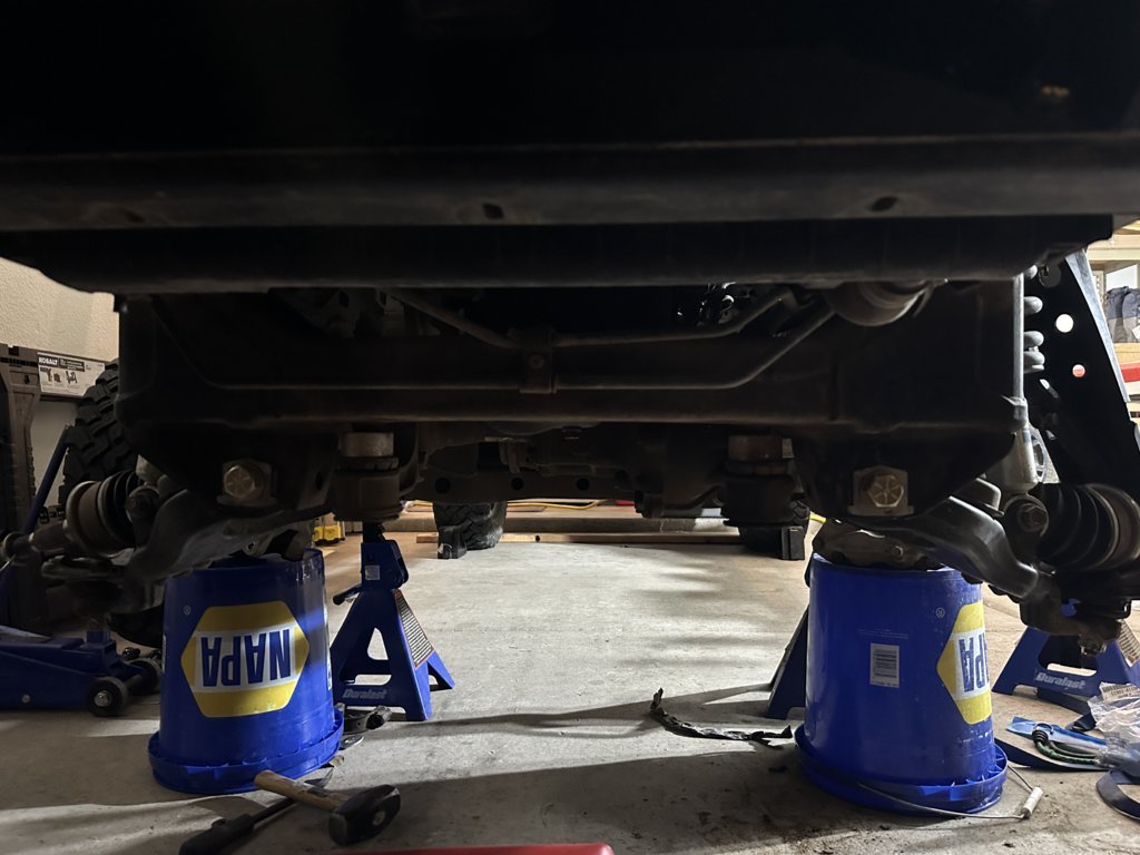

    Truck has been down for a while now.
    Had a decent list of things to knock out on the front end, and its finally ready to go back together.
    Hopefully this week she'll be back on the road
    This time around I'm doing the following:
    LCA Bushings
    Steering Bellows
    Spindle Gussets
    JBA UCAs
    Cam Tab eliminators
    Door Locks were acting up so the drivers door is torn apart too
    At this point I've got the UCAs mounted to the truck, LCA Bushings have been replaced but LCAs haven't gone back in yet

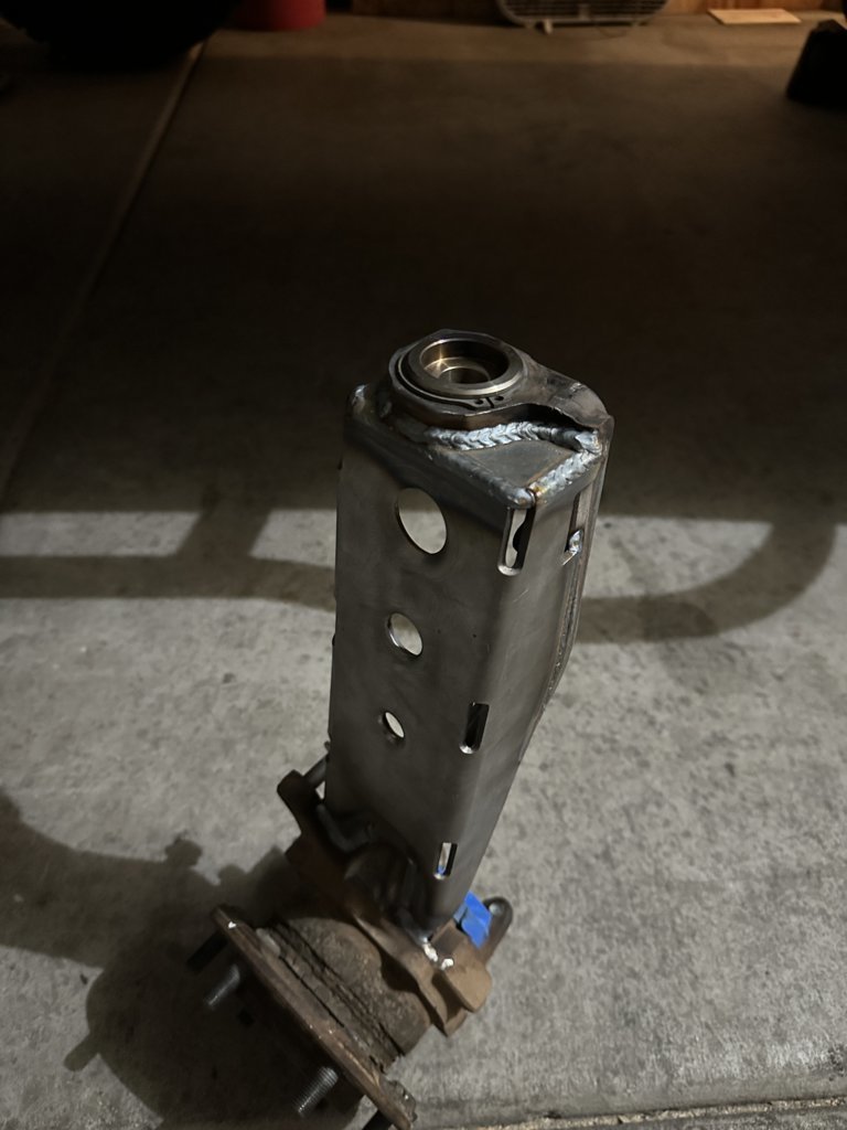

    Spindle Gussets are welded on and looking great

    Looking damn good! Look at those dang welds!!! Did you weld those spindle gussets? Also plus 10 style points for the JBA's :thumbsup: You got a healthy list for the truck but all in the name of driving buttery down the road and trails. Good luck on it all including those pesky door locks!

    Wish I could take credit for the welds, had to call in some more experienced reinforcements getting my spindle straightened and the gussets square. I was going to just get help on tacking them up square and then I'd finish it, but he was already all set up so I just let him finish burning them on. Definitely looks better this way haha
    I found during disassembly my stock UCA bushings were completely ruined, allowing the entire UCA to shift forward/back more than an inch on the UCA Bolt. These JBAs should be a massive improvement, both because of that, and correcting my horrible old caster angles
