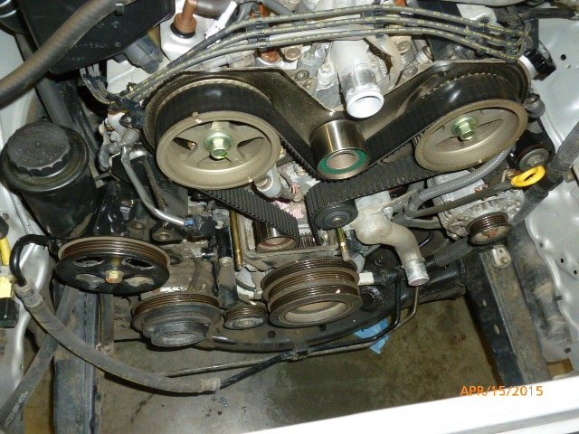

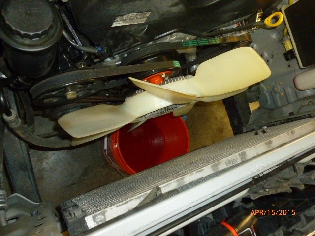

    Pull the radiator. It's a couple extra minutes work (IIRC four bolts accessed through the grill to pull it) and buys you a whole lot more room and you won't have to worry about whacking the radiator fins with an errant wrench. See pics with radiator in place and then removed. Nice to be able to work in there without worrying about damage to radiator.

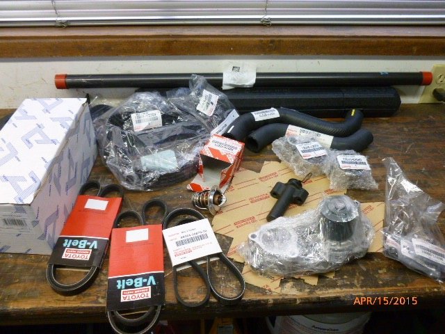

    As NightProwler suggets, AirCabinMan on EBay was the best price I found on a whole kit for timing belt, water pump, et al. I bought from him and they were all new original Toyota Parts, so I can echo that recommendation. See parts picture (that's my "cheater" bar on top of the parts pile).
