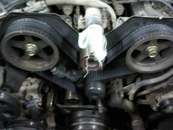

    When my water pump failed i could here the bearing squealing but i didnt know what it was. I left it long enough for it to break off its axis and it started rubbing the timing belt against the motor. It then started to smell like rubber, smoke came out and it was squealing. The next day driving to work i noticed the temp gauge maxed out and and my rad was boiling. The water pump failed.
    Generally the waterpump will fail before the timing belt. So if you hear squealing, its most likely an idler or your waterpump. Take off your timing cover and inspect.
