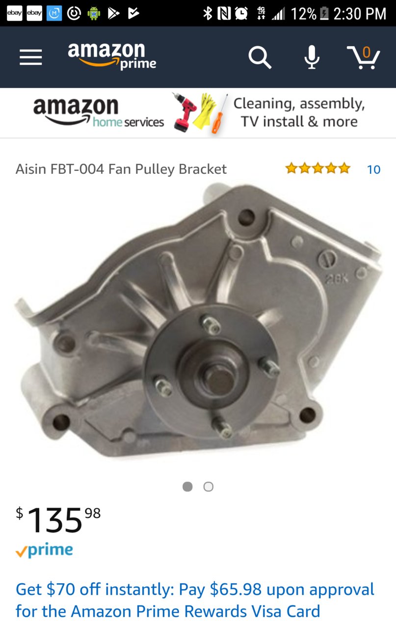

    How is the noise from your belts/pully’s? If suspect I would order a fan bracket as you will be pulling it off anyways. They are about $70 for an Aisin on Amazon.

    I'm not 100% sure its the pulley bearing, but I've read enough posts on here to start at the least expensive thing to replace. And since I'll have the pulley off doing the timing belt, may as well get that done. Its a low whine at idle, and get progressively louder as I go faster, but never loud enough for me to hear it with the windows rolled up.

    The Aisin bracket and pulley is $135 on Amazon
    You're better off getting it from Low Range Offroad... at least that's where I'm getting mine. It's $119
    http://www.lowrangeoffroad.com/toyo...et-with-3-4l-5vzfe-v6-engine-tac-er-cfpb.html

    Actually... Depending on frieght charges from Low Range... and if you have Amazon Prime... Amazon may still be the better deal.
    Anyway... there are options.

    Why would I have to change the cover?

    Cover? Are you talking about the bracket?

    I'd see if you can just replace the bearing - it's just a little one in there... how bad is yours?

    Looking at the pic, that's the timing belt cover. The whine isn't bad and hopefully nothing breaks in the next month when I can get the maint done. BTW, I'm not a real mechanic, I just know how to do a few things.
