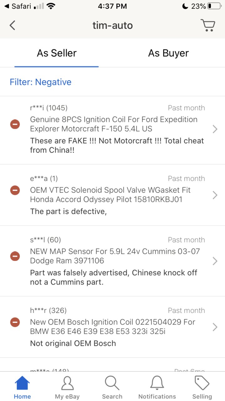

    From this guy? Yeah...... you got EBay’ed the negative reviews go on and on...0E299962-C7D7-4A8B-A5B3-1D9CA35E13F4.jpg

    Ah. That doesn't look good for me. In my defense, the account did have a 'Top-rated Seller' icon on their profile. Then again, I suppose anyone with enough time on their hands can sit around all day writing fake positive Ebay reviews for themselves . . .

    I know the picture depicts Toyota boxes but the font and sizes are never right. Sadly more often than not it’s Chinese junk in a counterfeit box...

    This is one of the easier indicators to spot. The labels and their font are easy to see that it's counterfeit, at least for me it is.
    I would assume that the OP's mechanic would have noticed if any of the other stuff was counterfeit.
    But we know how that 'assume'-ing stuff works out.... Hopefully the tensioner is only fake part involved.

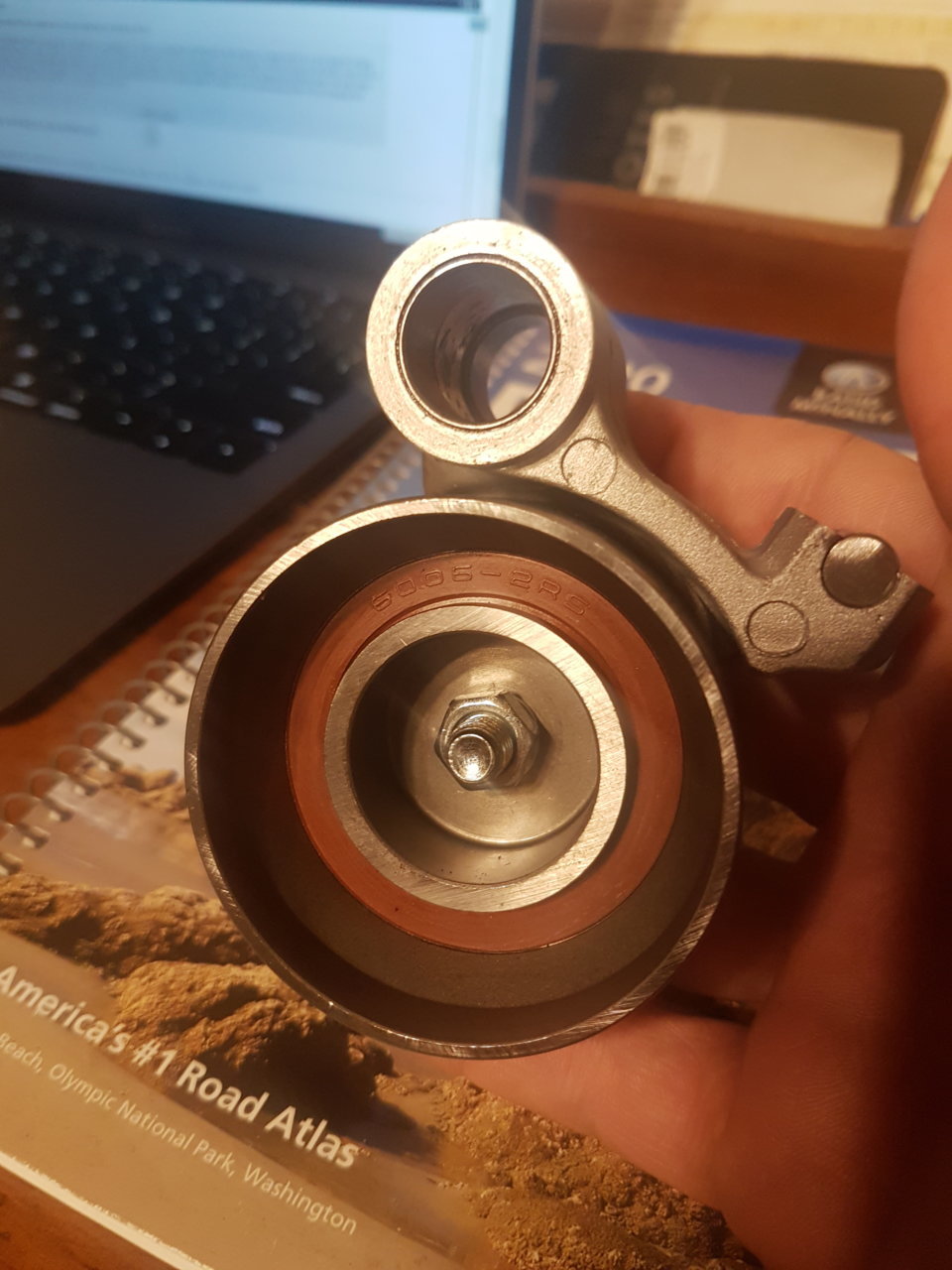

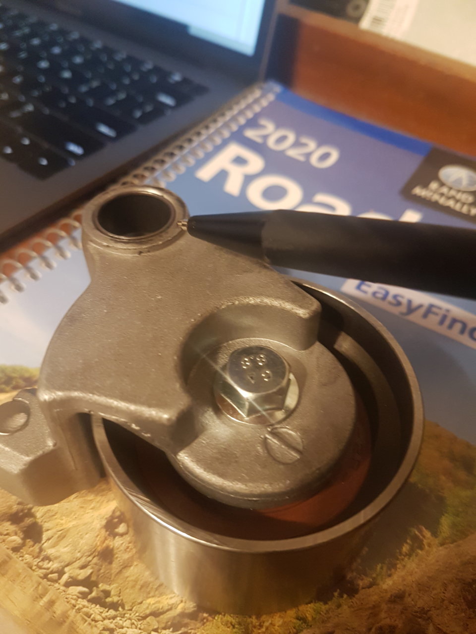

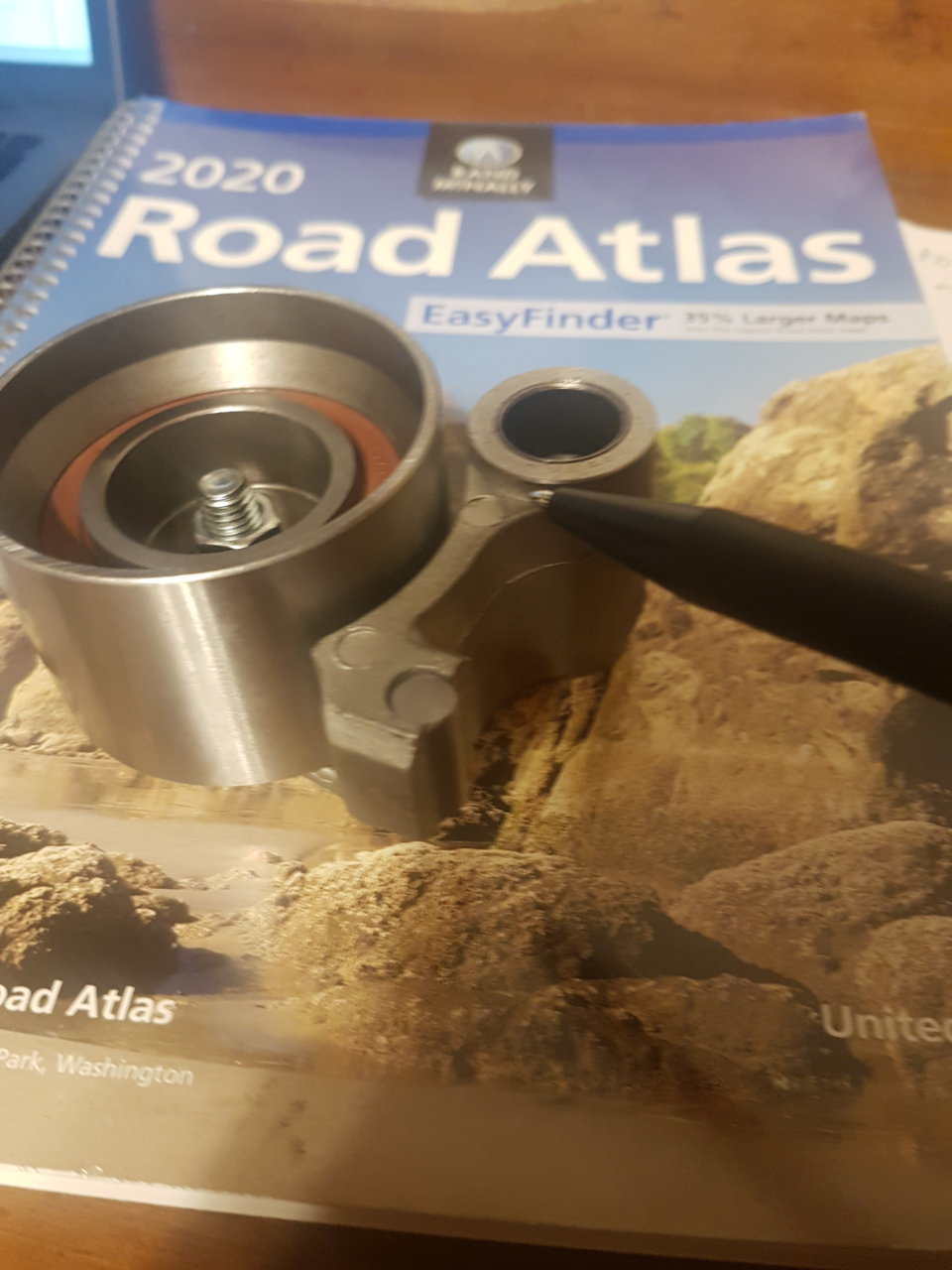

    Here's a summary of what he had to say (or rather how I understood it): There is a shoulder bolt that holds the tensioner in place and it is a very specific length. The new tensioner has an extra 1/8th lip on one end of the bolt receiver that made it so the bolt wouldn't screw in properly. The lip could not be taken down with a grinder because there is a bearing inside that likely would have been compromised. They kept the existing tensioner and replaced everything else. He said there were no other issues with any of the parts so no reason to be too concerned with the kit. When asked if I need to worry about going back in and changing the tensioner soon, he said "don't overthink it. Just go enjoy your truck."

    I have not yet reached out to the seller though I did post a review to warn future buyers of the kit. Being that the rest of the parts are installed, I'm not sure if asking for a partial refund is in order, or if that's just the tax on a lesson learned.
    Here are photos.

    Did he show you the difference from the old one to the new one?
    When I replaced this threads unscrewed with the bolt and I had to helicoil new threads into it.

    From lip to lip it measures 1 5/8 inches. Supposed to have been a tad shorter or so I am told.
