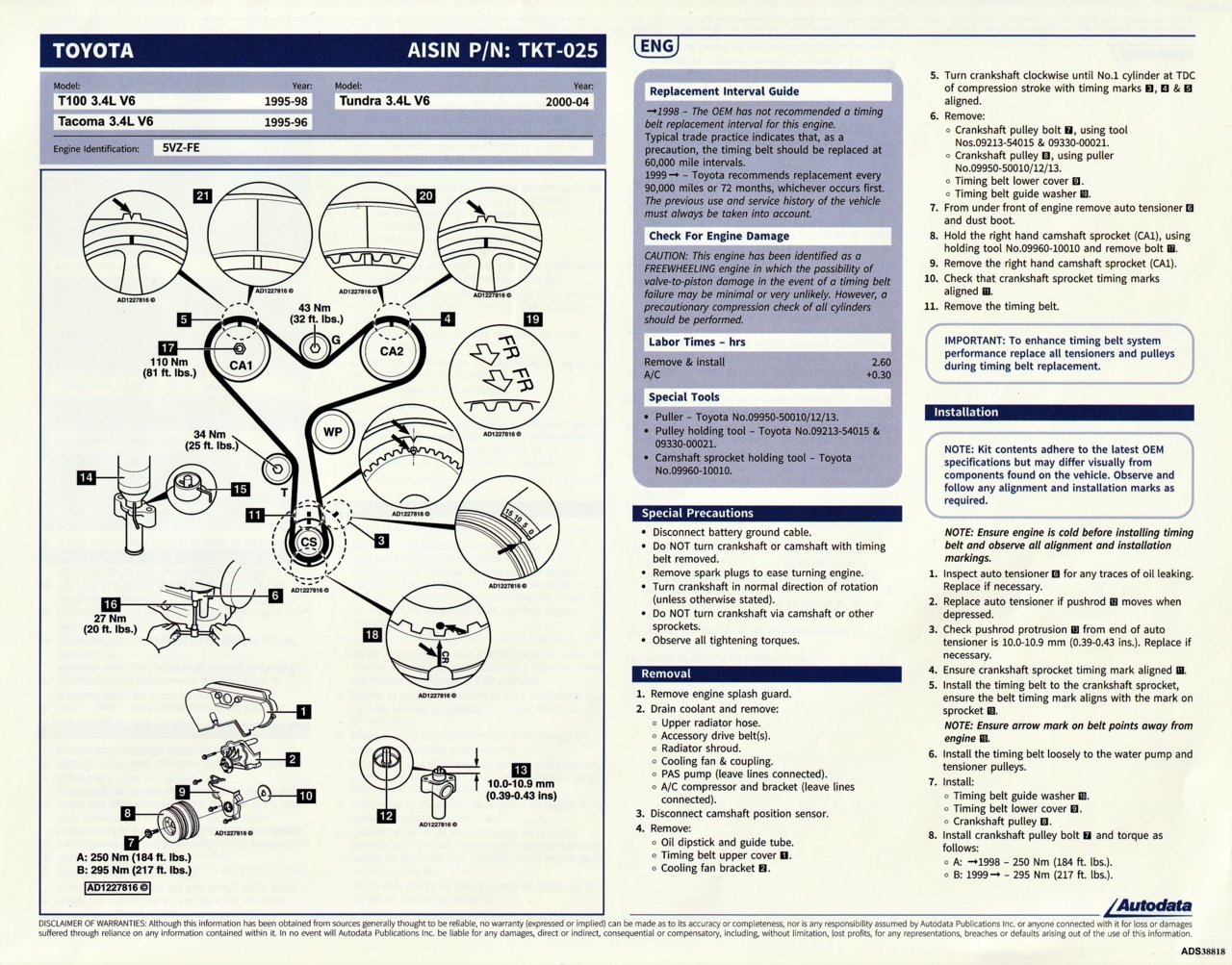

    Not sure if this is worth posting but I figure its worth a shot in the dark.
