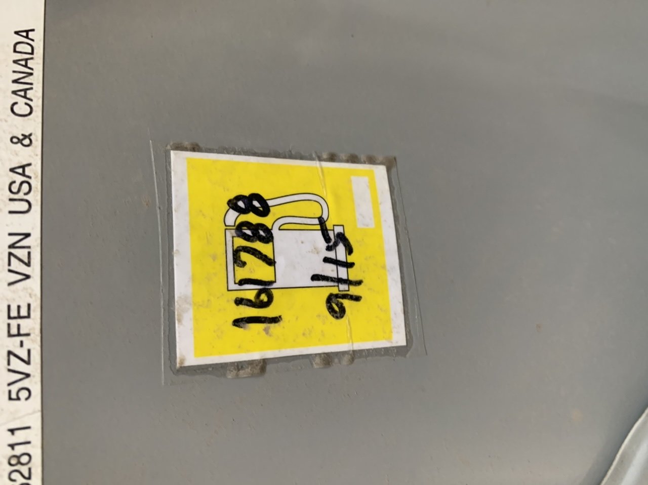

    I think this is probably the date and mileage of the timing belt change, nothing else under the hood. 196,464 on the clock. Would you assume that or just change it?

    Time to change it.

    I agree, if you don’t know for sure change it out, but the 3.4 is a non-interference motor so the worst thing that can happen is it leaves you stranded somewhere if it breaks.

    Ok thanks

    Yeah I'd change it.

    Myself I would unbolt and slide the Top timing Belt cover front and check out what the belt looks like .
    Unless you feel like changing it at 35,000 miles again.
    Your truck your rules mine is at 250,000 miles I need to think of having it done the first time.

    That's a pretty ambiguous sticker. It could mean anything. Maybe that's the mileage/date the PO lost his virginity in the back seat...
    Timing belts are a ~90k/9yr item anyway.
    As @Wyoming09 said, I'd inspect the belt first and go form there. As others said, it's a non interference engine so it's not going to blow up if it breaks, but lot's of people get 200k+ out of their timing belts. Not that I'd want tp push it that far on purpose.

    rofl
    I am going to just order the OEM parts kit from that guy on eBay

    The aircabinman one?
    Yeah, that's where I got mine, too. He has several kits, just make sure it's the right one.
