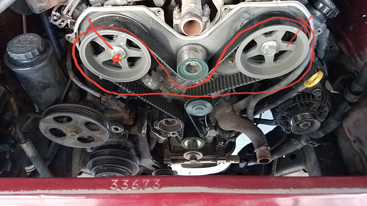

    I didn't use a cam pulley tool. I just cut the old timing belt, then wrapped it around both cam pulleys and used the center pulley for leverage. I ran it like the red line in this pic for the pass side. The lines on the pulleys are where I vice gripped the belt to the pulley.
    This pic is the way I ran it to loosen the passenger side and also to tighten the driver side... I had no problem getting either bolt loose... or getting the proper torque to tighten.
    foxrcing07 likes this.

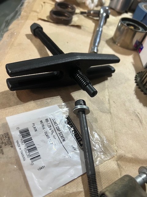

    Do you happen to know what the thread pitch/bolt size is for these? M8x1.25?

    Yes, those are M8x1.25...they're around 100mm long....I just did this a couple weeks ago, and picked a couple up at the hardware store...I couldn't find any that long, I think the longest I could find were like 80mm long and they worked fine...and to be completely honest, I don't even think I needed the puller, I got everything on there ready to engage the puller and it just slid off :D
    Digiratus[QUOTED] likes this.
  17. Jul 25, 2025 at 8:18 AM
    #57
    rish57
    rish57 Well-Known Member
    Mar 6, 2025
    #467217
    68
    2000 Tacoma 3.4L SR5 4x4
    Actually I take that back looking on my pics, I did find and use a M8x1.25x100mm...it was the first hardware store I went to that had I think was 60 or 80mm longest, which I initially purchased but then made another run to another and found the 100mm.

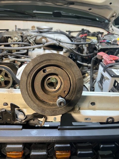

    Awesome. Thanks for the feedback. I am going to make a tool to keep the harmonic balancer from turning when I re-torque that crank bolt.

    Depending on the tool you're making, this is how much the 100mm stick out; you may want something slightly shorter or longer... (this is from my timing belt write-up)
