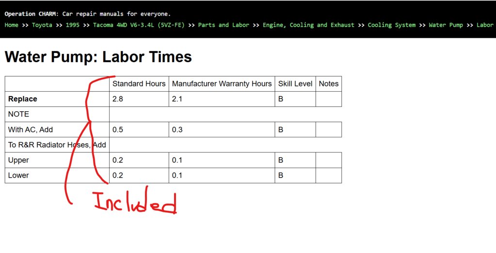

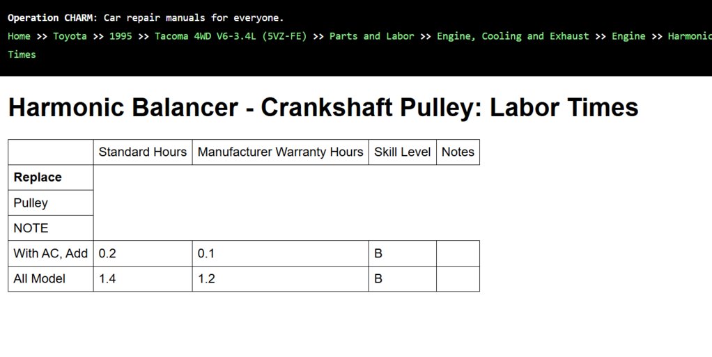

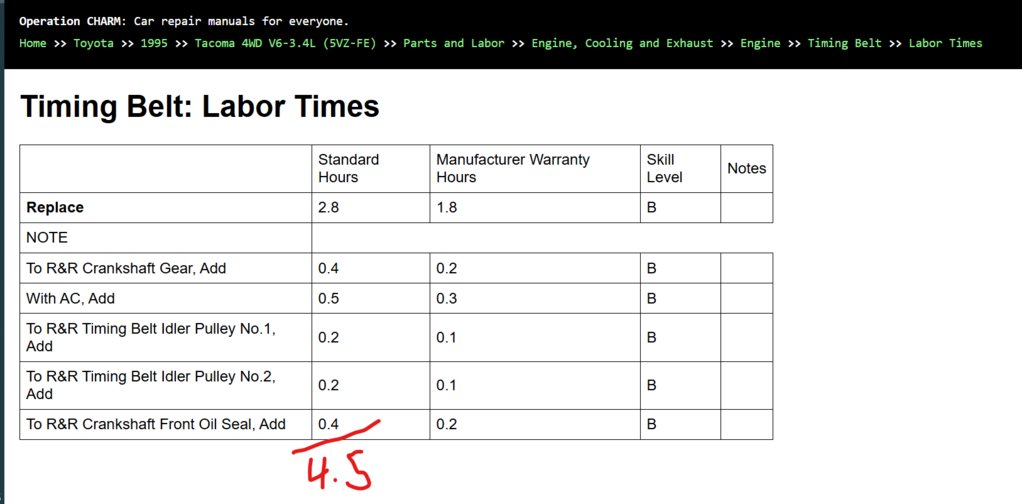

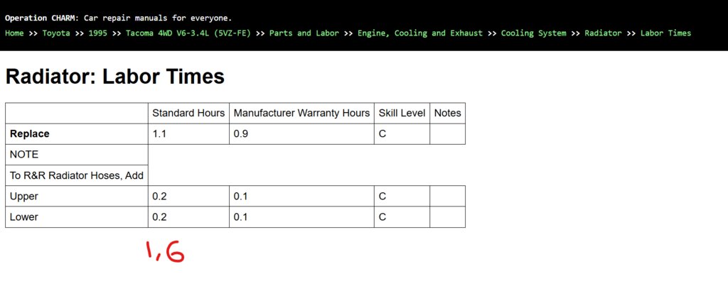

    need to know what you shops labor rate is.
  16. Jul 23, 2025 at 3:33 PM
    #16
    ControlCar
    ControlCar My Moto: Help & Learn…period.
    Jul 22, 2023
    #429578
    3,491
    Steven
    Sugar Land TX
    1996 Taco 2.4L 2wd Automatic
    Clock Volt meter/LSPV Delete/Hyundai 16’s/FP gauge/after 9months of wrenching ZERO oil leaks
    general idea of book labor hours
  17. Jul 23, 2025 at 3:40 PM
    #17
    ControlCar
    Jul 22, 2023
    #429578
    3,491
    Steven
    Sugar Land TX
    those are some common labor hours for typical labor hours
    im adding 7.7hrs
    now need to see exactly what they are doing...........besides labor rate
    (estimated hrs bc of overlap)
    cam seals? additional 2hrs
    thermostat? additional 1hr
    are they Evac/Recharging AC? additional 2hrs*****shop can 'hang' compressor and not open up system*****
    oil change?
    spark plugs?
    for Tbelt $1900 way high
    for everything on their estimate? might be spot on but need to see quote
    if they wrote on a post it note $1900.....run
