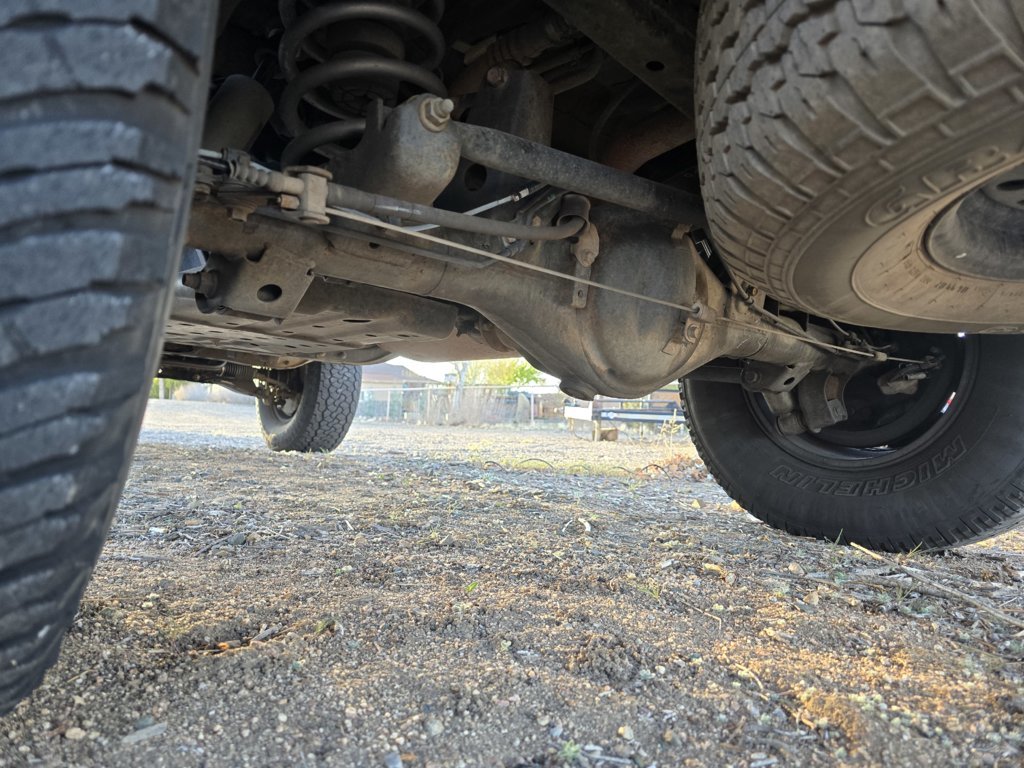

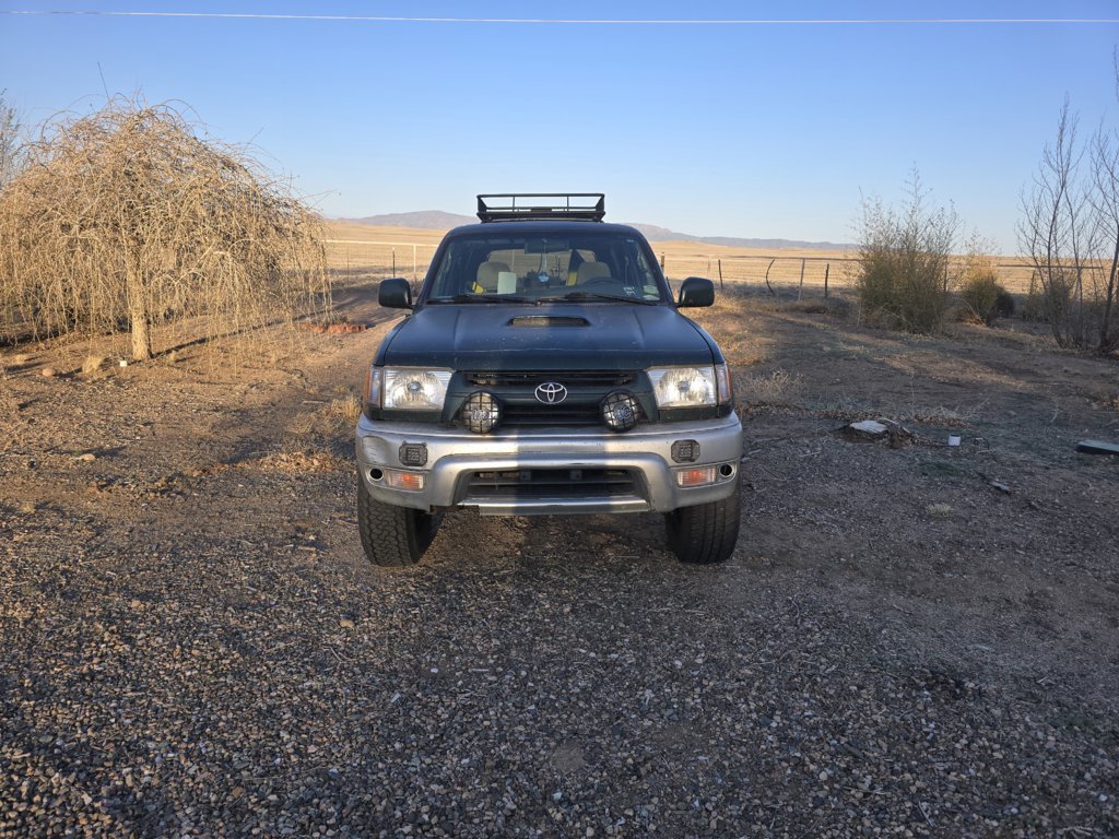

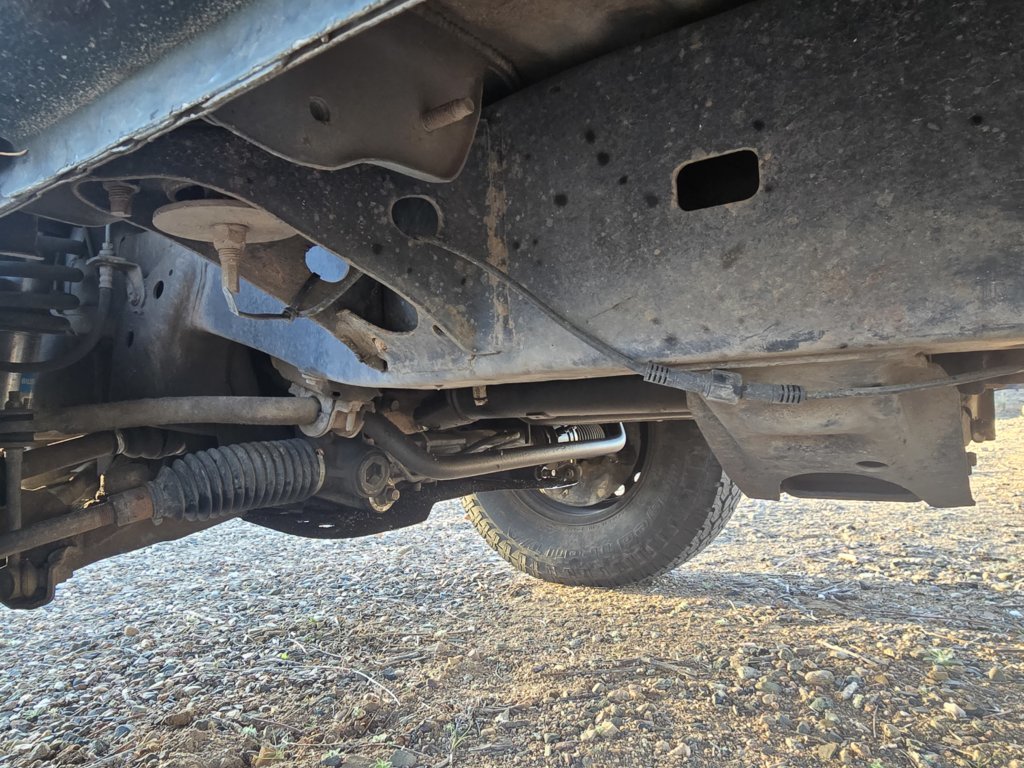

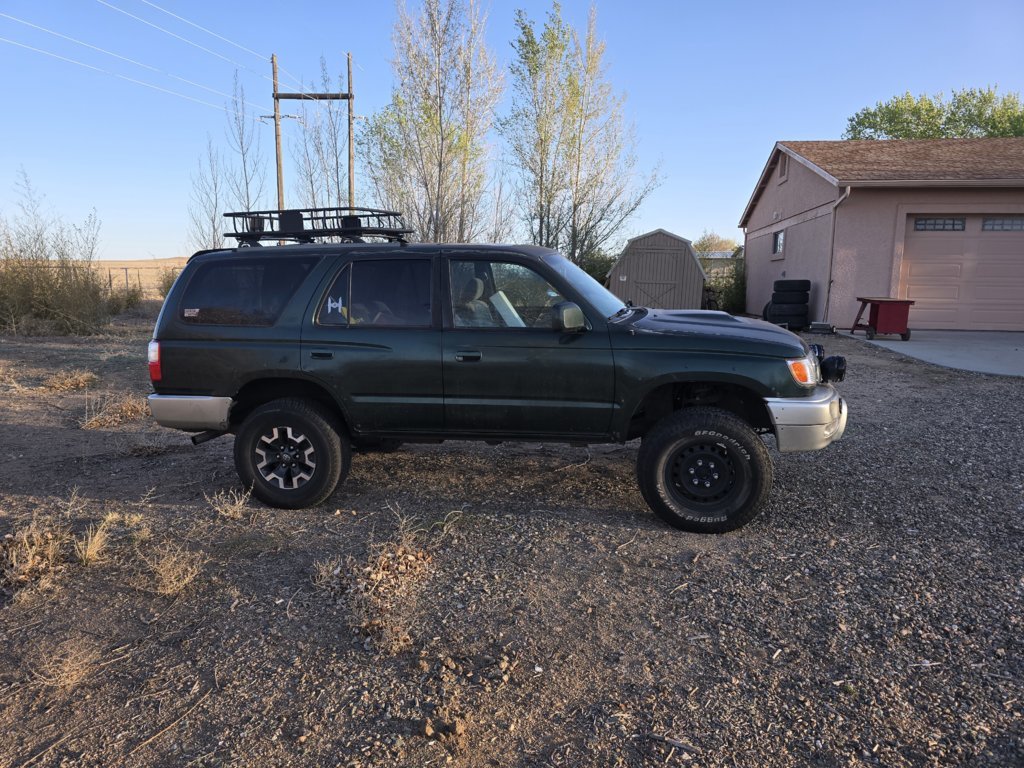

  17. Apr 9, 2025 at 6:35 PM
    #37
    Red_03Taco
    Red_03Taco [OP] Well-Known Member
    Nov 2, 2021
    #381170
    1,752
    Jerad
    2003 Tacoma Xtra Cab 4WD
    If these peak your interest I can get you more photos. He'll have it up on Marketplace sometime tonight or tomorrow morning too. So I can share the link to the ad
  18. Apr 9, 2025 at 7:52 PM
    #38
    Jerry311SD
    Jerry311SD Well-Known Member
    Jul 20, 2016
    #192481
    1,647
    Jerry
    Ramona Ca SAN DIEGO
    2019 tacoma TRD Quicksand
    KDMaxx tune K&N drop in AFE catback Oil catch can Bill's 6112/5160 Dynomat whole inside of cab TRD skid plate
    Not super jacked I've seen worse.
    Good platform for a rock crawler build. New engine and trans.
