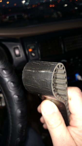

    given what my belt looked like, i'd say my truck was still on it's first when i changed it at 193k. cracked like the one posted above, but hadn't failed yet. it was only a matter of time.
    also as stated above, even it it fails, you're just looking at resetting the timing and putting a new belt on. there's some peace of mind in that. ...well, that and the tow fee (and shop fee if you can't get it back to your place).

    Curious, how many miles on that belt?

    here's 193k

    Daaaaammmmn, that's a good run on a timing belt. Almost 200k without breaking. Crazy. I always recommend folks follow the manufacturer specified change interval on the timing belt. But most I've done could get away with possibly running an additional 30k or 40k. But really, it's just not worth it to intentionally go that long.

    definitely not my choice, but i'm glad it lasted that long! it was the second thing i did to the truck after changing the rotors and pads. better to be able to stop than start...
