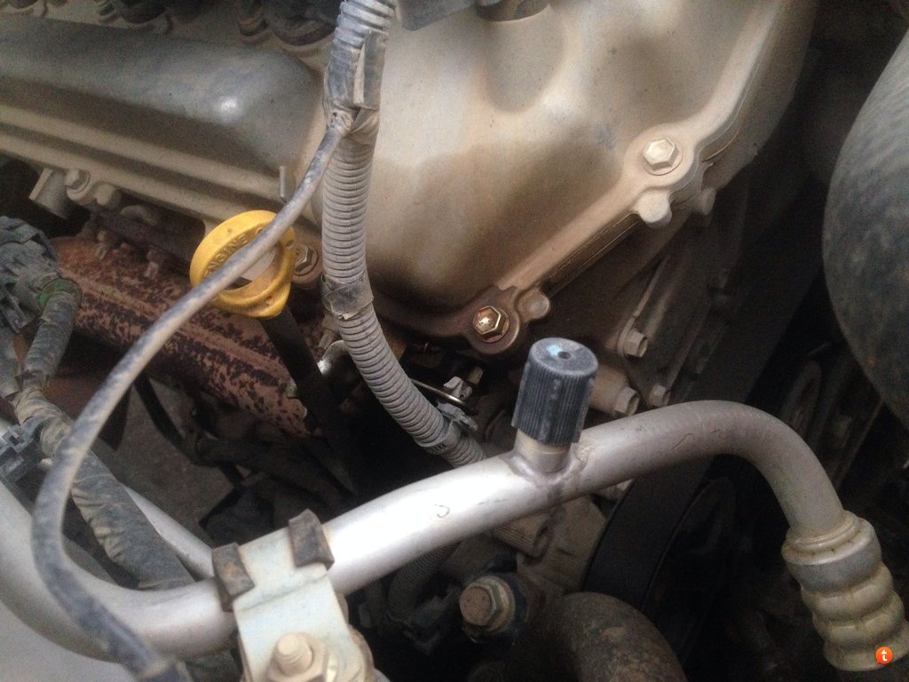

    It doesn't sound like it drips into puddles on the ground in your parking spot either? If still in warranty then I might go ahead and get it done, but if it just accumulates grunge like the photo with no dripping messes underneath I'd just live with it. $900-1500 (prolly more like $2k where I live) is way too much just to have a tidy motor.
    The TSB isn't an extended warranty. In the US it's covered only under the powertrain warranty too.
    Common confusion about TSB's: they aren't an extended warranty or recall; just a documented specific repair for common problems.

    I think this is just my valve cover. I was misidentifying the problem. Each side weeps just a little bit on each side. It might just look worse now due to 30F nights followed by the truck reaching operating temps during the day.
    Help me decide what to do.
    I'm about to replace all differential fluid, air filter, spark plugs, cabin air filter, engine oil.
    Would you go ahead and squeeze in a valve cover gasket replacement if you were me?
