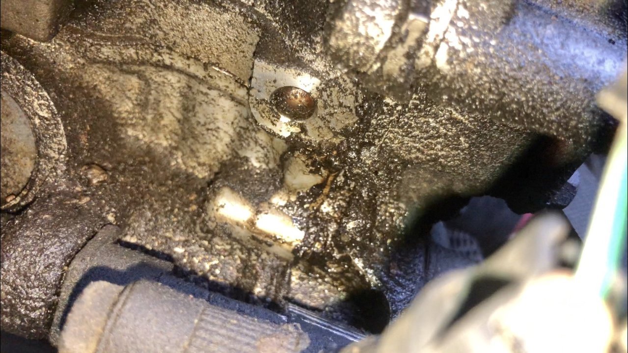

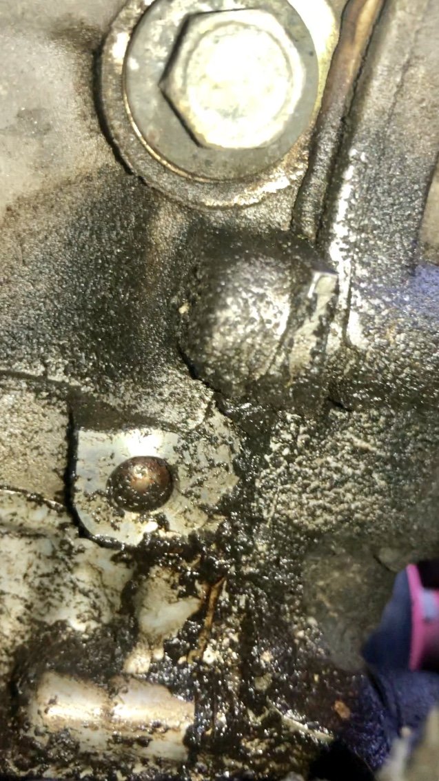

    B5A84147-B530-47C2-A73A-491A94BD4675.jpg May have been said in thread already but mine was leaking from the same area. Covered with oil and dirt from inspection plate to and past the notorious timing cover leak area. I cleaned everything off and seen it was the inspection plate itself From what looked like the metal gasket failured. Replaced it with ultra grey gasket maker and it’s dry as a bone. 3844E31C-861D-4F6E-9903-4216401D7E51.jpgFluids do strange things when leaking from engines being is there is a constant head wind and vibration. The typically don’t move up much against the force of gravity. So if the plate is oily and underneath good chance that’s the culprit. Unless your very unlucky and it’s coming from both spots.
