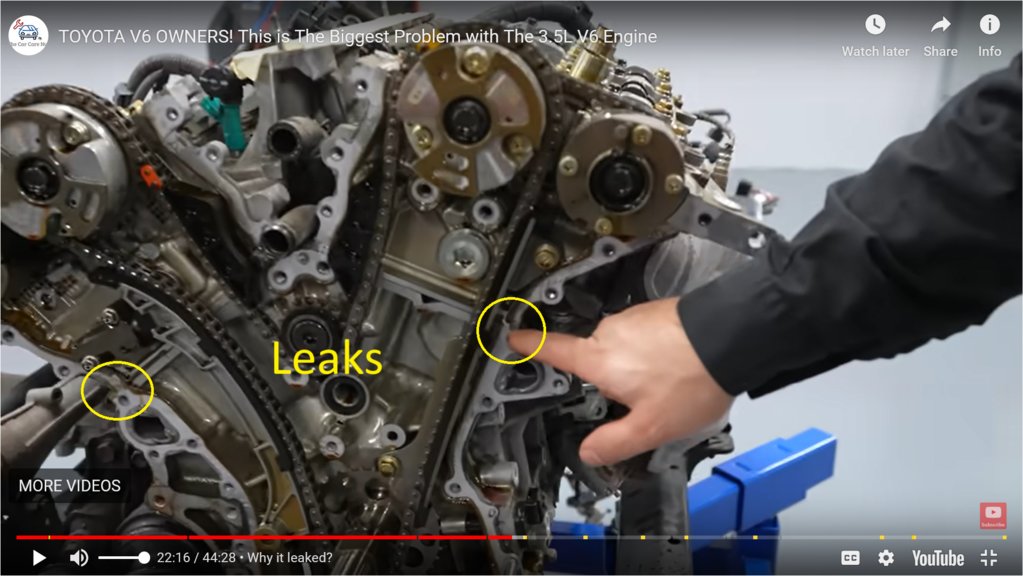

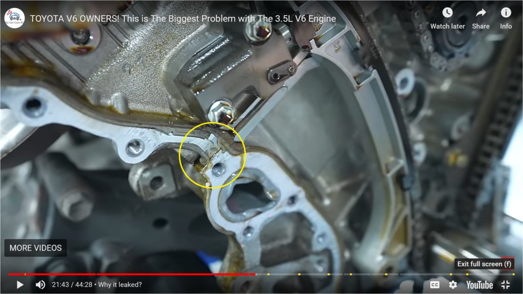

    ...If anyone didn't watch the video, here are where the leaks occur.
