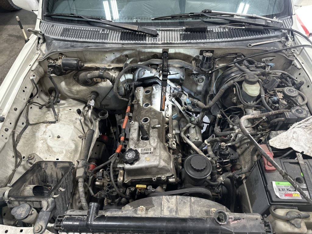

    And so it begins!

    Good luck! One thing I regret not replacing was the harmonic balancer when I did my timing cover.

    I didn’t get a new one. Maybe I should. I’m doing the balance shaft delete too.

    Whole lot easier now to do it than later. After all this time the rubber in the harmonic balancer gets old
