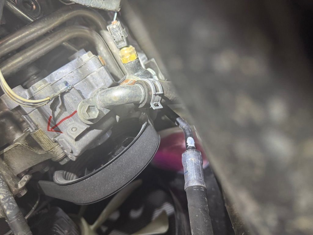

    upload_2025-2-3_15-57-29.jpgupload_2025-2-3_15-57-29.jpgIt’s not all over the place yet but there was one droplet hanging there with some black grime collecting on the tip like it had been there awhile before I swiped it.

    hard to tell in the pic but it was shiny and wet with a droplet hanging off with some black grime build up on the engine above it. Other than from this angle the engine is spotless

    ^^ Is this what you were going off when you determined the truck to have a timing cover leak???
    If so, delete thread and go buy truck...

    I like that answer....Yep I'm new to this truck. Engine oil leaking onto the power steering pump. Not the main symptom like other people posting about this?

    One single solitary isolated petroleum based droplet, on an otherwise immaculate engine?
    Myself, personally, I would have to say that's jumping the gun on the diagnosis.

    no there is oil on one side and part of the underside of the pump, oil grime on engine above, assuming it's the beginning of this problem

    Right, everything looks good until you get underneath and see the oil on the pump, on the engine right near it, and it was about to drip. So there's an oil leak. Is there another common cause of an oil leak onto the power steering pump?
