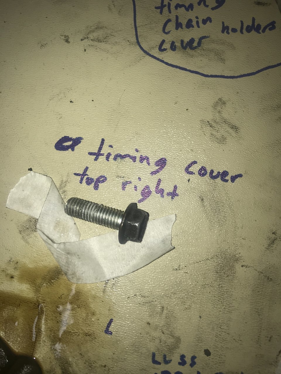

    Looks like it’s doing quite well at this point. Idle is steady about 750 rpms and cooling system is refreshed as well. And next week I’m gonna have someone extract that bolt for me cause I failed. Now there is one thing you might find interesting @craigs1 i have a single bolt left over that I found and I can’t for the life of me figure out where it goes. I had it labeled as “timing cover top right” and for some reason it was separate from all my timing cover bolts. I know this is a big mechanics fail lol rookie mistake right there for y’all.

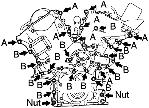

    Print the attached pic and verify all the bolts one at a time...you'll find an empty hole eventually.
    A is short bolt, B is long bolt.

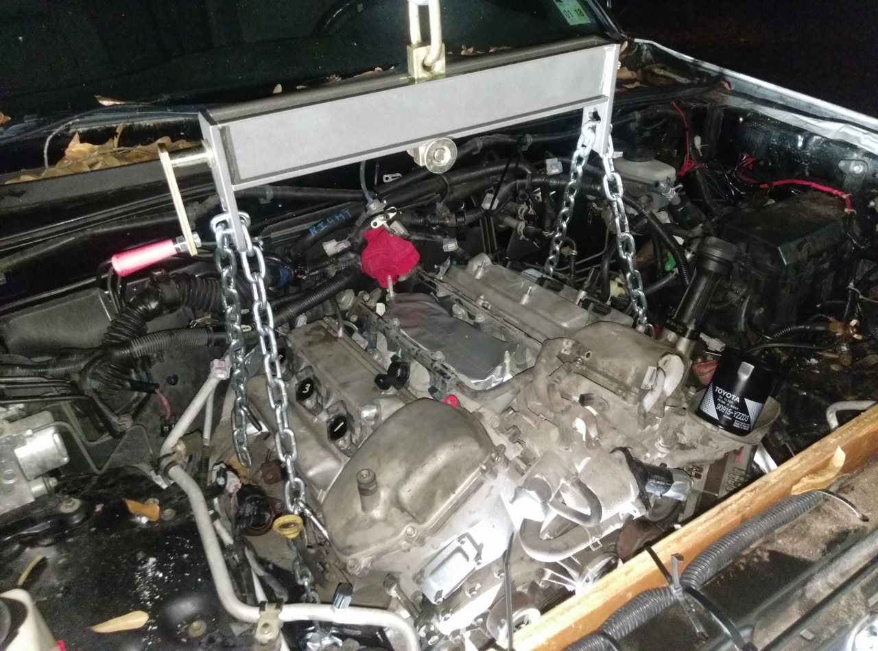

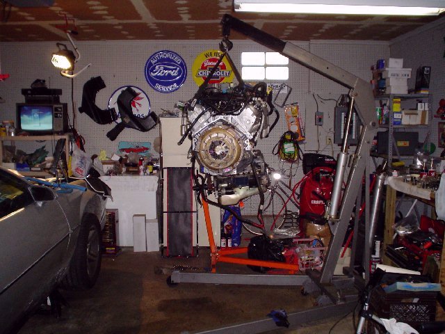

    Very nice rig, and great use of the wooden board to protect the AC condenser. No problems pulling engines here, done it on my Z28 three times over the past 18 years. For the timing chain job it just didn't add up in my judgment. For a cylinder head job...absolutely that engine would come out. In my case, I wasn't sure I could get the hoist high enough without removing the front wheels and lowering the entire front of the truck given my garage ceiling height...see pic below with the Camaro getting an LS1 swap.

    Nice setup! Yah, I had to put stock tires/wheels back on it and pull the engine with the truck outside, with host maxed out the engine just barely cleared radiator support.

    Not finished yet getting the Mac,s pivot plate engine leveler, fine tuned. It's for a Chevy big block. I've modified to fit. I wanted to try this kit after handling MY50cal's old engine with the intake box still on. Also like to figure if the engine /transmission can be pulled out together.
