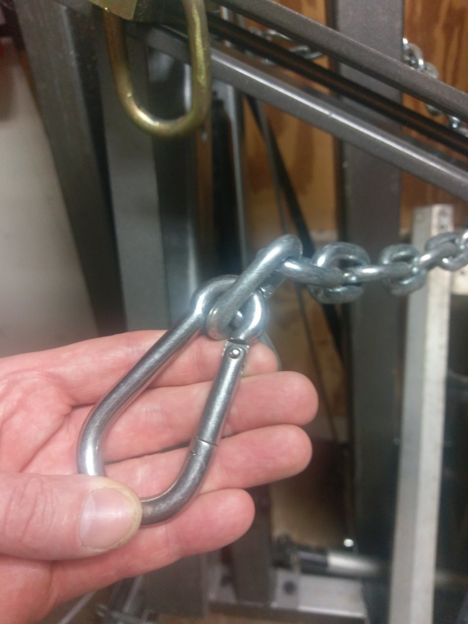

    For 1GR-FE, since engine hangers are impossible to find I use these clips, each is rated for 1000lbs, at home depo, about $15 each. 1GR-FE weighs about 500lbs give or take. IMAG0076.jpg IMAG0080.jpg 3 go on the holes on the block, the one on the left front, you have to use a bolt and washer. (sorry the pics aren't great, only engine I have in the shop is strapped down, but you get the idea)
    Also, using clips, you can adjust the height on the leveler by which link of the chain you clip on to.

    There are special order Toyota lifting hangers available.
    They are in the service manual:
    Hanger no.1 12281-31060
    Hanger no.2 12282-31040
    Bolt (90119-08177) qty:4
    Torque to 24 ftlbs

    I am fully aware, I have the manual. Try to find some, then get back to me :)

    I went to a local Toyota parts counter to buy and was told the hangers are available only to in house techs.
