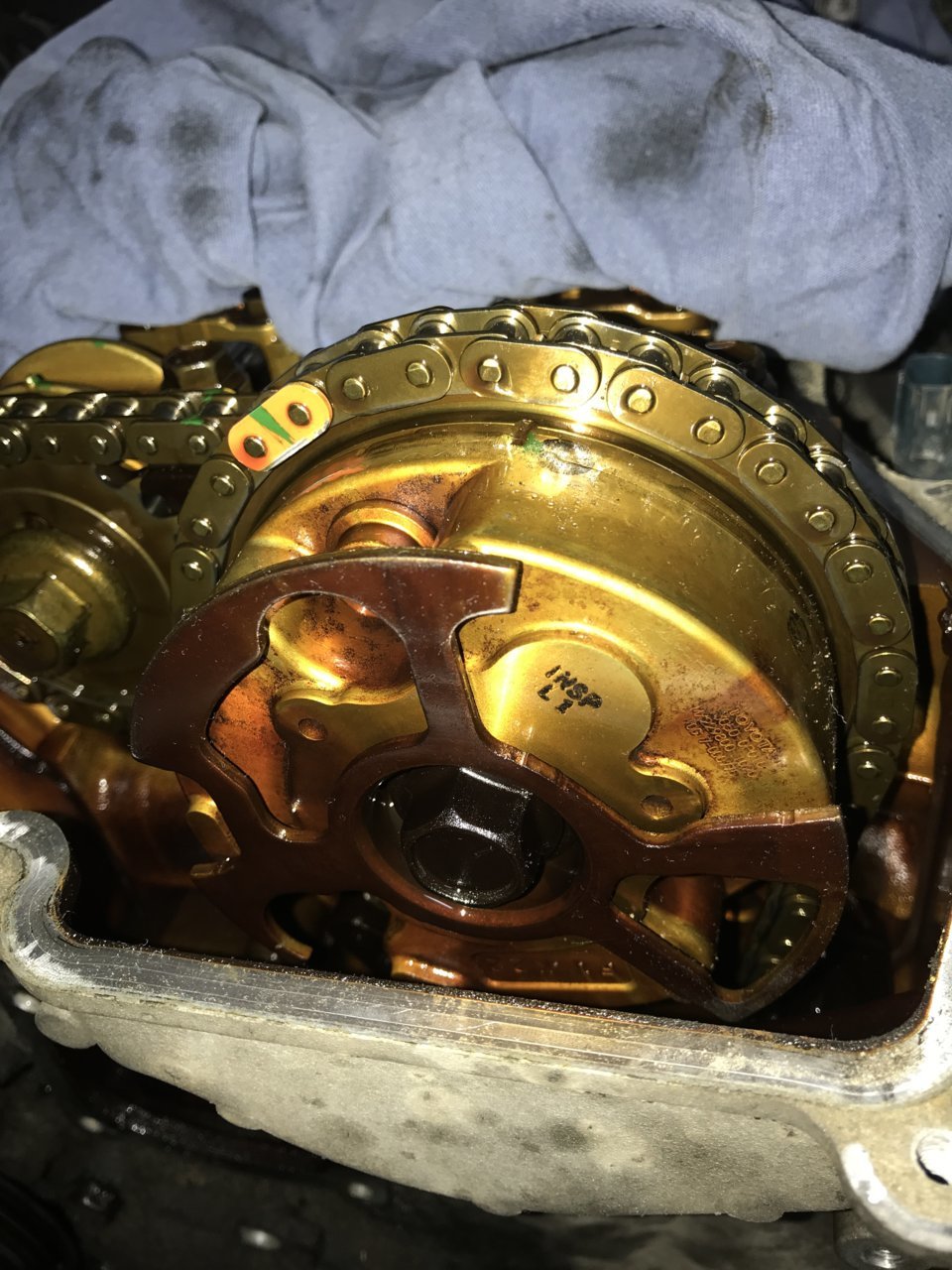

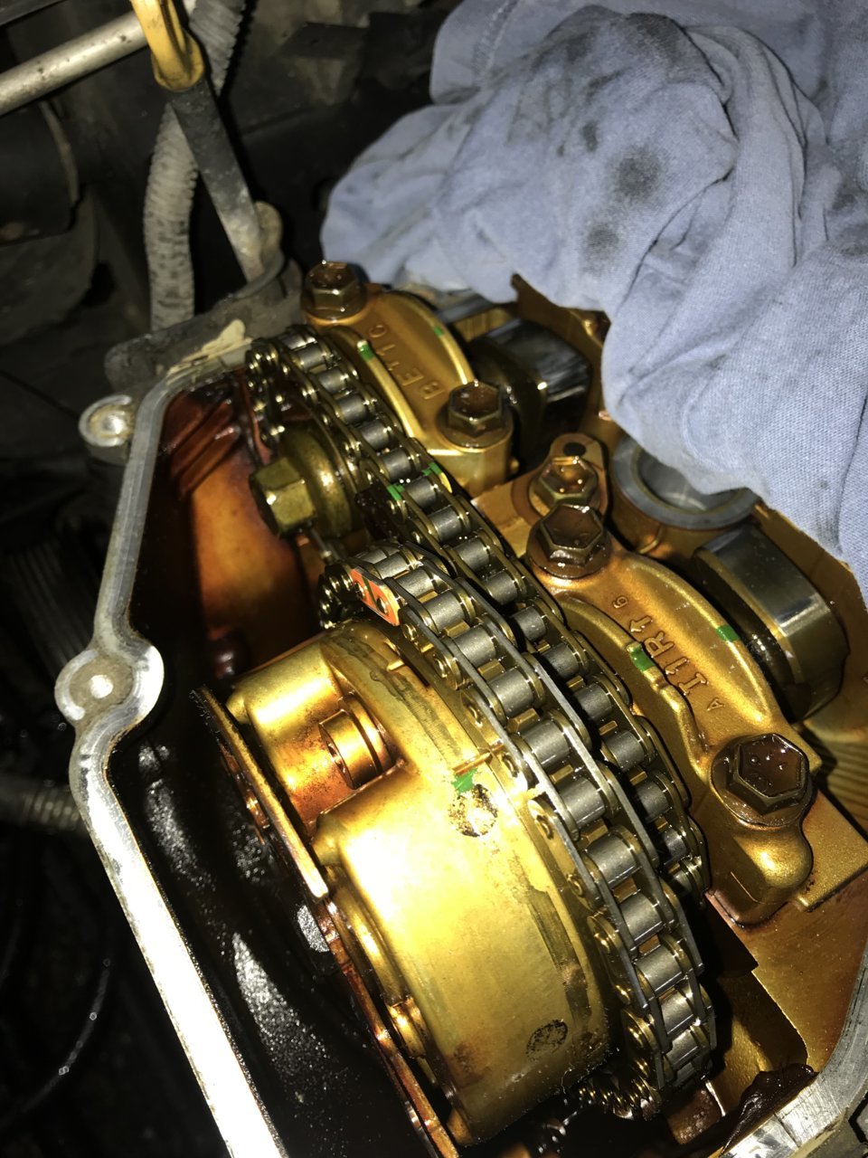

    This is with the crank at zero. Both chains seem tight on both sides and I don’t see any damages. But none of the green tick marks line up at all. Any idea of what actually happened to the chain? Is it just stretched possibly? I’m gonna continue tearing down the motor

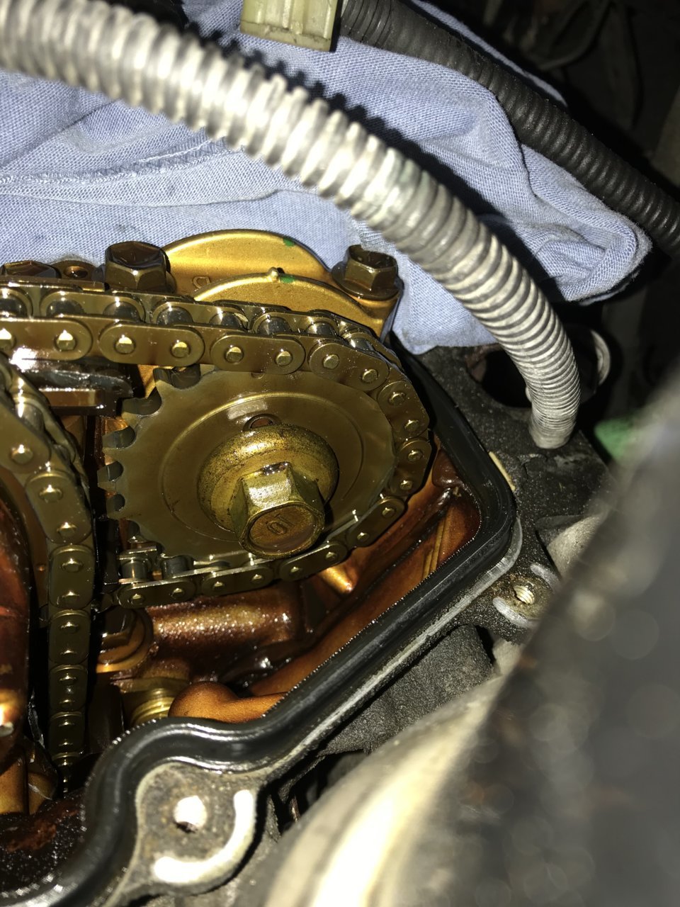

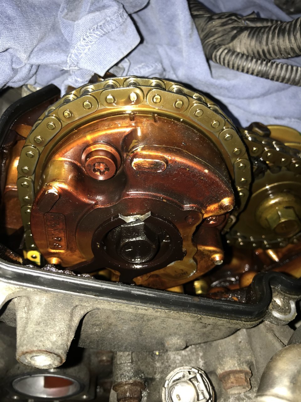

    I don't know about the 4.0 but usually once you time an engine and spin it around once, the timing marks don't line up anymore.
    What's with the actuator in the 3rd pic down? Looks like there's a piece broken off.

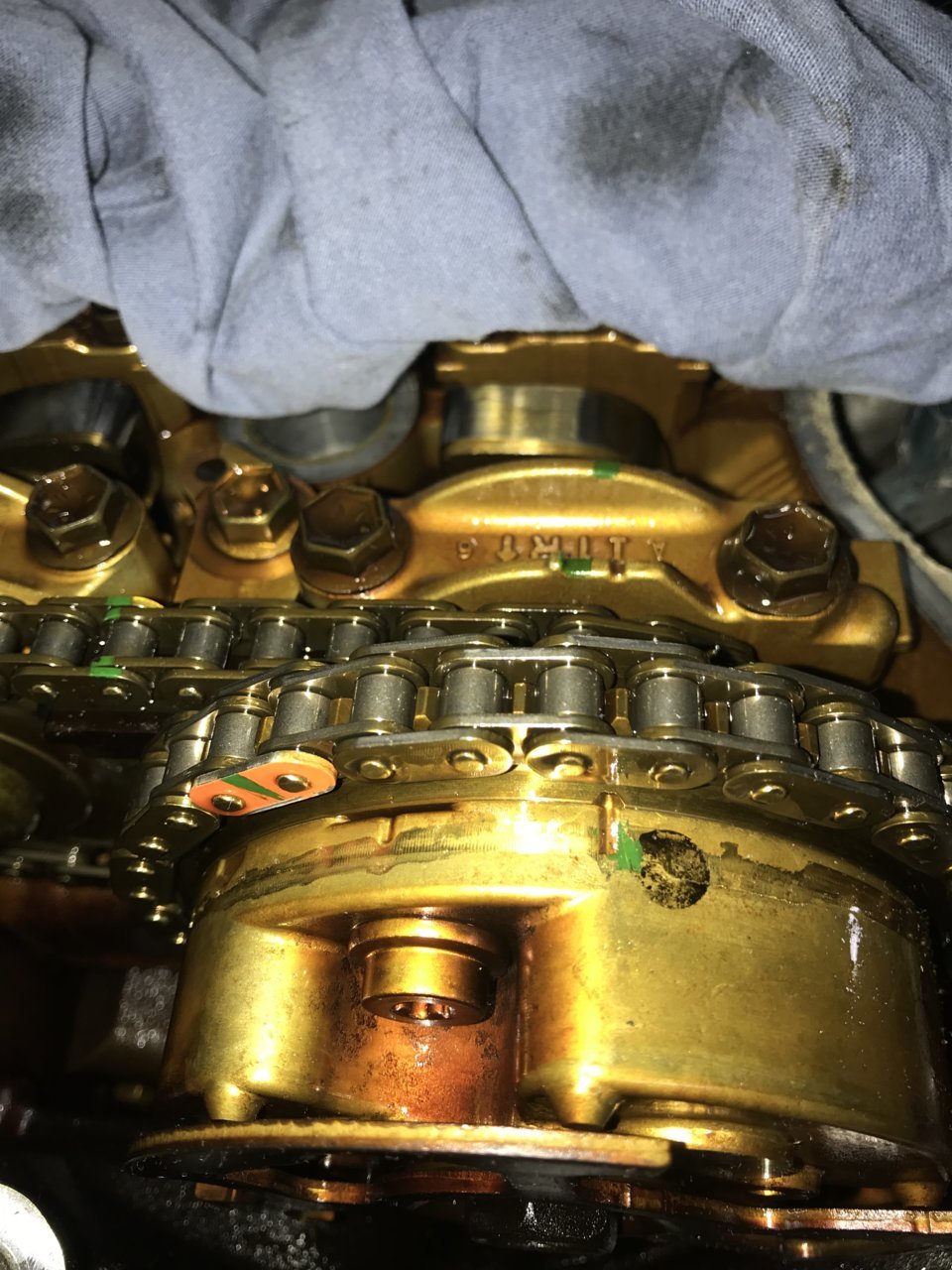

    Passenger side (bank 1) cams are right on the money. The bank 1 intake cam aligns with the indented mark on the bearing cap as shown in the procedure I linked...not the raised mark on the bearing cap.
    Driver side (bank 2) cams are off by 1 tooth on both the intake & exhaust sprockets...the short chain didn't jump, your big #1 chain did. Re-timing the #1 chain on the intake cam will correct both. There's a procedure to "inchworm" the chain back into place, I'll dig it up and post it.
    The big question is how it happened...was it making any rattling noises while running?
    edit: here's the entire thread on the FJ forum, read the whole thing including his "inch worm" process to skip his intake cam back one tooth.

    Shit you’re exactly right. Not even sure what to do now knowing that’s broken off. Next step?

    The chain isn't stretched enough to need replacing, unless you end up pulling off the timing cover in which case it's an easy "while you're in there" project.
    How the timing wheel got broken is a mystery, and if the broken piece(s) are still inside the engine you'll want to get them out...timing cover comes off. On the other hand, as Pickeledpigsfeet asked, if the dealer tech had the valve cover off and broke them, you'll want to find out where the broken pieces went. Check your receipt to see if they had the valve cover(s) off, and talk to the service dept in the morning.
    You'll need a 24mm wrench (long overall length is best) for turning the cams manually. Crescent wrench as the shop manual shows is not advisable.
    That timing wheel is pressed into the VVT actuator/sprocket assembly and they're replaced as a single unit. $180 for the Toyota part at wholesale if memory serves. There are aftermarket chinese ones if money is really tight.
    My next step would be to remove the #1 chain tensioner *carefully*, stuff a shop rag under it inside the timing cover to prevent the bolts or tensioner from falling inside the engine. You can rotate the intake cam backwards just a tiny bit to introduce slack in the timing chain, making the tensioner easier to remove. You can then examine the tensioner ratchet mechanism, and the teeth on the plunger, to see if it failed. The little pivot plate rotates upward to unlock the ratchet, you can slide a plastic tube from a spray can into it and the hole to lock the ratchet open.
    For inspection of the tensioner, I'd unlock the ratchet and press the plunger all the way in, then release the ratchet while holding the plunger in. Then gently let the plunger extend outward, one tooth at a time, and press back in to verify the ratchet locks. You can also let the plunger fully extend, and examine the ratchet teeth for any that are broken or otherwise damaged.

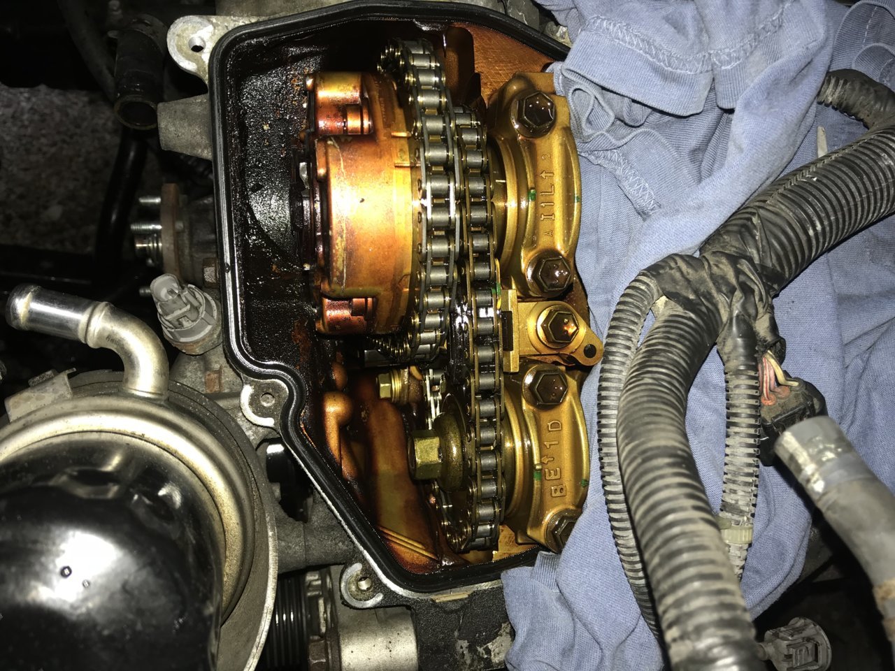

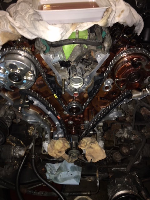

    Below is a pic of my engine w/ the timing cover off, when I replaced the chains/sprockets/guides/tensioners last month. Look down from the tops of each bank, and examine the black nylon guides on the inboard sides just below the intake cams. Basically make sure they're still there and didn't break off.
    Then look down the outboard side of bank 2 (driver side) intake cam to verify the metal guiderail and nylon slider is still there.
    Also look around hard for the broken piece(s) of that timing reluctor wheel...you might be able to fish them out with a magnet and avoid removing the timing cover.
    The intake cam VVT actuator/sprocket can be removed and replaced without removing the timing cover, it's in that shop manual link. Need a 17mm offset box wrench, no space for a socket. Also need the 24mm open-end wrench I listed earlier to hold & rotate the cam.

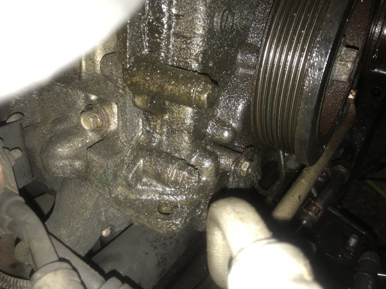

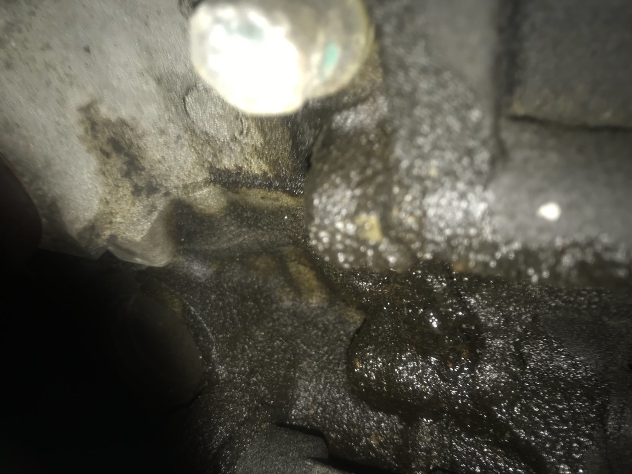

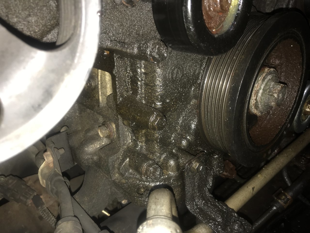

    This is right above the power steering pump where the timing cover meets the engine. I’m afraid I’m going to have dive in on this one
