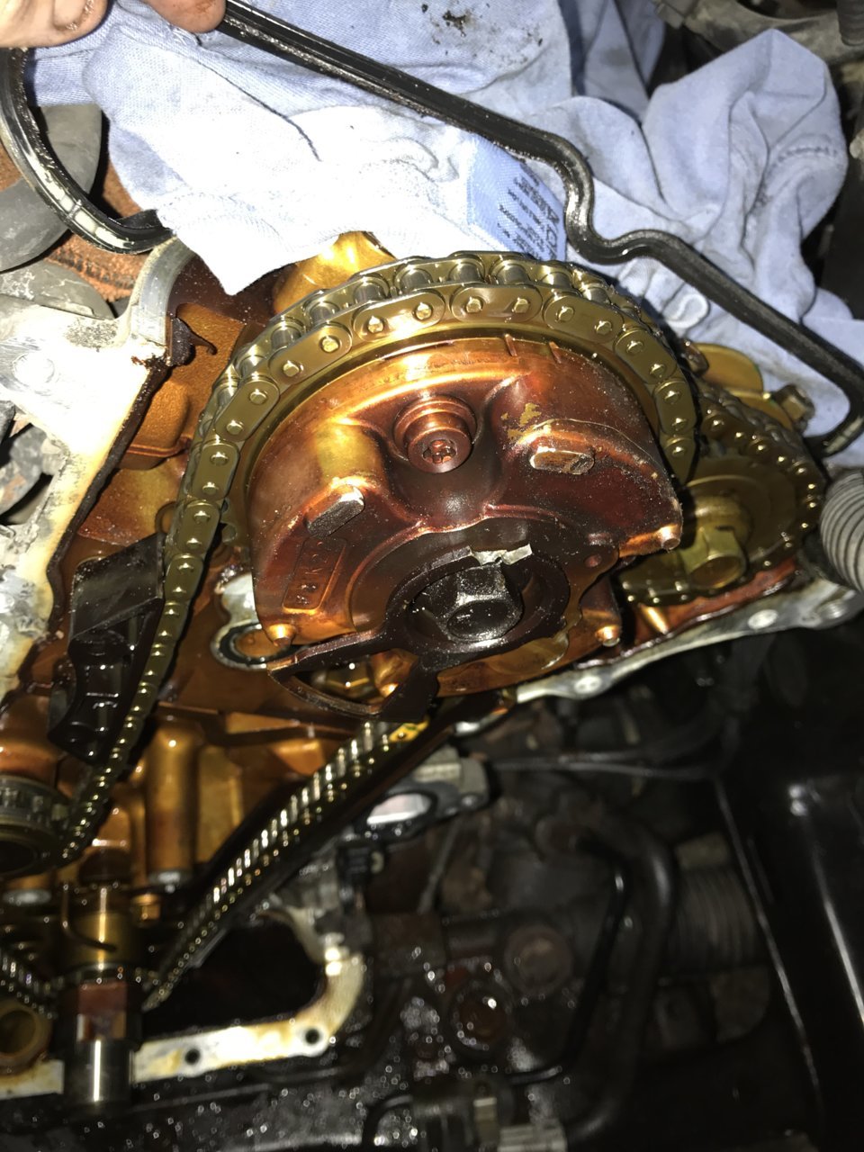

    Did you buy it new? That engine was not taken care of. Discoloration and burnt oil build up on the inside of the timing cover. Also the pad on the tensioner on the left Cam chain looks worn (better pic would help). I would change it anyway, last one I bought was only $70 OEM. Also change the timing chain guide, right side, bottom of the timing chain, big long guide. When you have it apart clean the hell outta everything.
    You have any pics of the inside of the valve covers? Any sludge? Oil doesn't disappear, if it was low, it went somewhere.... Obviously some gunked up on the inside of the timing cover.
    Chains should be fine to reuse. That's the least of your worries.

    Timing chain replacement at dealership is wayyyyyyy more than $1500! Gasket kit alone will run $400 (OEM).

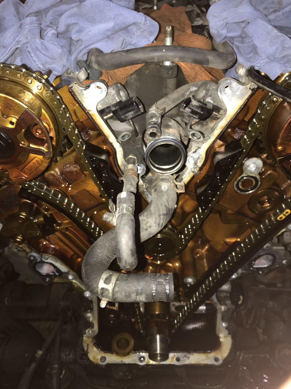

    While I’m out at the auto parts store I just wanted to be sure what all gaskets I’ll need to purchase to put this all back together? The water pump seems at have some sort of gasket riveted to the timing cover and also what sealant can I buy locally at the auto parts store that I will need?

    The sealants are listed in my notes above, however I used Permatex Right Stuff Gray in a cheese-whiz can for the main cover FIPG instead of the Toyota stuff...easier to apply in a uniform bead. I did use the Toyota coolant-specific FIPG for the water pump passages thru the timing cover, expensive stuff. Also used Permatex "Aviation" sealant to lock the main oil pump pickup o-ring in place and minimize risk of it falling out during assembly.
    The water pump gasket isn't riveted to the timing cover, it's a multi-layer steel gasket and the rivets just hold the layers together.
    I bought a gasket kit under Mahle part # CS54462 that had all but the intake manifold base gasket and oil filter housing o-ring seal...bought those separately.

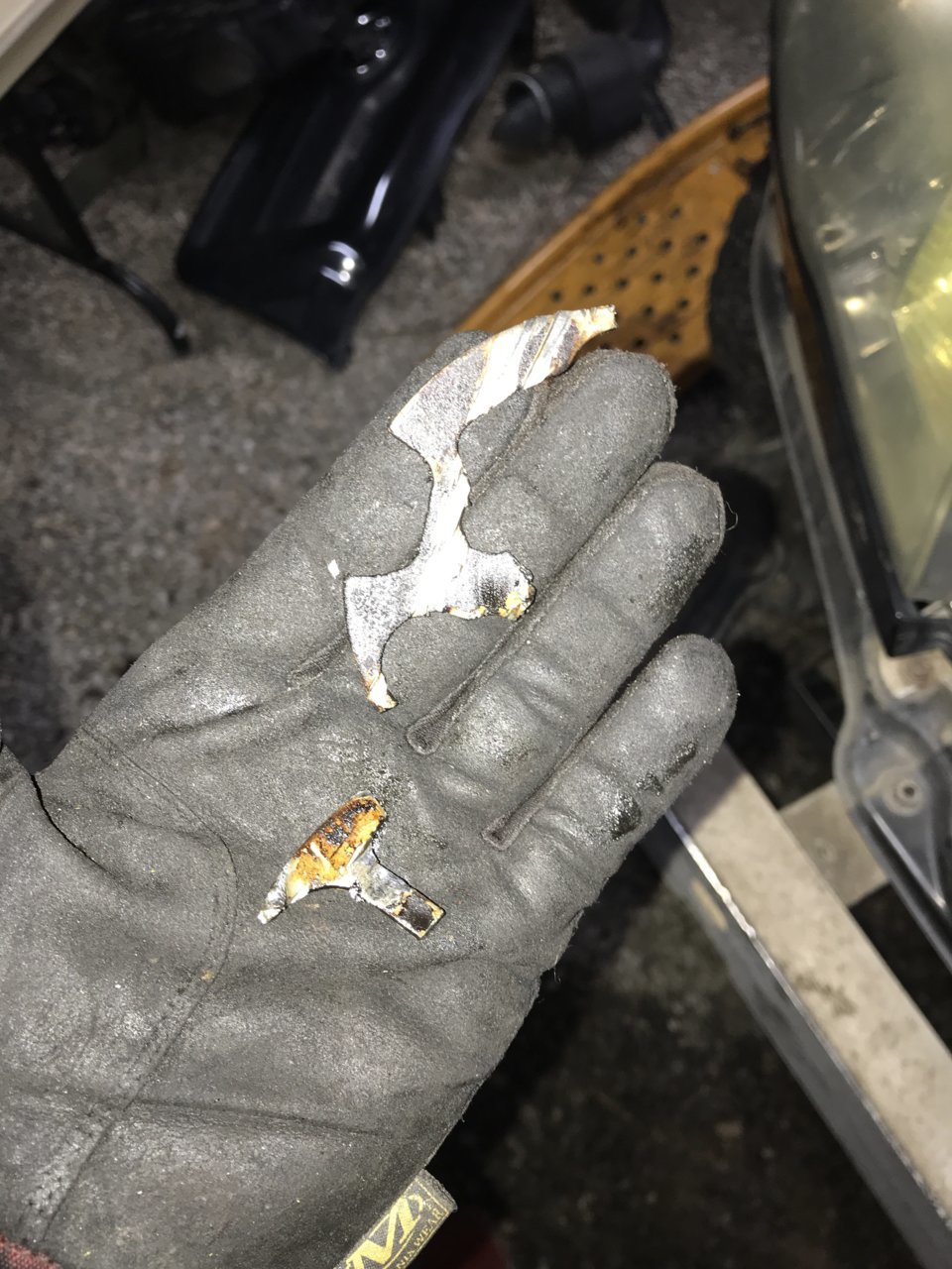

    Here are the broken metal pieces from the reluctor on the camshaft actuator. Thankfully found them. Chain is tight and all guide rails are tight. What’s my next move to get the drivers side back in time now?

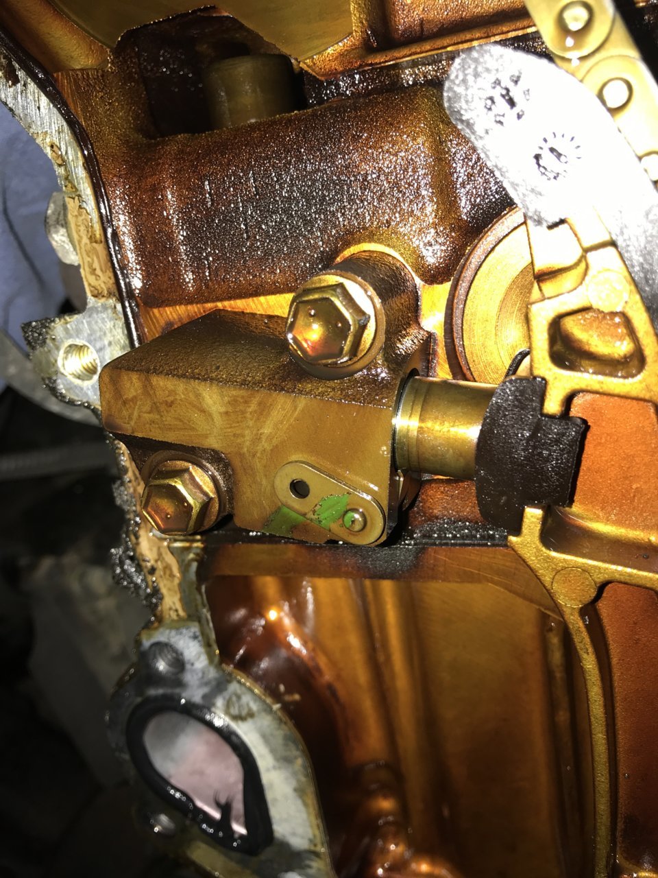

    Also will I need a new tensioner or does this one look ok?

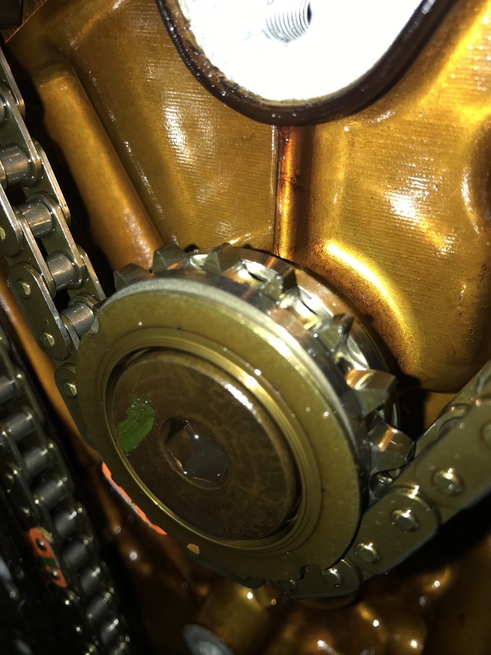

    Also wondering if the teeth look worn on this center sprocket in the last pic
    Biscuits likes this.

    Out here in retail land where we have to warranty stuff, all that crap would get replaced. Chains, tensioners, guides, etc.
    IMO it should get at least chains, tensioner(s), and the actuator with the broken reluctor. The crank sprocket is probably ok. Check the guides really good.

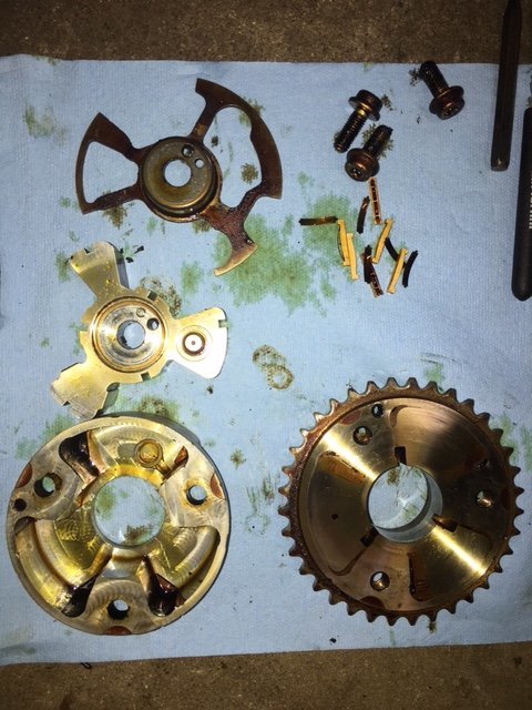

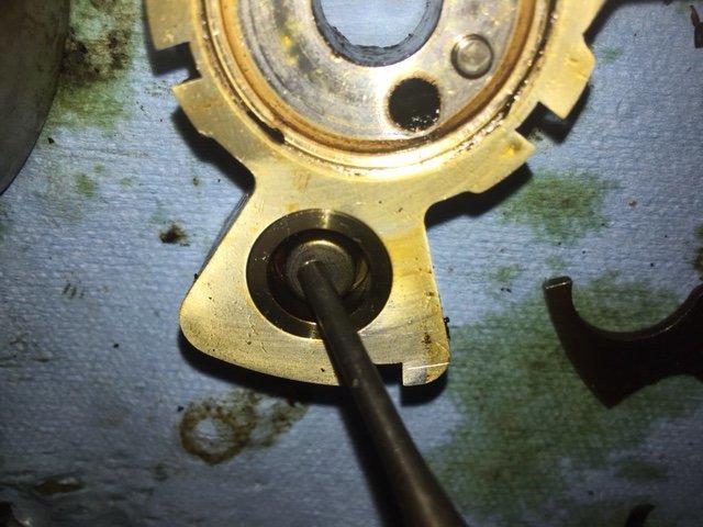

    You'll be removing the #1 tensioner whether you replace the chain or re-time the existing one at bank 2 intake cam sprocket, so it's a good opportunity to examine the ratchet mechanism...we still don't know what caused bank 2 to break the timing reluctor wheel and jump a tooth. You can likely reuse the guides and black plastic dampers, examine them for wear and make a decision. But I'd replace the #1 tensioner whether it checks out or not.
    That long shiny line on bank 2 actuator near the failed reluctor wheel running parallel to the sprocket teeth...is that a scratch, or a crack in the housing? It's getting replaced regardless, but if it's a crack that may be a clue as to the failure.
    Get at least 2 cans of brake parts cleaner spray and a bronze wire brush (not steel wire) to clean the timing cover and block/head sealing surfaces. CRITICAL: stuff a rag in the oil pan and cover the oil pump pickup (round hole at front of oil pan) with masking tape so no debris gets in there. That black bead of old FIPG sealant needs to be completely removed in order to get a good seal during reassembly. Most of it will pull loose by hand. Don't use a metal scraper, the block and timing cover are soft aluminum and will damage easily...thus the bronze wire brush and do it by hand, with final cleaning using the brake parts cleaner spray and a clean towel.

    In my experience, loss of oil pressure to the tensioner is what allows the chain to jump time.
    Visually check oil pickup tube for blockage, check oil pressure soon after getting it back together, and above all check oil level frequently!

    On this engine model, the #1 chain tensioner has a ratchet mechanism to maintain position of the piston. Loss of oil pressure won't cause it to retract, unless the ratchet mechanism has failed. The two #2 chain tensioners between the intake & exhaust cams, however, have no ratchet and rely on oil pressure to remain extended against the chains.
    If the shiny line on his VVT actuator is a crack, my theory is that a loss of oil pressure allowed the actuator vane assembly to slap around inside the housing while the engine was running. The vane slamming into the housing may have cracked it and expanded it enough to press against the reluctor wheel with enough force to break it. It's a theory. I disassembled the one I removed from my engine, pics are below.
