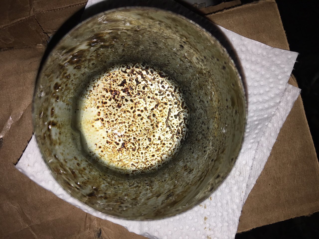

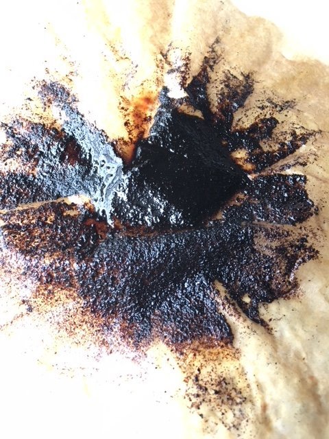

    Short version: Oil contamination due to excessively-long change intervals killed this chain.
    Long version: The original owner had the oil changed at average 22K mile intervals. It originally lit the Check Engine light at 96K miles with P0016 error code, Toyota records show the dealership quoted him a new engine. So he kept running it and changing the oil at stupid-long intervals until he couldn't get it through state inspection, then dumped it on Craigslist for cheap. Still had the factory mix of NGK and Denso spark plugs in it at 163K miles, and it ran well despite this.
    I made a lowball offer and bought it last year as a project assuming I'd be swapping the engine for a junkyard replacement. But after removing bank 1 intake cam and cleaning out the VVT oil passages, replacing the VVT oil filter screen & #1 chain tensioner, and walking the chain back 1 link on bank 1...it ran very well. The bank 1 intake cam bearing gaps mic'd within service tolerance spec.
    So I ran Pennzoil High Mileage 5W-30 in it through the Fall-Winter-Spring and changed it at 2000-2500 miles to slowly break up some of the sludge, had two Blackstone Lab used oil analysis runs to confirm the engine was otherwise in good shape, and then replaced the timing kit this Summer. I put over 12K miles on it before the timing job, only reason I opened it up was what I thought was off-idle "engine noise" which turned out to be 2 worn-out serp belt idler pulleys. These are remarkably tough engines.
    EDIT: pics of one of the oil filters used over the Winter showing sludge it caught. Bottom pic is where I dumped the filter canister contents through a coffee filter:

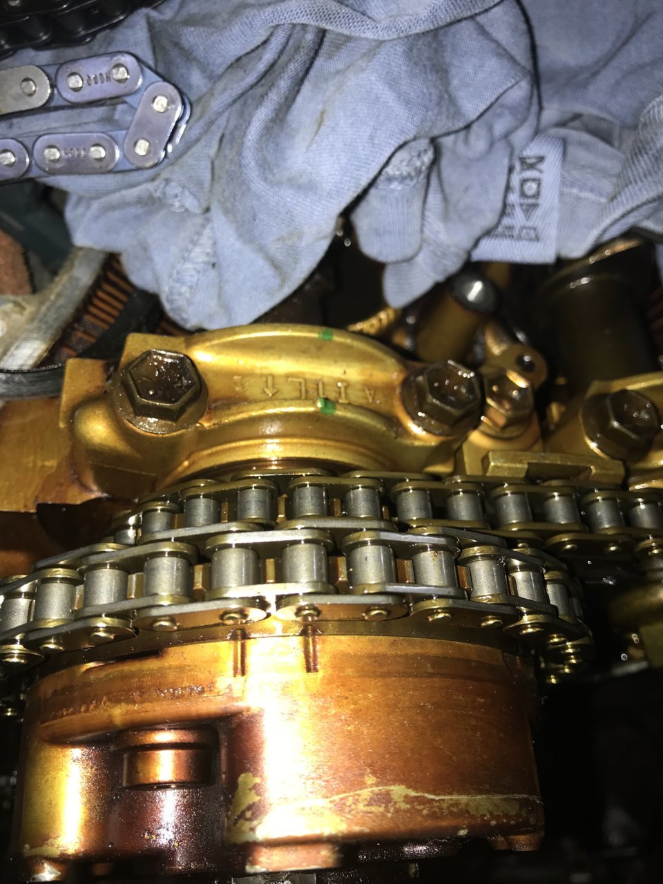

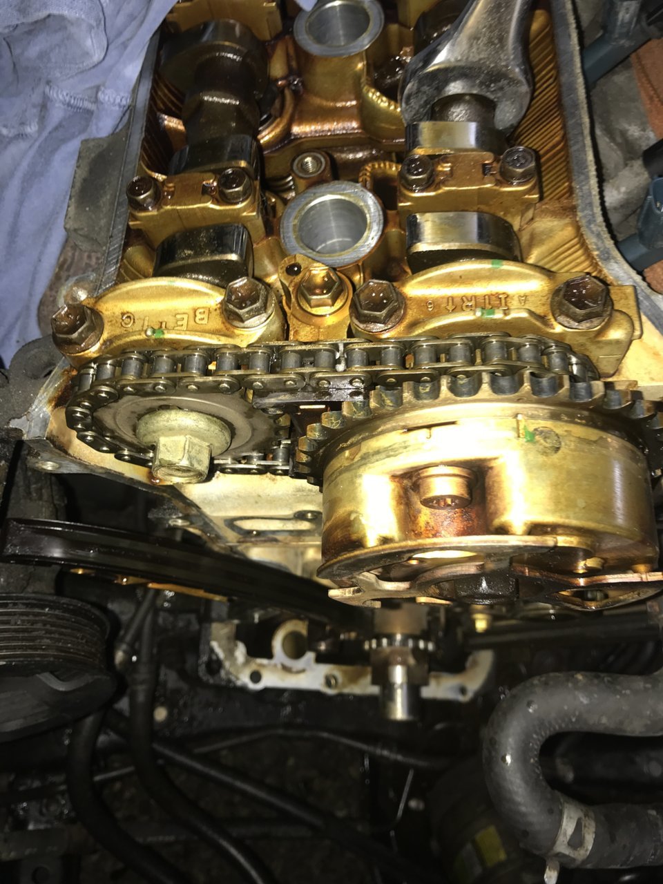

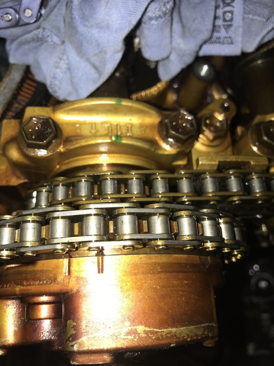

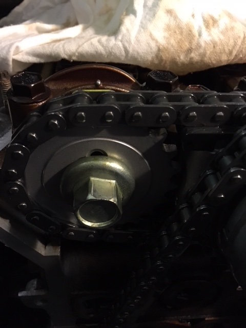

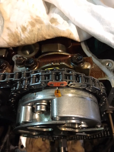

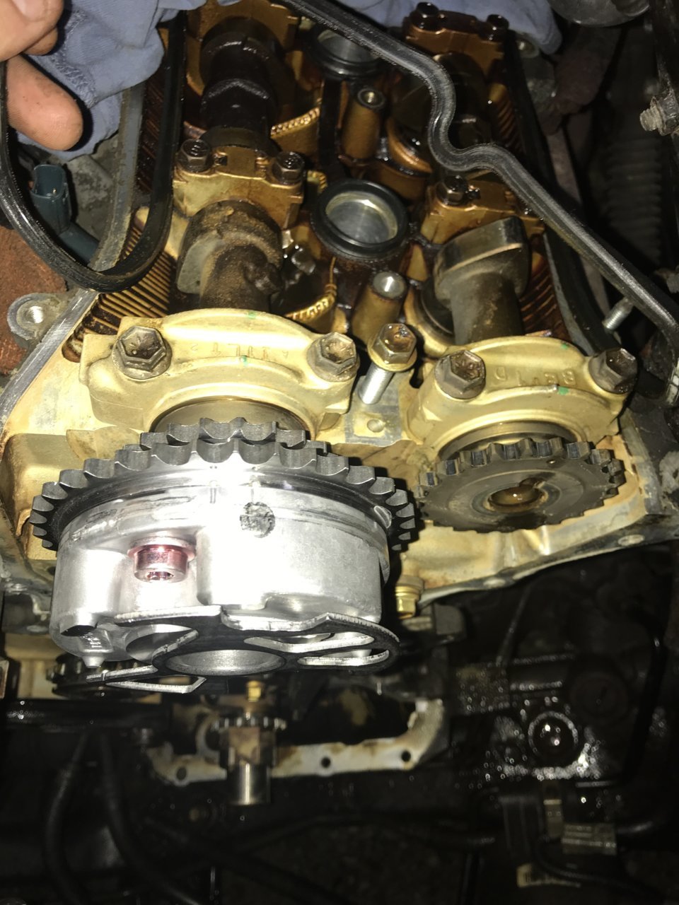

    Sorry for the delay just now got all the parts in. As far as putting the new chain back on, where do I need to line up the marked links on the chains themselves? And as far as the driver side, how far do I need to rotate camshaft and intake sprocket to be on set?
  15. Aug 18, 2018 at 3:19 PM
    #95
    craigs1
    craigs1 Well-Known Member
    Sep 9, 2017
    #229508

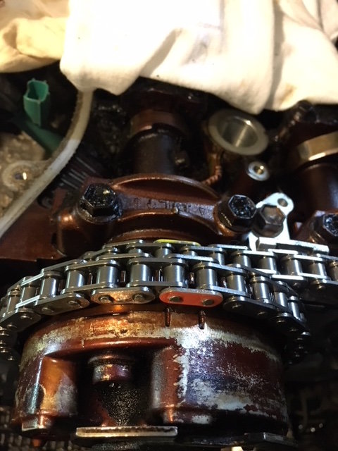

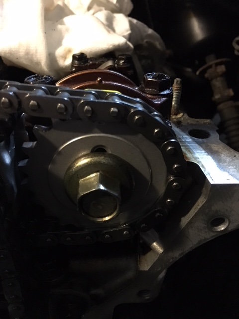

    253
    2007 4Runner Limited, 4.0L
    Timing marks are covered in the shop manual link I posted. Current marks are as effed up as a football bat, and you didn't show the crank. Pull up the shop manual, get all 5 sprockets lined up exactly right as shown, and then rotate the crank 2 full revolutions putting the crank reluctor wheel dot back on the block casting mark, and re-verify all sprockets are on the right marks.
    Once again, the shop manual page w/ the timing marks: https://www.customtacos.com/tech.ol.../06toyrm/06toypdf/06rmsrc/rm2006ta/007003.pdf

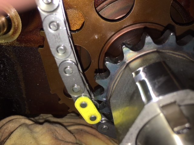

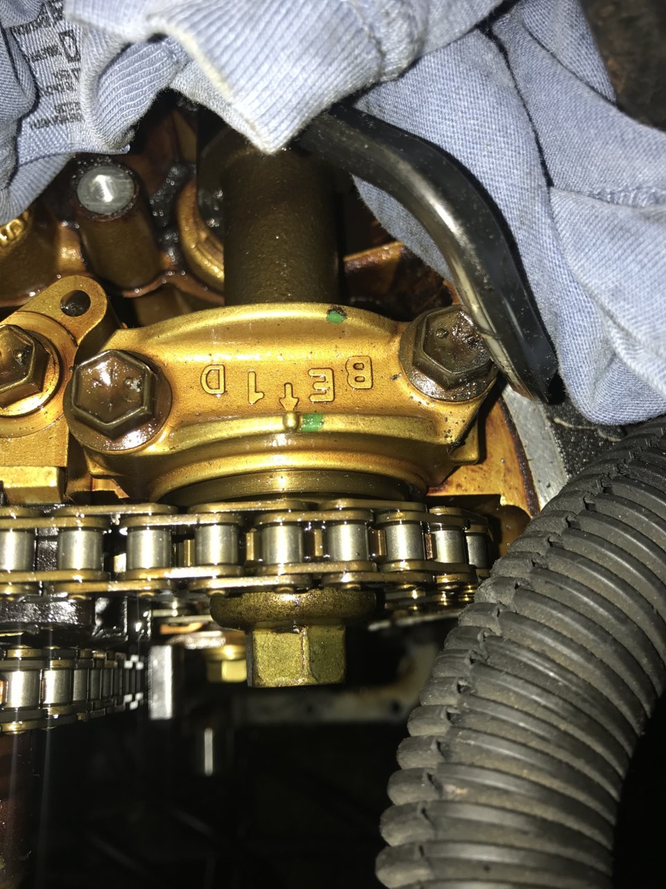

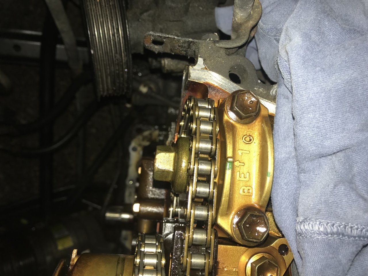

    Follow the manual (except for installing the #1 tensioner first, it goes on last after the idler sprocket) and they'll look like this with the new chains and color-coded endplates in the right places:

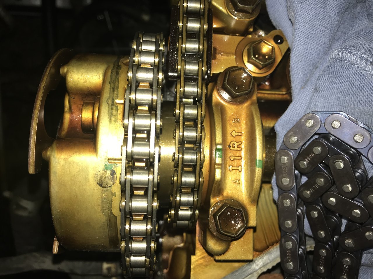

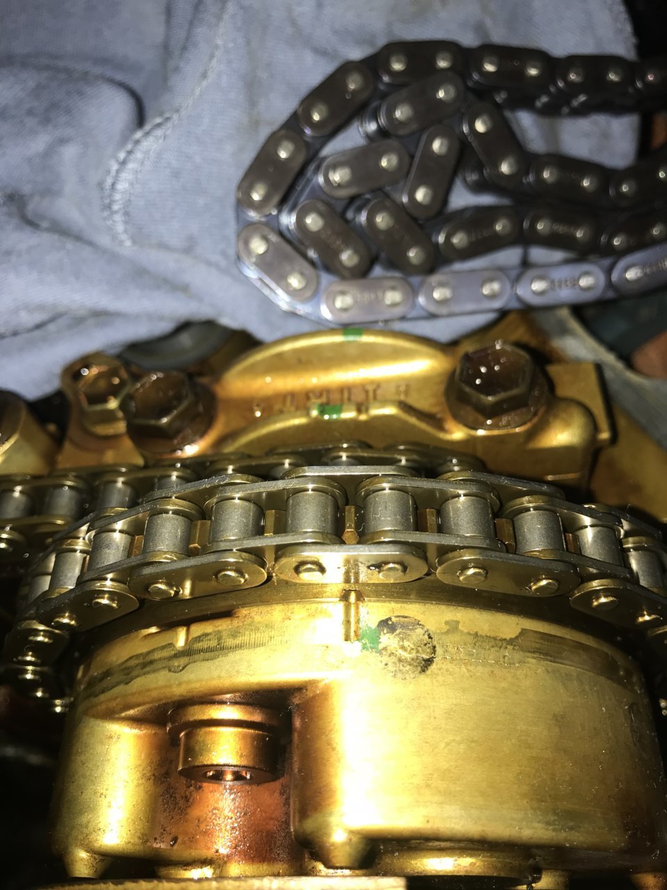

    Ok It looks like I’ve got the cams lined up as they should be and I’m almost poster the crank is set at 0 degrees. It may have move a smidge but can’t tell with the timing cover and crank pulley off. Now I’m just struggling with chain placement

    Looking much better, be sure to oil the new sprocket teeth and soak the chains in oil before you hang them. No dry parts.
    Does your new chain have color-coded link plates for the cams and crank sprockets?

    2006 Tacoma TRD Off-road 4x4 V6
    Yes sir they do have off colored links on them.

    Then read the shop manual page I linked, it covers where the colored plates go. My pics also show placement.
