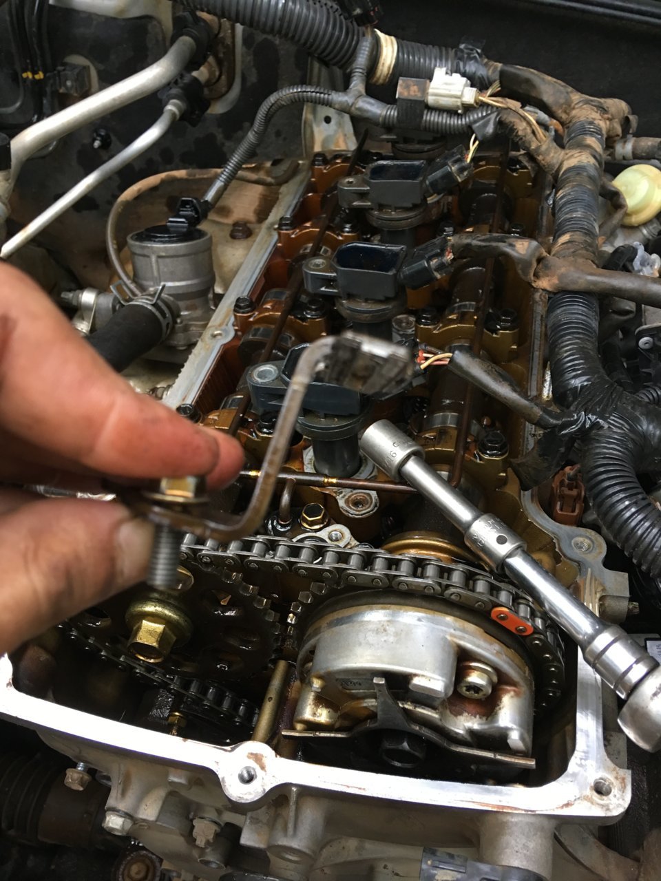

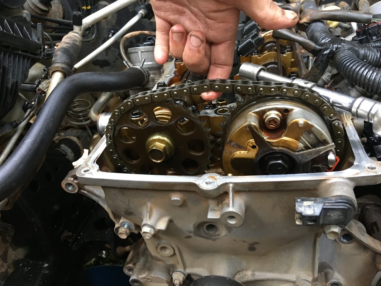

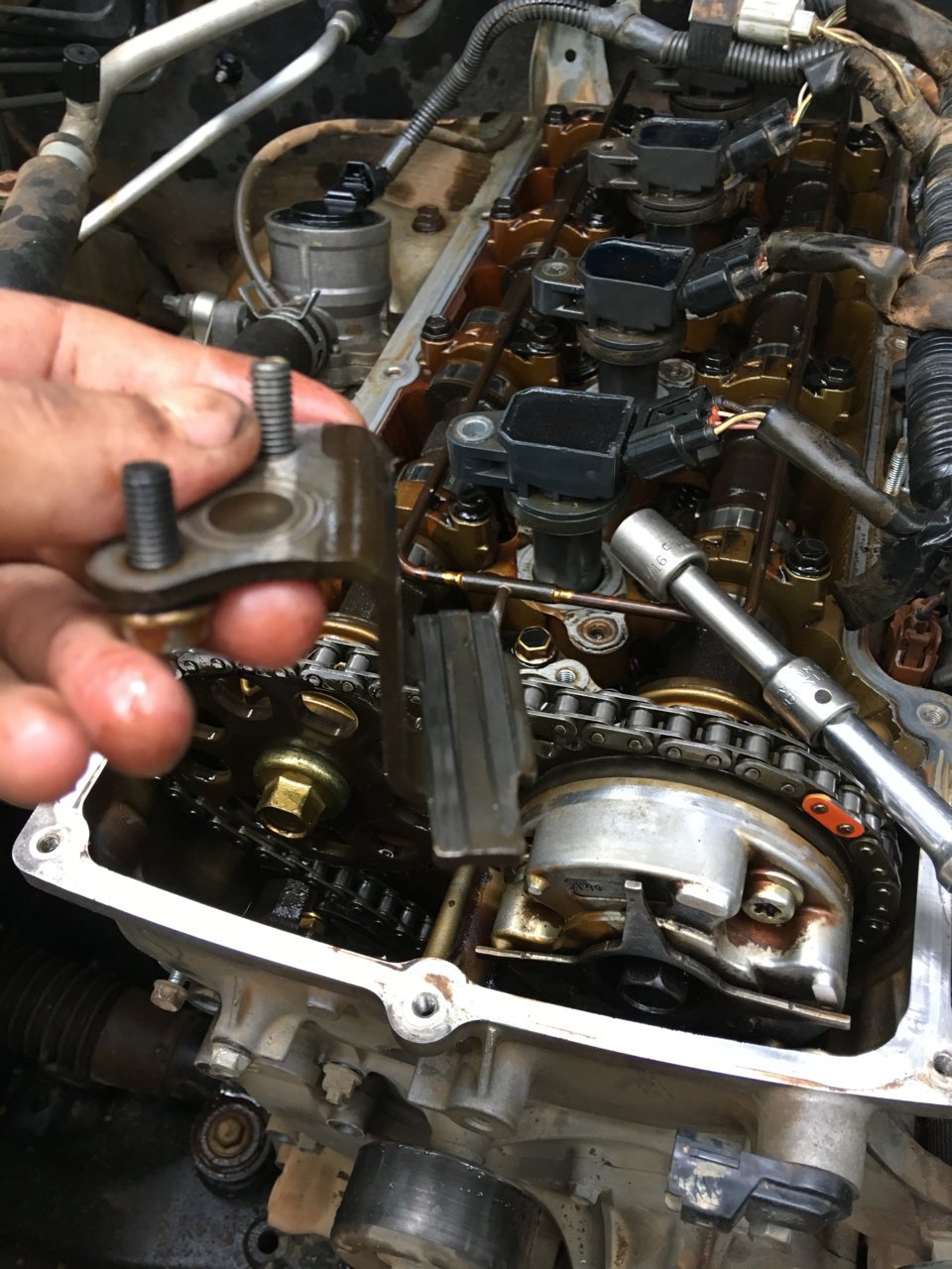

    loud knocking at front of motor (2.7 vvt-i dohc), also it had a very loud squal when i crunk it up before i took off the vavle cover. dont know where it was coming from, thought it might have been a cam bearing. pulled vavle cover and found the top timing chain guide was grooved and eat up. the timing chain tensioner is not keeping pressure on the guide where it rides. i have not worked on any newer toyota tacomas before any suggestions would be great for taking off the timing cover and anything else that might make this easyier. thank you in advance for any helpful info i can get on this repair.

    Pics would help see what the problem is specifically

    Will get this to my son in-law so he can post pics, it's his truck I'm just trying to help him. Thank you

    Wow, there should be a plastic backer on that. Definitely time for replacement.
