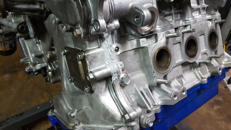

    Yeah I got up under there with engine degreaser and a rag n spray bottle of water and cleaned underneath. I can't get down to it from the top to scrub off the top end. Would I be able to hit it with degreaser and a hose to clean it? Then seal it with a sealant? Thanks for the kind replies. I'm just trying to get another 100-200,000 out of her. Other than this issue she runs like a dream

    I have that photo.

    Here it is. I also have the other ones showing the uneven machining which causes the leak.

    17
    Somar
    Raleigh NC
    2005 yota coma pre
    That looks so much more efficient! Yeah the issue would be accessing it for me. Like you said tho I could probably move the radiator to have a clearer look at it. Is there any draw backs to putting sealant there?
