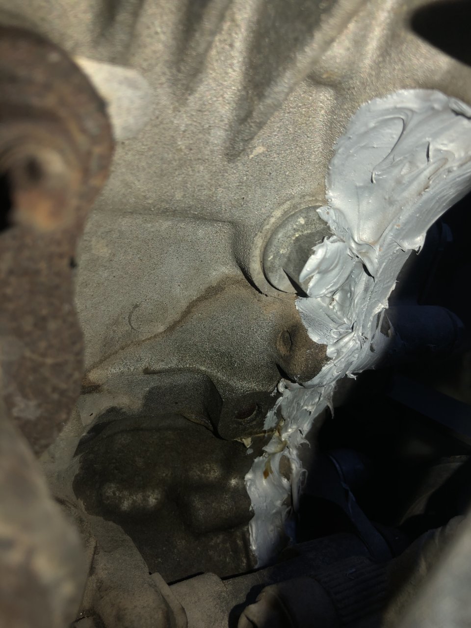

    I used this stuff from Permatex a few months ago in that area. Still dry as a bone.

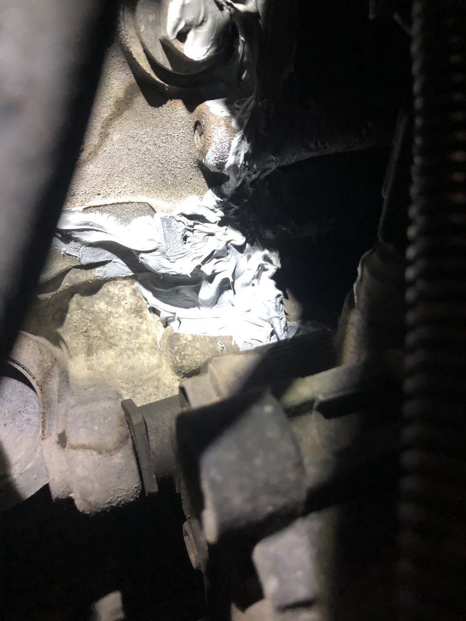

    Got the job done today. Took no time at all. Will keep the group updated on how it holds up.

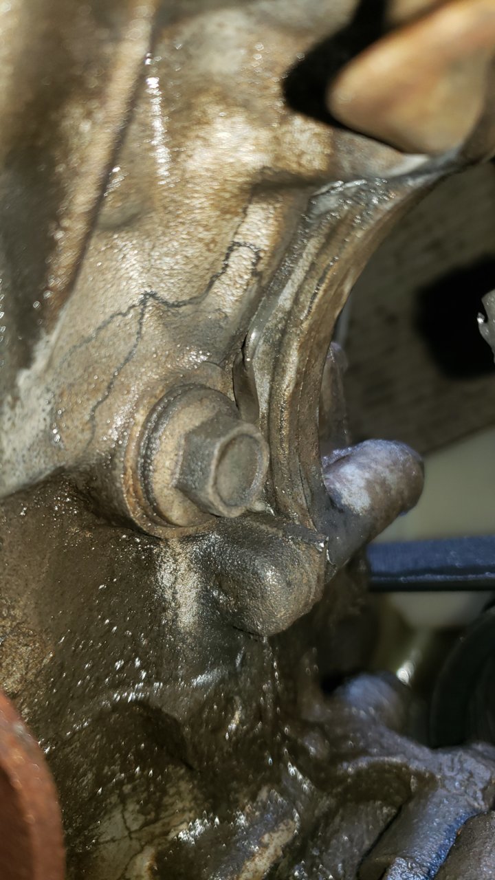

    So the leak is coming from here now (or always has been). Anyone know what might be causing that?

    Sprayed it down with brake clean, then watched it start leaking from there? Nothing higher or somewhere else?
    If so. Then that is the head gasket.

    3 inch lift Toytec Ultimate Coilovers Deaver Stage 3 leaf pack Camper shell w/ Prinsu Rack and RTT Maxxis Razr MT 285/75/16
    Idk, what do you think?

    Can see the point of the leak right here.
    Need to clean it up, and re-apply.

    Exactly what I did 15 minutes ago. Hopefully it does the trick this time.

    This is the spot where the depression in the timing cover that leaks is, which you refer to. :thumbsup:

    Drove to Moab and back. No leaks.. did the trick!

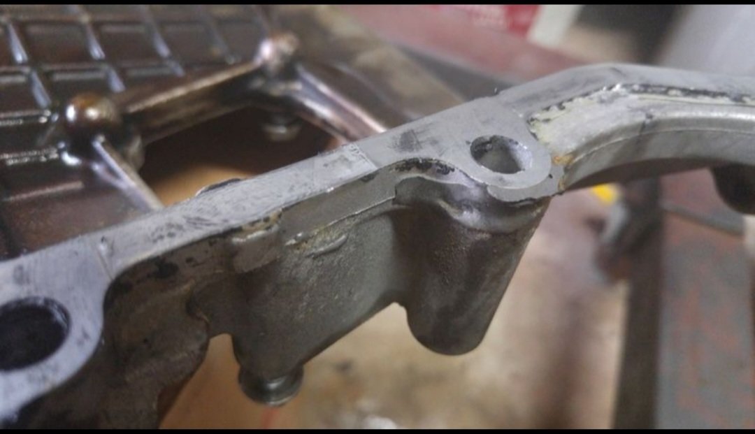

    wow, definitely looks like a manufacturing defect.

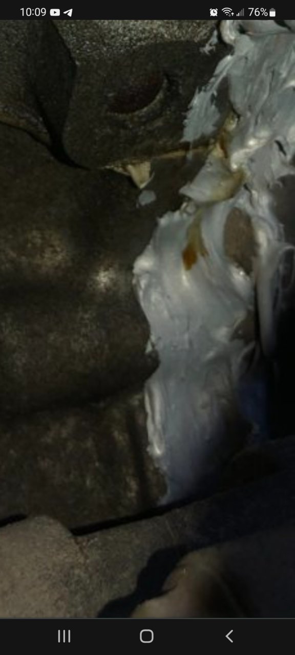

    Resurrecting this. Was starting to clean up in preparation for this. Is this old rtv that pushed out?? Does this just make it a full remove and reseal?
