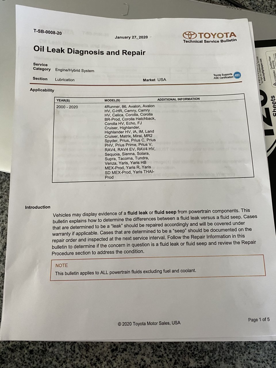

    Update:
    I had a long visit with the dealership yesterday and they are now telling me the 90 day “powertrain” warranty only covers break downs not leaks. They offered to split the cost, still costing me over $1500.
    I spoke with the shops service manger who has 40 years Toyota maintenance experience. He told me he did not think it was worth the money or the risk to repair such a small seep. He has techs that have 20 years experience in the shop, but conceded that any time you pull an engine and perform that extensive of a repair, something else could go wrong. He said the seeps normally do not get much worse
    I am going to monitor the seep for now and maybe give the permatex route a try.
    Pretty disappointed in the dealership since they tout how thoroughly they go through their vehicles and then not going very far to make it right if there’s an issue. I learned my lesson and will be getting my own inspections on anything I buy going forward.
    The final offer the dealership made me was for a 5 year /60k Toyota platinum warranty for $1710. I am currently deciding if that is worth the money. The manger told me this would cover the timing cover if I decided to fix it later.

    I’ve heard from some techs that this is absolutely becoming more of an issue in 3rd Gen’s. Not widespread, but not unheard of either. Depending on the leak, if the seal is compromised only an inch or so, they do NOT have to remove the engine to fix. Can be accessed through the passenger side fender wall.
    I’m curious what corporate would say if someone’s leak was so bad it compromised the motor and the owner wanted a new engine ?

    their is an argument from most dealerships you should be prepared to hear. See below
