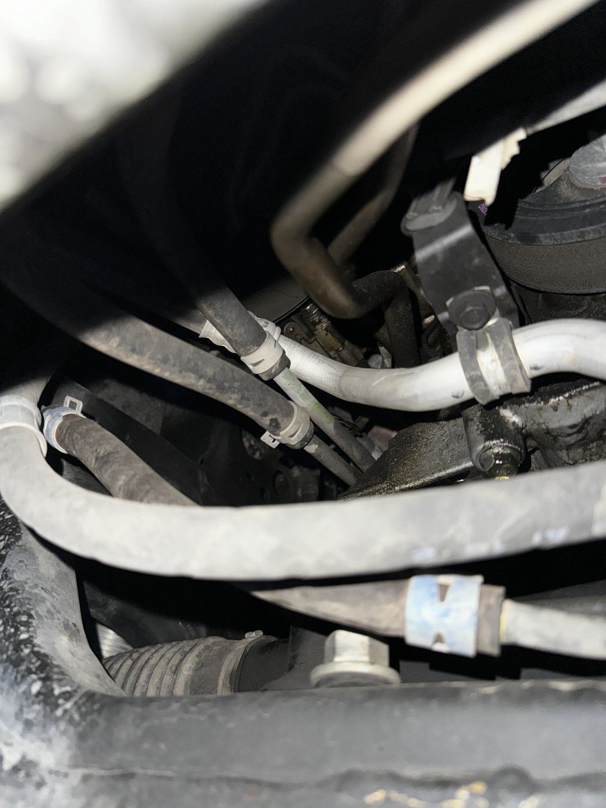

    So from what I gather the leak occurs mostly at the point where the Head, top end, and Timing cover meet. It can also happen in the same area on the Drivers side but not as frequently. Hopefully mine just remains a very slow seep, but I will say it has really bothered me, because when I bought it I really went over it pretty good. I brought my flashlight with me and inspected the bottom and top of the engine and still managed to miss it. Who would have thought that a Toyota with only 19k miles would already have an oil leak? Evidently this is very common, and I just think most people dont know where to look, haven't bothered, or miss it all together like I did.

    If you happen to watch the Car Care Nut on youtube (Probably one of the better skilled to speak on this issue), he mentioned that all it takes is someone touching that area during install leaving oils or finger print to make it not seal. Im sure that has something to do with it, but the leak always seems to occur in the same area right behind the power steering pump where 3 different sections join. Regardless I think this is enough of an issue that Toyota needs to formally address given the amount of work/cost involved to fix.

    I had mine leaking right there too behind the pulley at 18k miles but it was a residue of dirt and oil and barely a fresh drip starting... I watched it for a few months and it returned, showed the dealership some pics and they fixed it no questions asked. Now my truck feels tighter and more crisp all around after they fixed the leak and with the shifting from D to R to P, the clunking metal noise went away... which was nice since I brought it in for that horrible noise at 5k miles haha. Feels like a lexus now.....really almost like a different truck. Super glad I got it done

    When you got the PS pump out of the way to apply the permatex were you able to just get the pump out of the way without disconnecting the fluid hoses? It looks like I might be able to just remove the pump and hang it out of the way with the lines still hooked up but I’m not sure yet.

    My 2016 is leaking same place just gonna live it. It's not dripping on the ground. 52k
