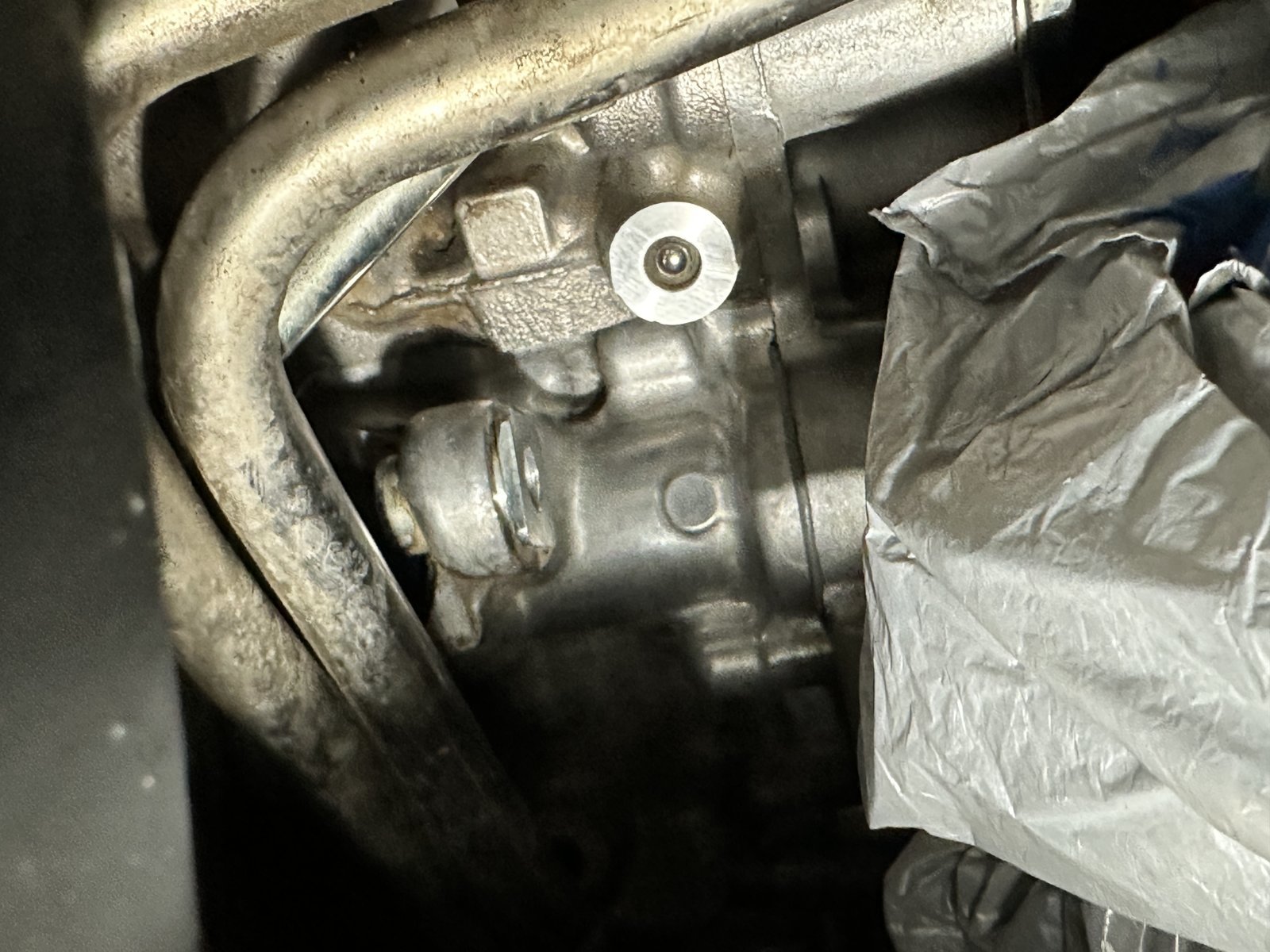

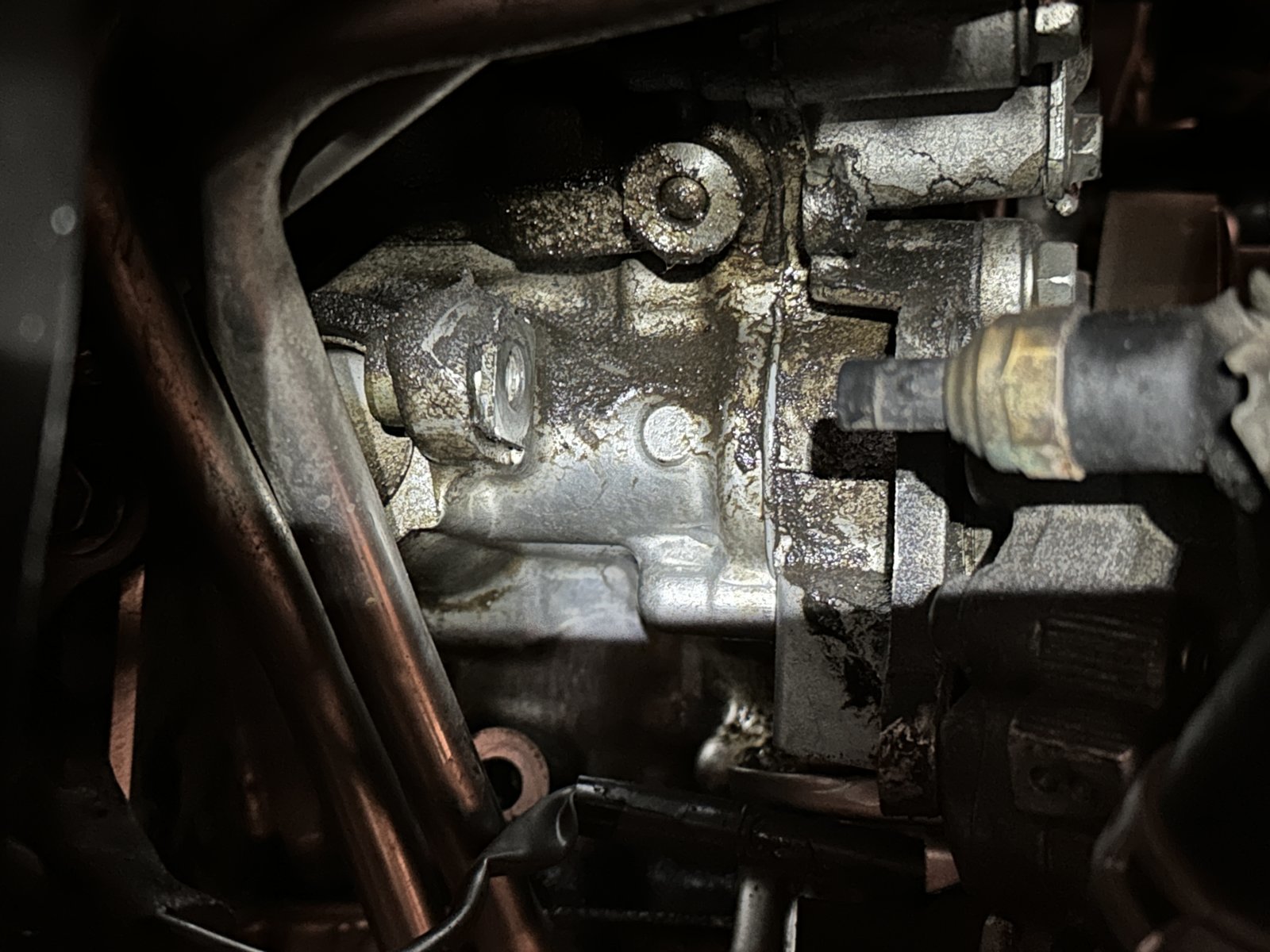

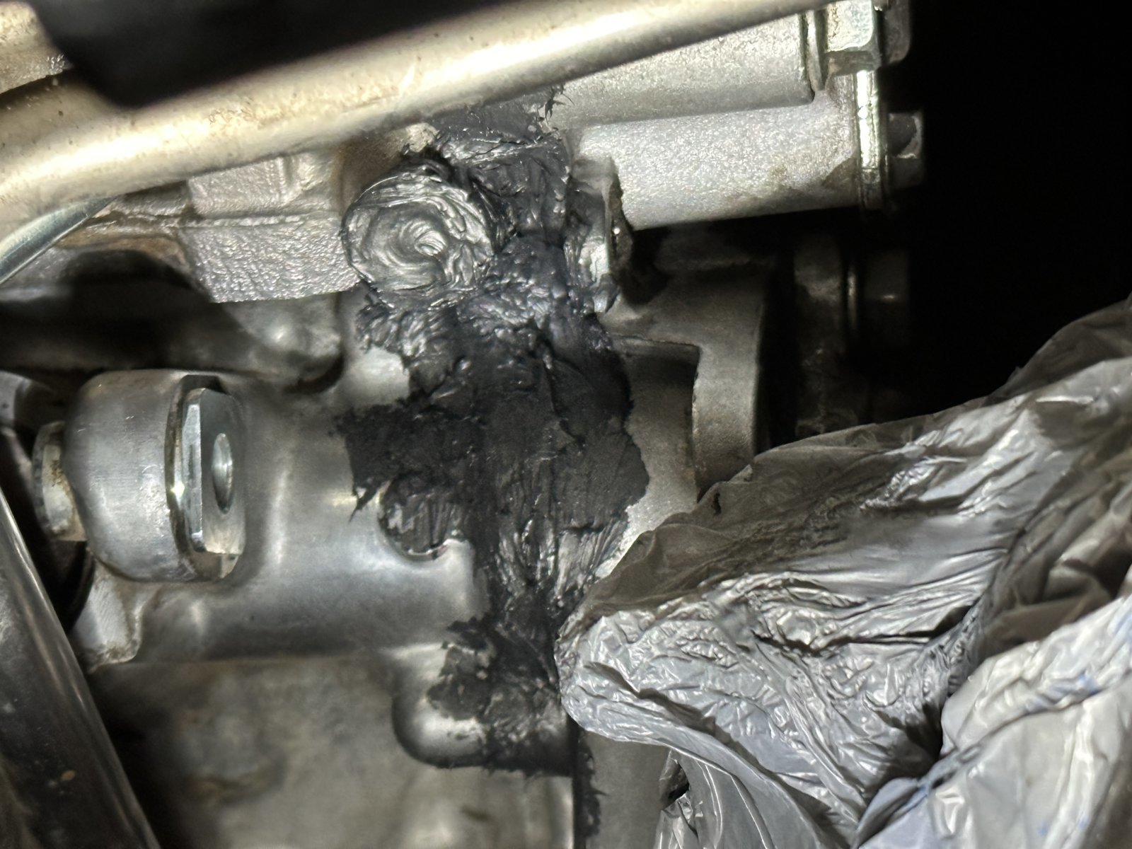

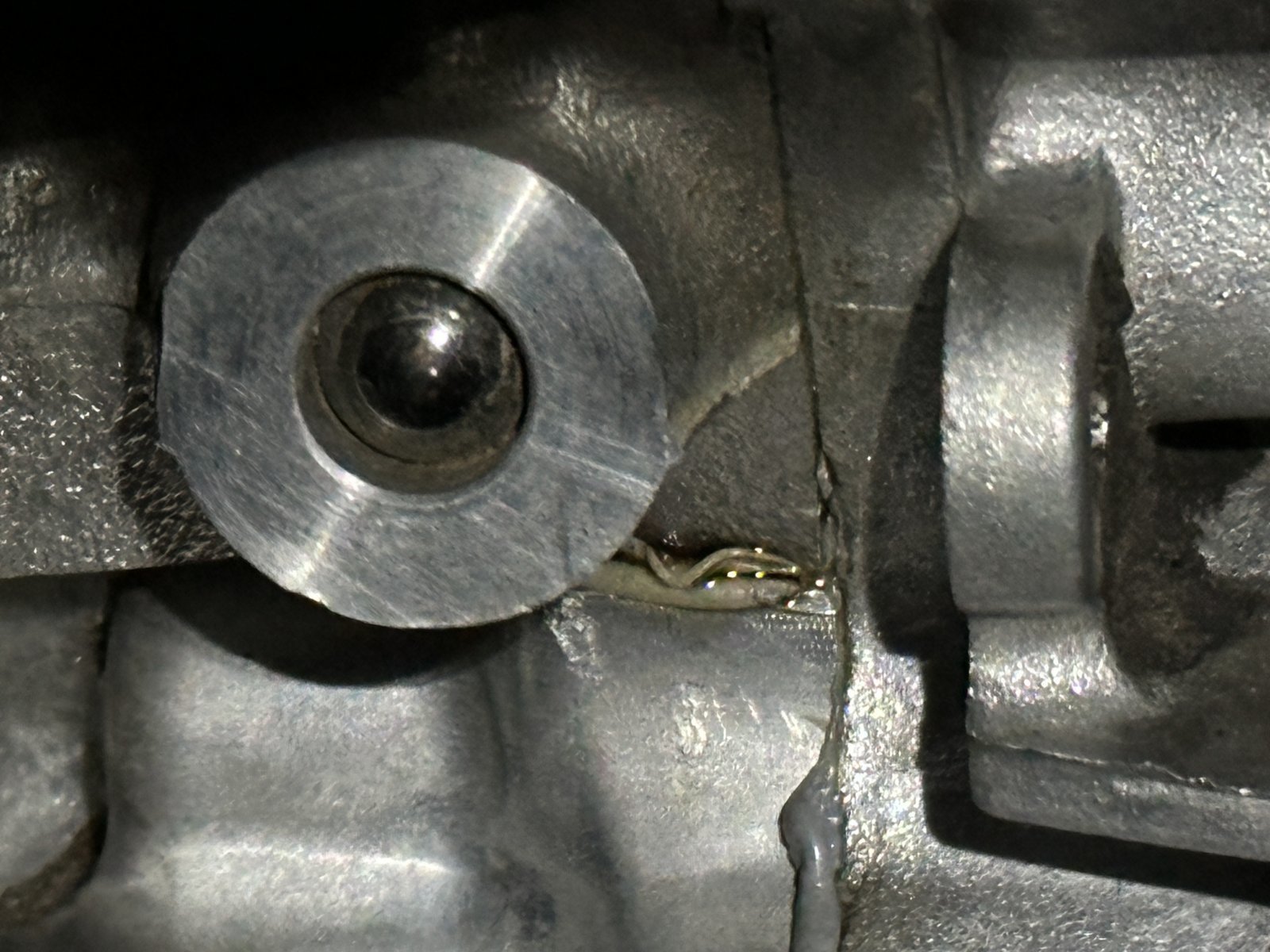

    Just providing an update on this thread.
    Took some time off for spring break this week and moved the power steering pump and cleaned the area of the leak on the timing cover (also changed all my drivetrain fluids).
    I put permatex right stuff on the timing cover seam and it looked good for a couple days, but I noticed some small oil droplets again yesterday unfortunately. I think it slowed the leak down, but doesn’t seem to have stopped it. I guess I’ll watch it for a couple months again and maybe give it another shot. Perhaps I didn’t get a good seal the first time.
    No oil loss seen in the dipstick over the 5 months since I have had the truck, so I know it’s not harming the truck, it just annoying.
    I got some good pics of the leak area before and after cleaning, so figured I’d share.

    Great photos, you really see the 3 mating points in the one photo. Block, head and timing cover.
    Yeah, very annoying but not lethal.

    The pump is only held on by two bolts that pass through a mounting bracket attached to the timing cover. The bottom bolt just screws back into the power steering pump. The top bolt is compression fit with a little sleeve that the bolt goes into and pulls the pump tight. If you look at my pictures above, you can see this clearly.
    I removed the passenger side tire and the splash shield in the wheel well. When you go in this way, the area is right in front of your face.
    I used permatex right stuff black on the seam. At first, I thought it didn't work as I saw some oil after the fix. However, I think this may have been some oil that was still on the power steering pump as I am 5 months into the repair now and I haven't seen any more oil seeping out. So it either stopped it, or slowed it down so much it isn't noticeable anymore. Time will tell...
