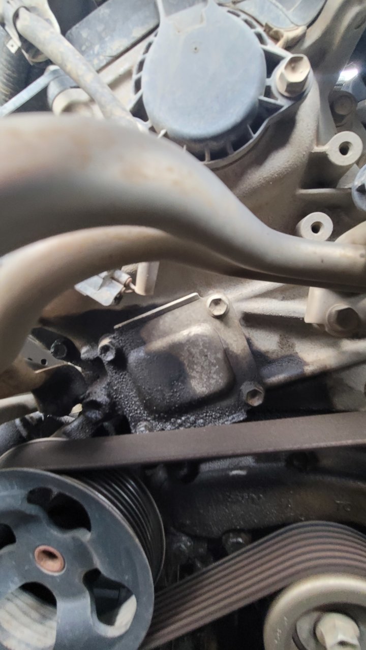

    Hello all, another timing cover post.
    I'm in the process of trying to sell my 2016 Tacoma TRD OR to get something a bit larger for the family, and a prospective buyer got a private inspection who says I've got the dreaded timing cover leak.
    I've never seen a drop of oil beneath the truck or had any issues with it, so I'm curious how serious this "leak" is or if it exists at all.

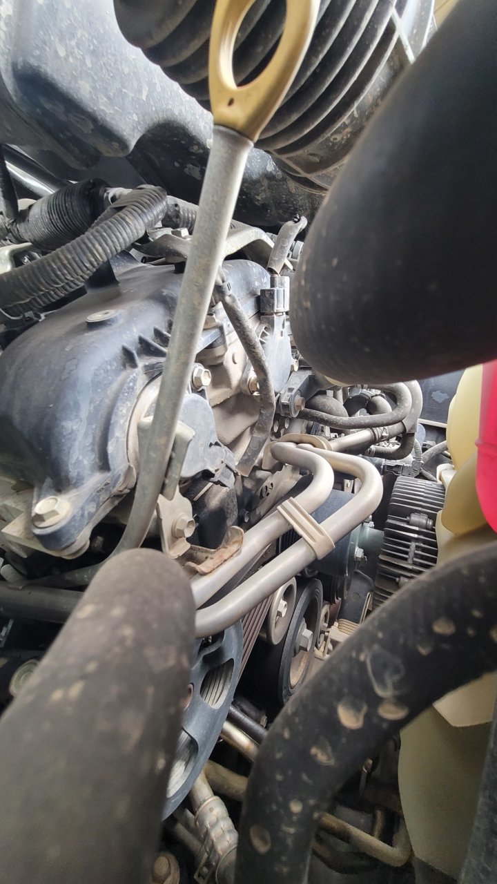

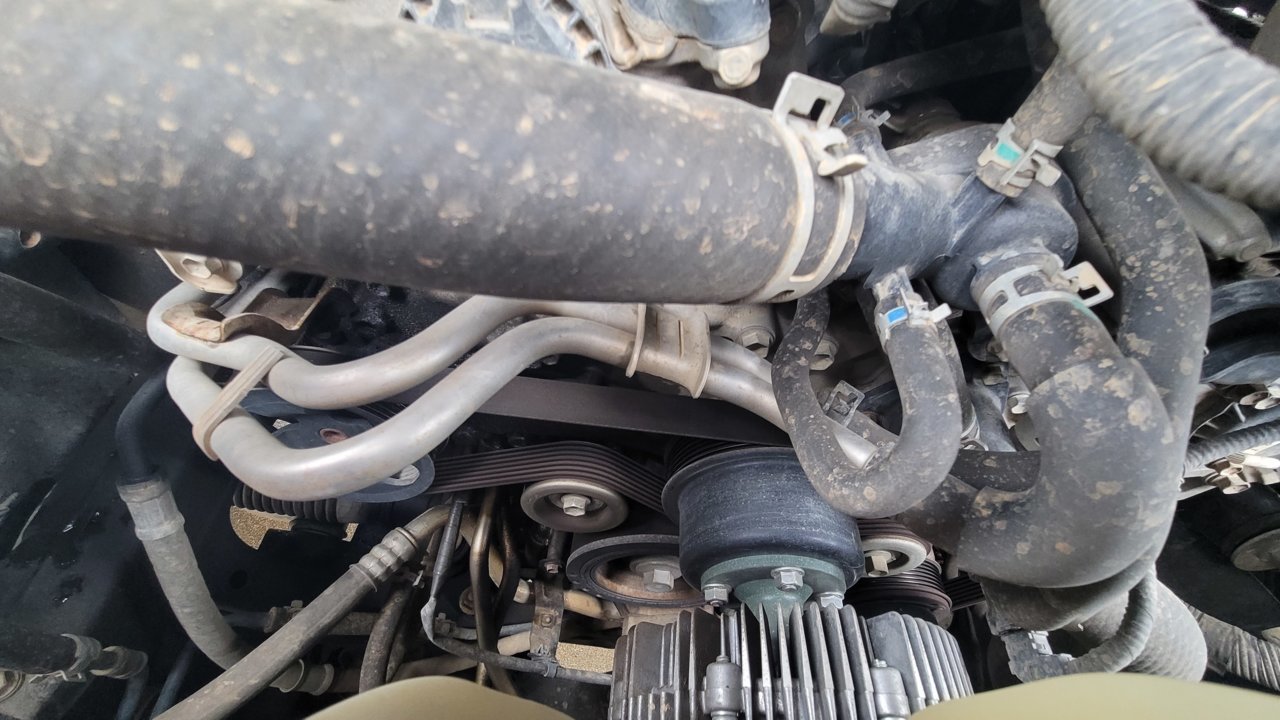

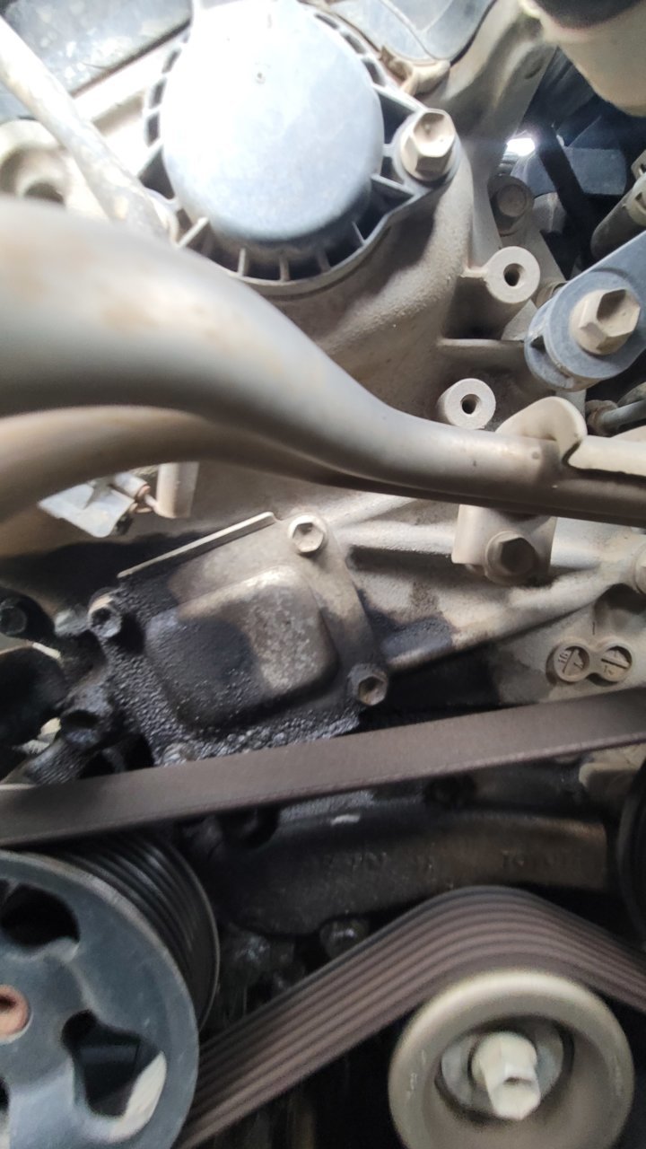

    I've attached some photos here to show what I have found looking on my own now.
    Truck has 100,500 miles on it- painfully close to warranty...don't want to think about it.
    Let me know what you think from the photos and if this is an issue or more attempt at price negotiation. I realize now I may be attached to the truck more than I thought; almost took it personally when someone said there was something wrong with it!
    Thanks

    This is serious; the repair is a large one, I believe to get to it, the engine needs pulled and reinstalled. Potential buyers probably don’t even want it at this point. I think the going rate to properly fix is in the $3,500-4,500 range

    Yeah, I'm aware of the horror stories and potential pain involved in all this.
    I guess I'm really just wondering that if the leak never reaches enough to drip to the ground or really cause much of a mess inside the bay, how much of an issue is it really? No measurable loss of oil is there through changes / dipstick checks. Maybe I'm being too relaxed on this, but it seems like something I can live with driving until it actually becomes a problem? Could be short sighted of me I suppose.

    If you don't have drops or measurable loss it's not a pressing leak to fix. This is basically your notice to save up for it. Thats not a pressurized oil feed area so it's not gonna just explode or anything. Obviously the best thing is to fix it but unless you have to constantly top off the oil it's not at the stage of pressing. Just nucance.

    First, degrease the area and clean it really well. With Toyota there is a difference between "weeping" and "leaking" ie rear diff carrier.

    While this is a great idea if looking for the source, doing so will lead to oil dripping on garage floor as it will no longer be absorbed by the built up dirt. If it was mine , I’d leave it as it is

    It will leak eventually. I had the same issue but resolved it under warranty. It is a known problem w/ this motor. Does it have to be fixed immediately given it is no longer under warranty, probably not - it is just sweating and not leaking yet. It is a huge job. The dealership had my trucks for days but the master tech was able to do it w/o having to pull the motor.

    clean all the dried up oil off and then watch it over time. worst case, clean it up and trade it in.
