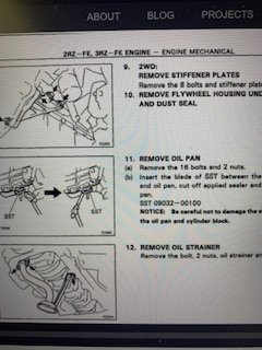

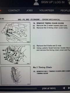

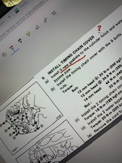

    Clock Volt meter/LSPV Delete/Hyundai 16’s/FP gauge/after 9months of wrenching ZERO oil leaks
    I got 2 questions
    -To take a leaking T chain cover off do you need to take off oil pan?
    Manual steps say so but motor out of truck
    -says 3 gaskets needed
    Any chance someone has prt#’s?
    2.4L 2RZ-LE
    Thanks Steven
  5. Aug 24, 2023 at 6:50 AM
    noodles93
    noodles93 Well-Known Member
    Dec 9, 2021
    #384203
    635
    Charleston, SC
    1999 Tacoma Prerunner 2.7
    Oil pan comes off no way around it, the pickup screen is bolted to the cover. Get a new gasket for that... I've got a list of parts when I did my cover here. I'd also replace things like water pump and every gasket that comes out a new goes in. One area I made a big mistake was not replacing the crankshaft pulley it looked *ok* but has a wobble now so it all has to come off again. Also the "starter bump" method while sketchy, worked great. I've got a video of when I did mine if it would help.

    And you dont have to take the whole pan off.....
    just have to break the seal where it attaches to bottom of the time cover....
    two bolts there and two bolts under the valve cover...
    take a box .....draw a pic of the front of the engine and stab those bolts exactly where they go back...
