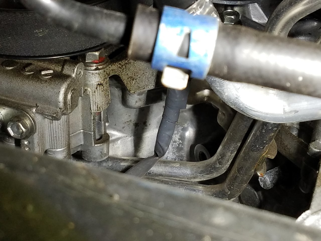

    20180805_153428.jpg When I changed my oil the other day I noticed my power steering pump was wet, wiped it all off and the PS Fluid Reservoir was full, guess I am going to have to double check for a timing cover leak.

    Second gen had the same timing cover oil leak problem where it meets the head and block by the power steering pump. It was a casting defect that was quietly fixed by Toyota about half way through the generation.
    And yes, with access to an engine hoist it's actually faster pulling the whole motor to fix that.
    And whoever said you need to drop ththe front diff and pull steering rack for this job: NOPE! You're doing it all wrong

    Yeah no shit haha, not hard just time consuming. And this way I know it's done properly and the repair didn't cause other damage that's more likely when techs are pressed for time and rush the job.
    Going by your pics I'm betting it's the timing cover leak. You can use a dye to pinpoint it but power steering fluid should be red, more like ATF than motor oil

    At least you know yours was done correctly if you were able to take your time with it. I went outside to have a better look and I can see the corner of the cover is wet right behind the fan belt, definitely a timing cover leak.
