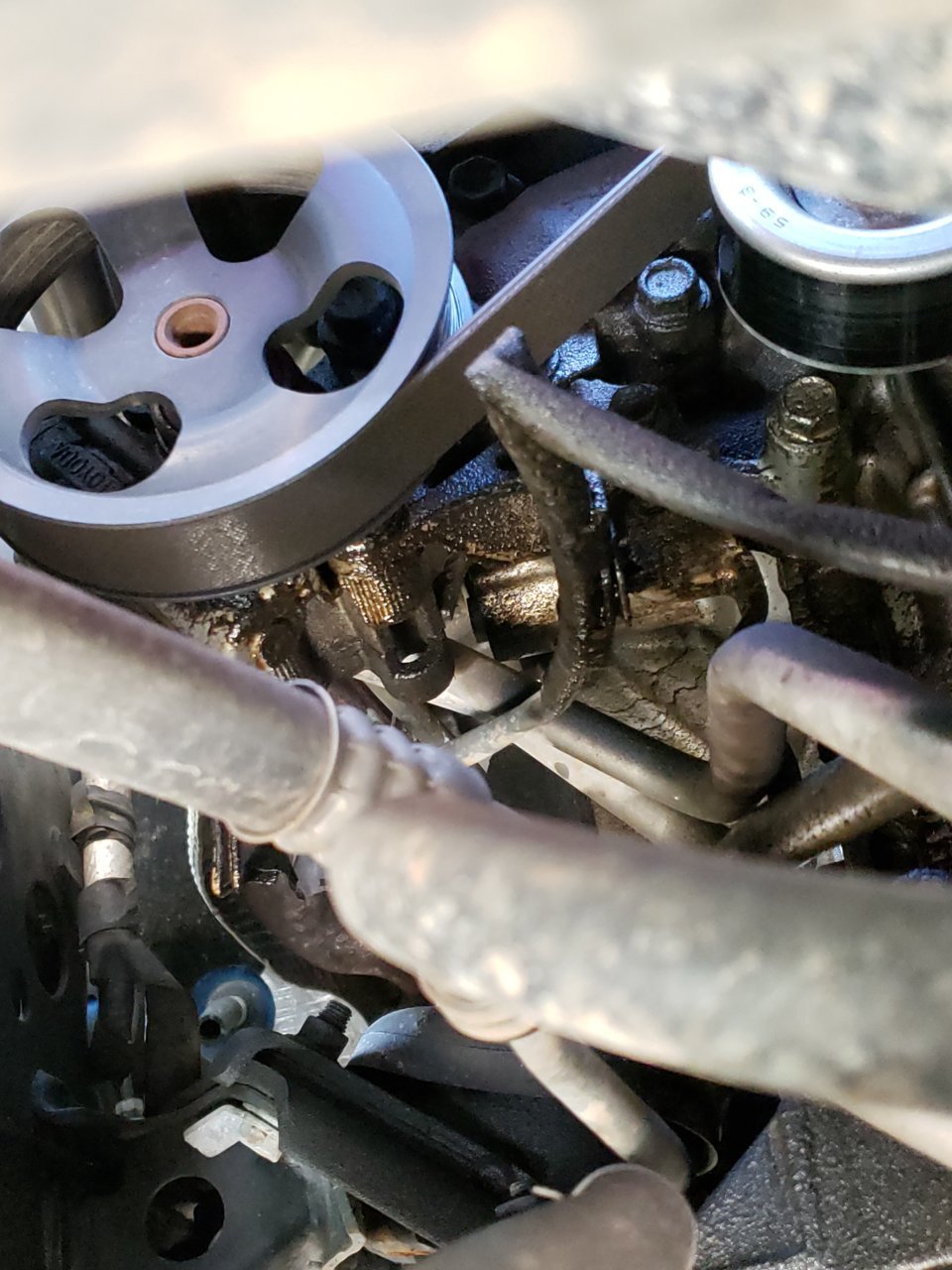

    Had this happen to me on my 2016....
    Luckily I had to take my RCI skid off since the access cover bolt decided to seize on me during my oil change. While under the truck I look up to this sight
    Called the dealership and schedule an appointment to have it checked out the next day. Drop it off at 8 am and get a call around 2pm the same day saying the engine is out and it should be done in 3-4 days.
    My truck is currently at 49,000 miles and has a build date of Jan 2016

    Under my truck as I type this changing the oil. Just noticed the leak. My 3 year 36k mile warranty expired in January. Truck has 31K on it. Would that be covered by the 60k powertrain warranty?
  10. Apr 16, 2020 at 11:12 AM
    #50
    Kleach18
    Kleach18 Well-Known Member
    Jun 30, 2018
    #257965
    165
    2016 TRD Offroad
    They covered my replacement under the 5year 60k warranty

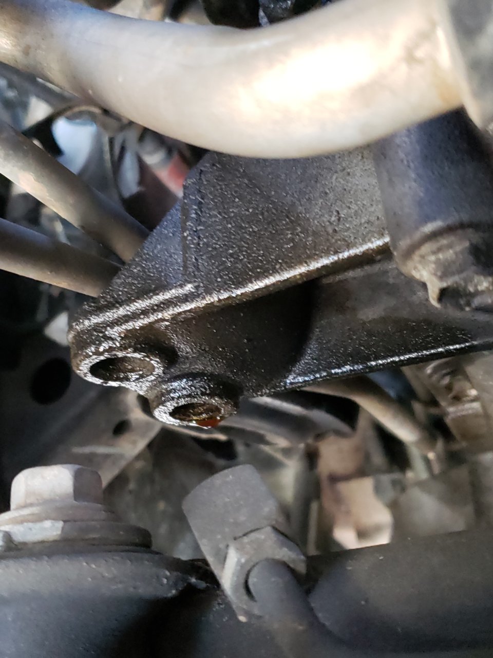

    Getting mine fixed. Under power train warranty (mine expires October 30, 2020). Glad I checked it before the warranty expired. It’s a $4k job. Told me one week. Got a 2020 Cement SR5 loaner with 300 miles on it. This thing runs very nice. 6264A8C1-8C04-4167-B2C6-1756CDD1231C.jpg
    Heres a pic of my oil leak. This is after I wiped it clean a month ago, it came back , but didn’t drip on the ground. 3E3F81C0-F54B-4BB0-9F89-9CAE90FBE472.jpg
