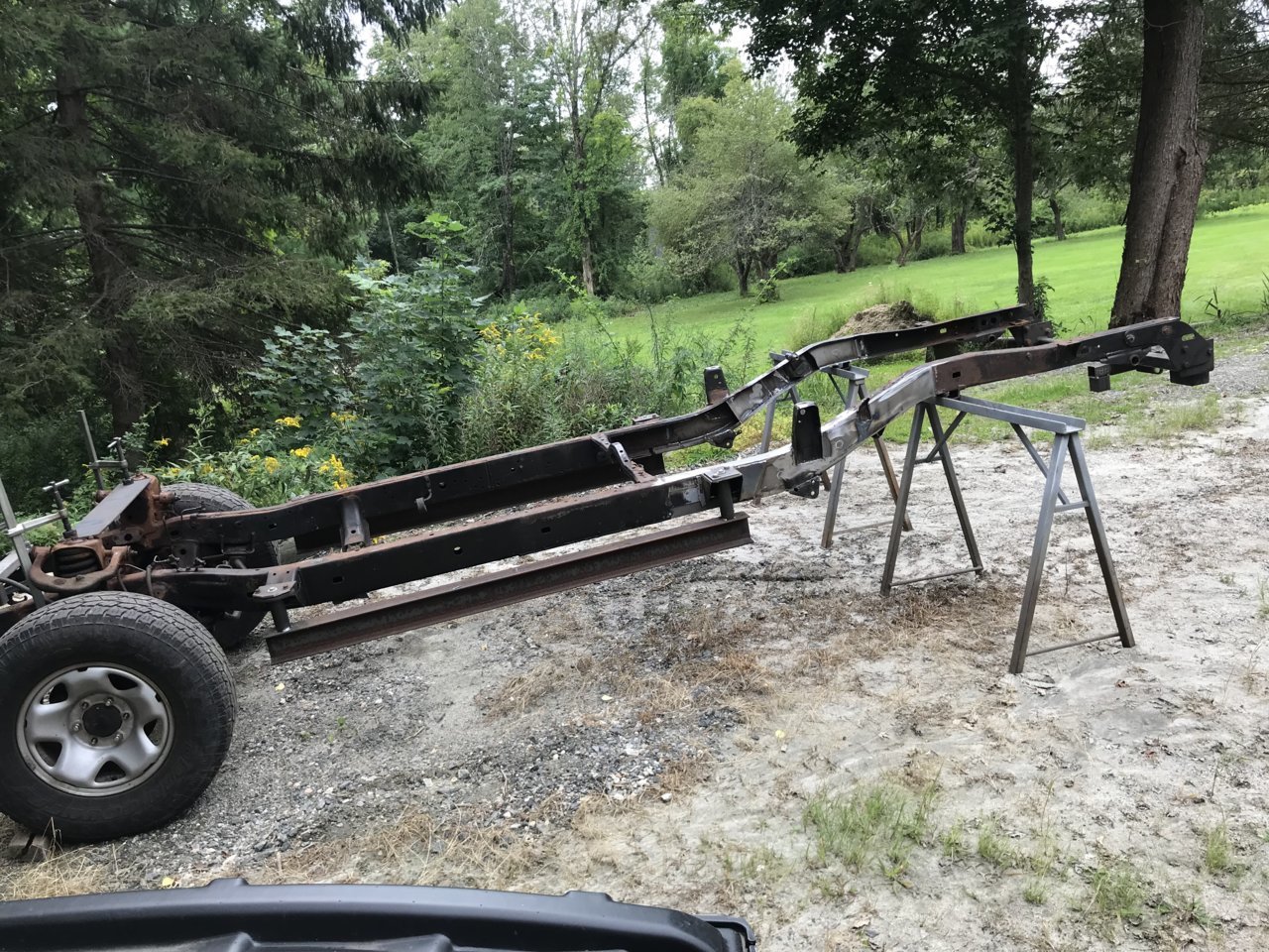

    @woad4, that was very kind of you to take the time to put that list together for me. By the sounds of it, I think that if we had out trucks next to each other in a garage we'd have "The Shop for Wayward Toyota's". Thank you for the offer of the manual pages but I did buy the factory repair and maintenance manuals on ebay. And I'm damn glad I did. I'm still concentrating on getting the frame back together. I can't bring myself to go over the rust areas. I have to remove and replace. I'll see if I can get a pic posted. So while this is going on I'm thinking of the weeks to come and what I'll need. And not being real Toyota Savvy I spend my time running around here. (Nice place to be). I'm sure I'll be in touch again soon. Thank you for being such a good sport.

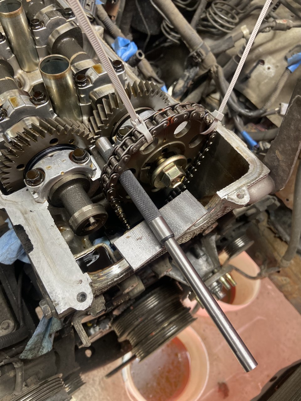

    4DDB0A52-008D-4FB2-AB7B-8ACE8D5C11B5.jpg A58A7F89-36FB-4BEE-9AE0-55B4E2B5217A.jpg Have you started yet buddy?
