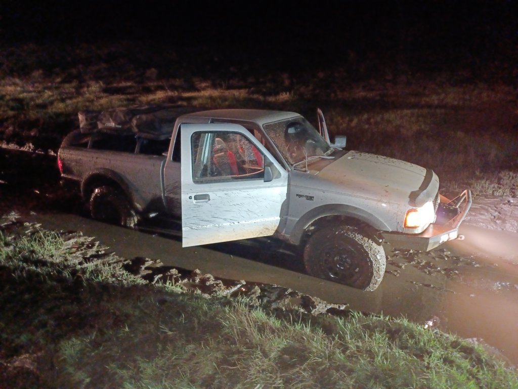

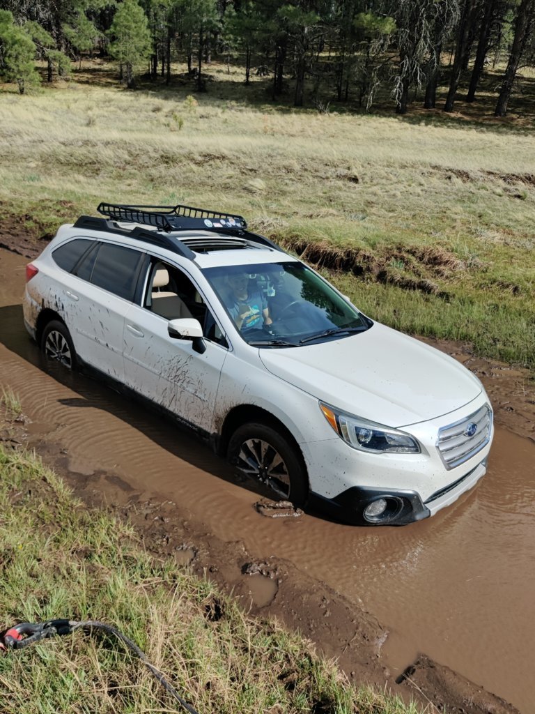

    Had a great bachelor party this weekend, even though I don't have my truck. We did a bunch of wheeling and went to the overland expo. Got my buddy's new subaru outback stuck, as well as my other friend's ranger that was stuck in 2wd (yes, in the same mud pit). Thankfully we had a bronco with a winch!
