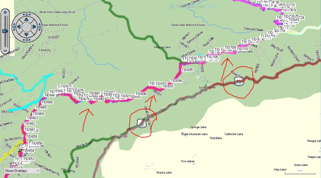

    When do you want to try one of my favorite routes in ID? Right north of hwy 12 and it won't be a graded dirt road.
    [/QUOTE]
    Is that road Lolo Motor Way? I'm in that part of ID occasionally and the road looks interesting.

    The route you questioned does incorporate some of the "Lolo". This is just section #3.

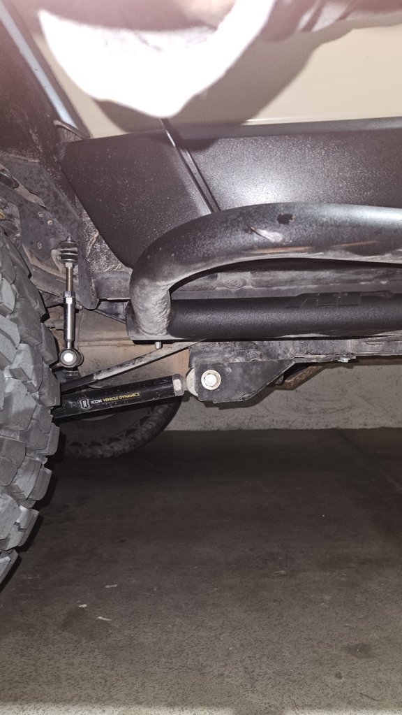

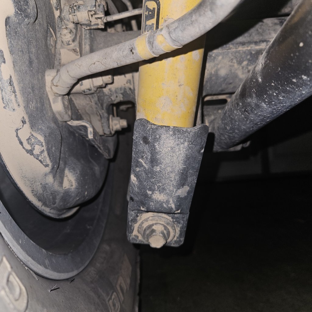

    Exactly this and also a bolt on skid for the shock knuckle (which is the lowest point of that rear suspension). I took a quick look and it does look exactly like the FJ Cruiser rear suspension. That lower shock knuckle was where I had a lot of bent and mashed up brackets since it sits in front without any protection. And that was on green trails with my FJ.

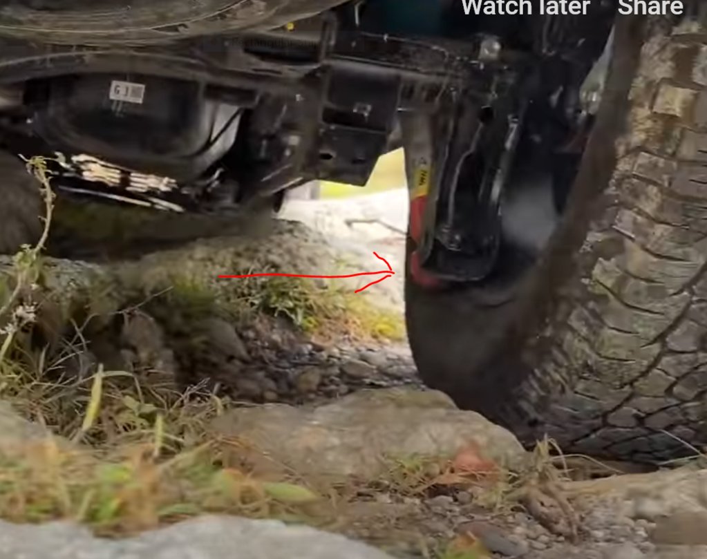

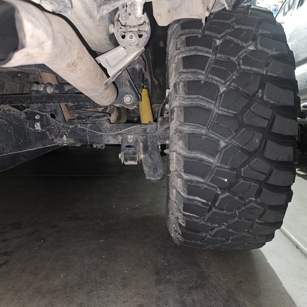

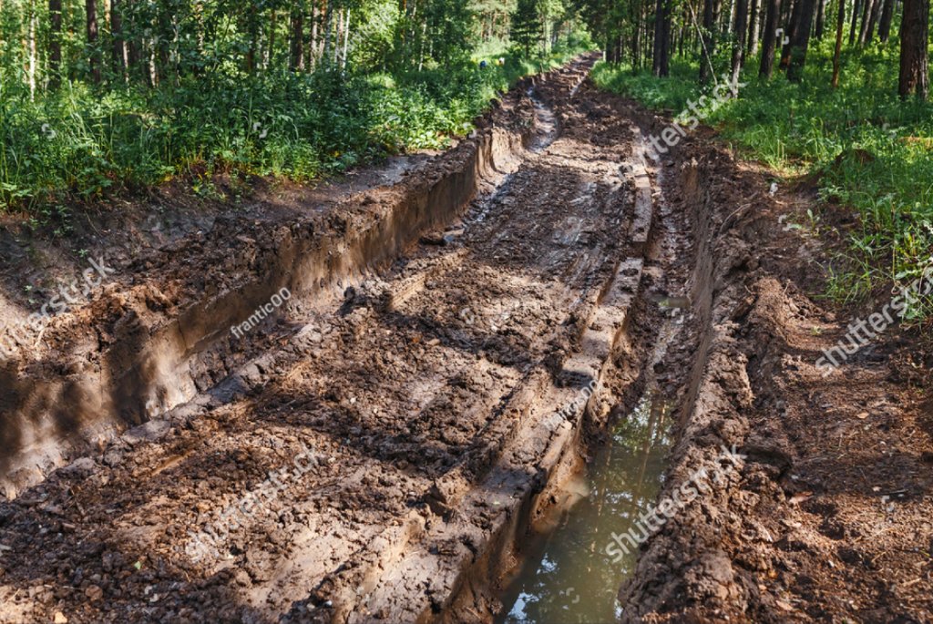

    Further on the Gen 4 rear suspension issues that were not discussed by Tinkerer. The lower rear shock and shock mount is extremely exposed/vulnerable and will drag in deep dried out tire ruts or in deep soft muddy terrain and potentially impede forward movement.
    Potential also exists to damage the rear shock and/or the shock mount. Bascially anything deeper than tire sidewall height. One boulder under the mud impacted at speed while trying to make it thru some muddy tire ruts and you can kiss that rear shock good bye.
    this type of offroad environment... nothing like where Tinkerer did his testing

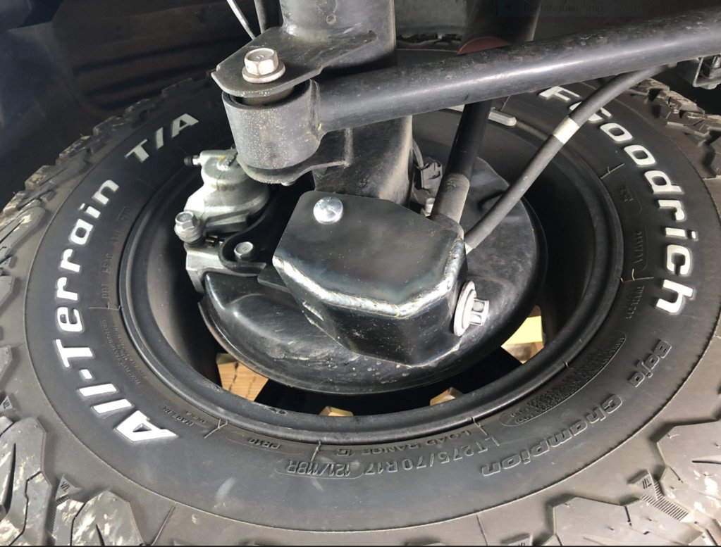

    a form of protection already exists for the 4 runner and includes rotor protection if changing wheel offsets with more exposure

    Big Yes, the more offset tires in the rear, the more exposed the lower shock mounts are. A shock front skid only helps some when it is a straight impact. This is an FJ with -31 rears.
