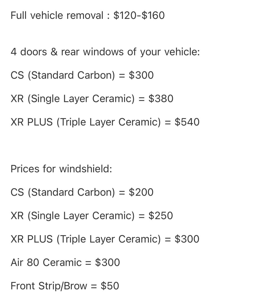

    I live in South Carolina and do a lot of work sitting in my truck on my computer with the car idling throughout the day a couple days a week. Tomorrow I am going to get the front windshield tinted with Xpel XR Plus. I already have 20% tint on the front side windows that was done by a reputable tint shop through the dealership when new(I don’t know, but I’m guessing that it is a low heat rejection tint). I’ve done quite a bit of research on here, and let me know if I’m wrong, but Xpel seems to be a good choice, but I have not found a good answer as far as:
    1. Will doing the windshield be for naught if I don’t do the rest of the vehicle in ceramic?
    2. How much heat rejection if any am I likely getting from the other windows and how much does it matter compared to the front windshield as far as heat in the vehicle?
    This is the cost:

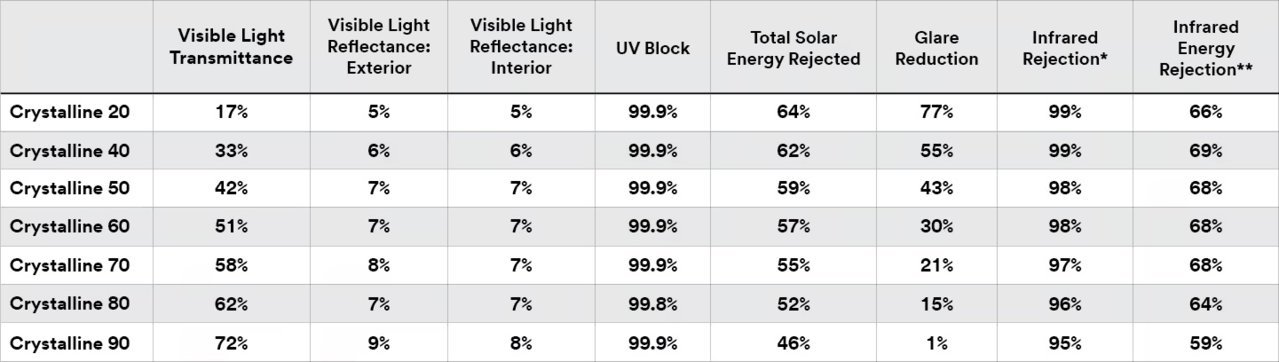

    The majority of UV and heat rejection from ceramic tint comes from the fact that it's a ceramic tint, not how dark it is. You gain 46% solar rejection with a factory darkness and if you go all the way down to 20% VLT you only go up to 64% solar rejection.
    Anyone who says they wouldn't tint a windshield with a ceramic tint doesn't understand the latest technology. Not tinting is insane if you live anywhere with heat, IMO. I have Crystalline 90 on all four sides and it looks completely factory.
    With a 72% VLT ceramic tint -- factory is 70% -- you're reducing visibility (glare reduction column) by 1% for half as much heat and no more getting sunburnt. That's a totally worthwhile tradeoff.
